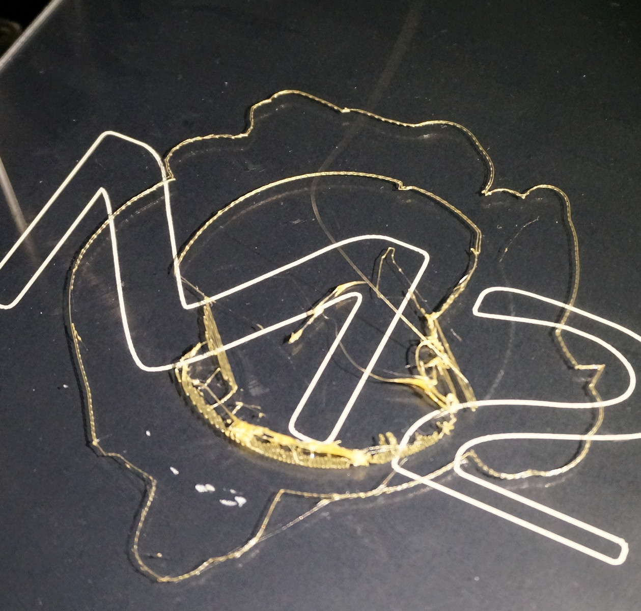

OK .. I tried running filament through at 244 and then tried another print at 215. This is the result. Any ideas?

It looks like you just aren't close enough to the glass.
What is this? And what slicer did you use? S3D or Slic3r or something else?
To rule out a slicing artifact, try one of the prints on the SD card that came with your printer. You don't need to print the whole thing, just the first layer or two to make sure it adheres. Try the bigfoot head maybe.
If that looks good, and you are using slicer, try setting the extruder offset to -0.2. Last tab in the settings. My guess is that slic3r is assuming you are dead on the bed, while you've adjusted to be 0.2mm above the bed. So when slic3r lifts a little more to make room for the first layer, it's now too far.

I agree you are too far from the bed but you also have something else going on there. I dont like the little
Lines and dashes its leaving. Might be a problem or it might nit and just be a result if being too far away. What kind of filament is that. Looks like bronzefill or some special metallic filament. These can tend to print very strange and require different setting and also can clog a nozzle very easily.

Ok .. apparently it is something messed up in the process for this piece I'm trying to build. I went back with everything exactly the same and ran the Bigfoot demo .. and it ran perfectly. I'm using S3D, so now I need to go in and see what has changed between Bigfoot and this Koi I'm trying to print. Thank you everyone for your help
