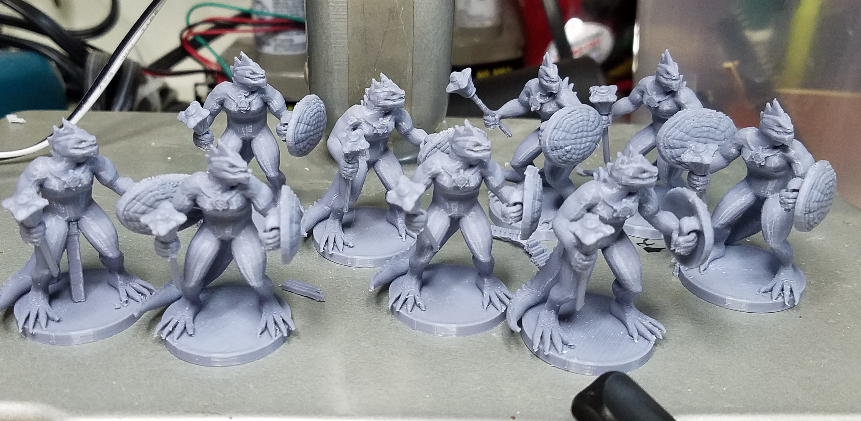

I have only been printing minitures (see attched)
