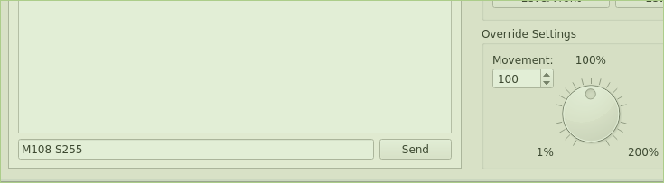

Okay, this test will tell you if the fans are wired correctly and working. Go to S3D, open the Machine Control Panel and connect to the printer. Go to the Communication tab and enter the following commands:
Sending G-code fan commands
M106 S255 (click Send)
The 50mm bed cooling fan should run full speed.
M106 S0
The 50mm bed cooling fan should stop.
M108 S255
The 40mm extruder cooling fan should run full speed. This command also sets the speed of the electronics case fan. (The two are wired in series in the 24-volt --- currently shipping --- M2.)
M108 S0
The 40mm fans should stop.
If these all work OK, the wiring is fine and the fans are fine, and the issue is with the S3D start code or other settings.
If the electronics case fan and extruder cooling fan BOTH follow the M106 command (not the M108), then the wiring at the extruder is OK, but the connectors at the RAMBo in the FAN 0 and FAN 1 connectors should be swapped.
If the electronics case fan and the BED COOLING FAN work together, the fan connections AT THE EXTRUDER are swapped.
If one or the other fan doesn't work at all, check the POLARITY of the fan connections. Red wire from fan should go to "+" side of connector at RAMBo. See the page http://makergear.wikidot.com/m2-electronics for details on connector usage and connector polarity.

My fan quit working on the extruder so I took the one from the electronics box to get by. When i plugged into fan 1 it wouldnt turn on so i figured i got the wires switched and plugged it into fan 0. So thats where it all started thats why i could only get the fan to turn on through viki lcd screen. The reason I got the wires switched in the first place is because when you "steal" the fan from the electronics box the extruder fan does not get power. They are wired together without the electronics fan plugged in it will not complete the circuit to turn on the extruder fan. I didnt realize this until dale reed said they were wired in series! Thank you!!!
