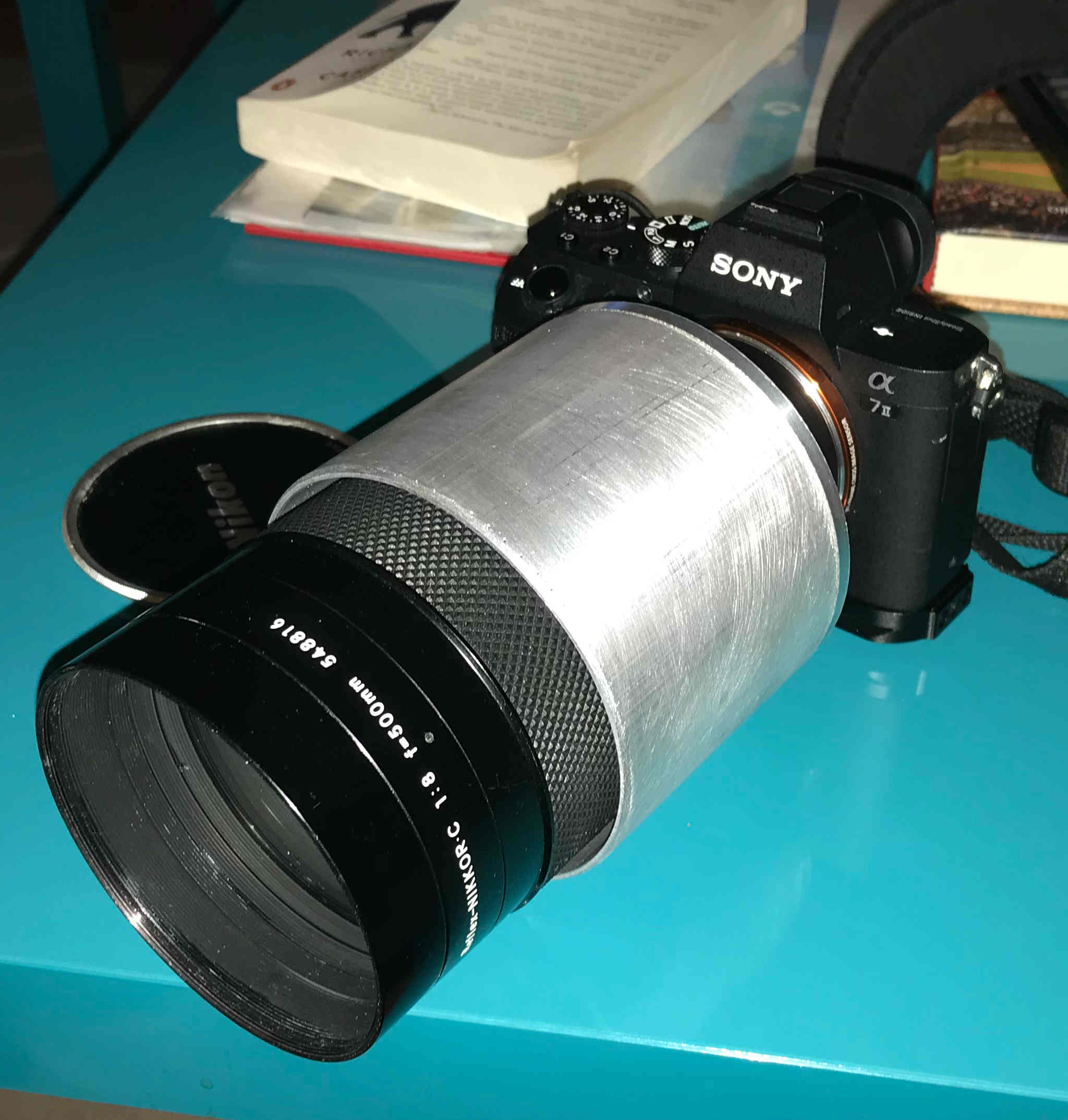

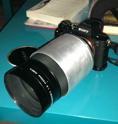

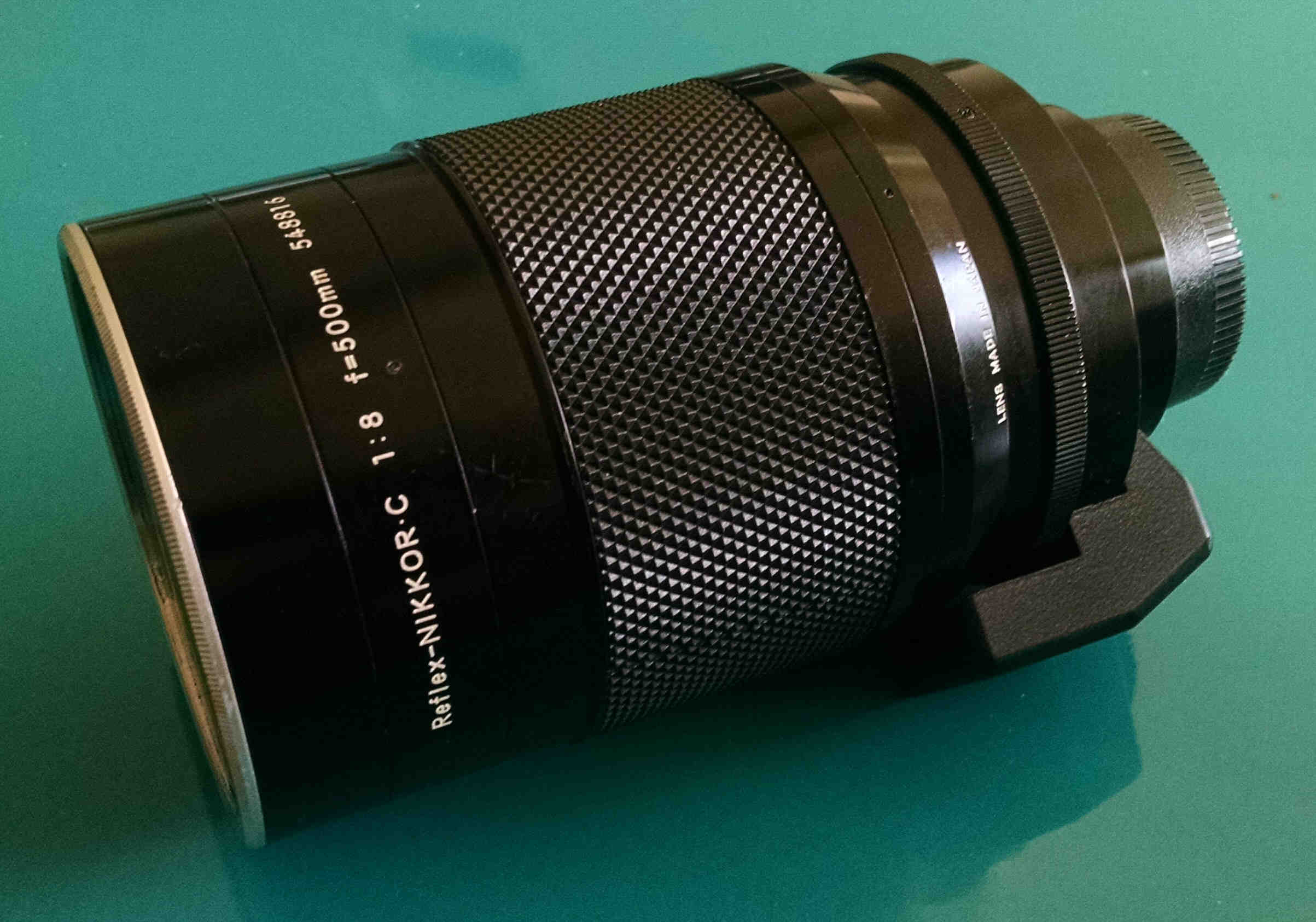

Nikon could have thought more about the design of their 500MM F8 Catadioptric lens. As it is, it is impossible to hand-hold without disturbing the focus which on a lens of that focal length is very twitchy.

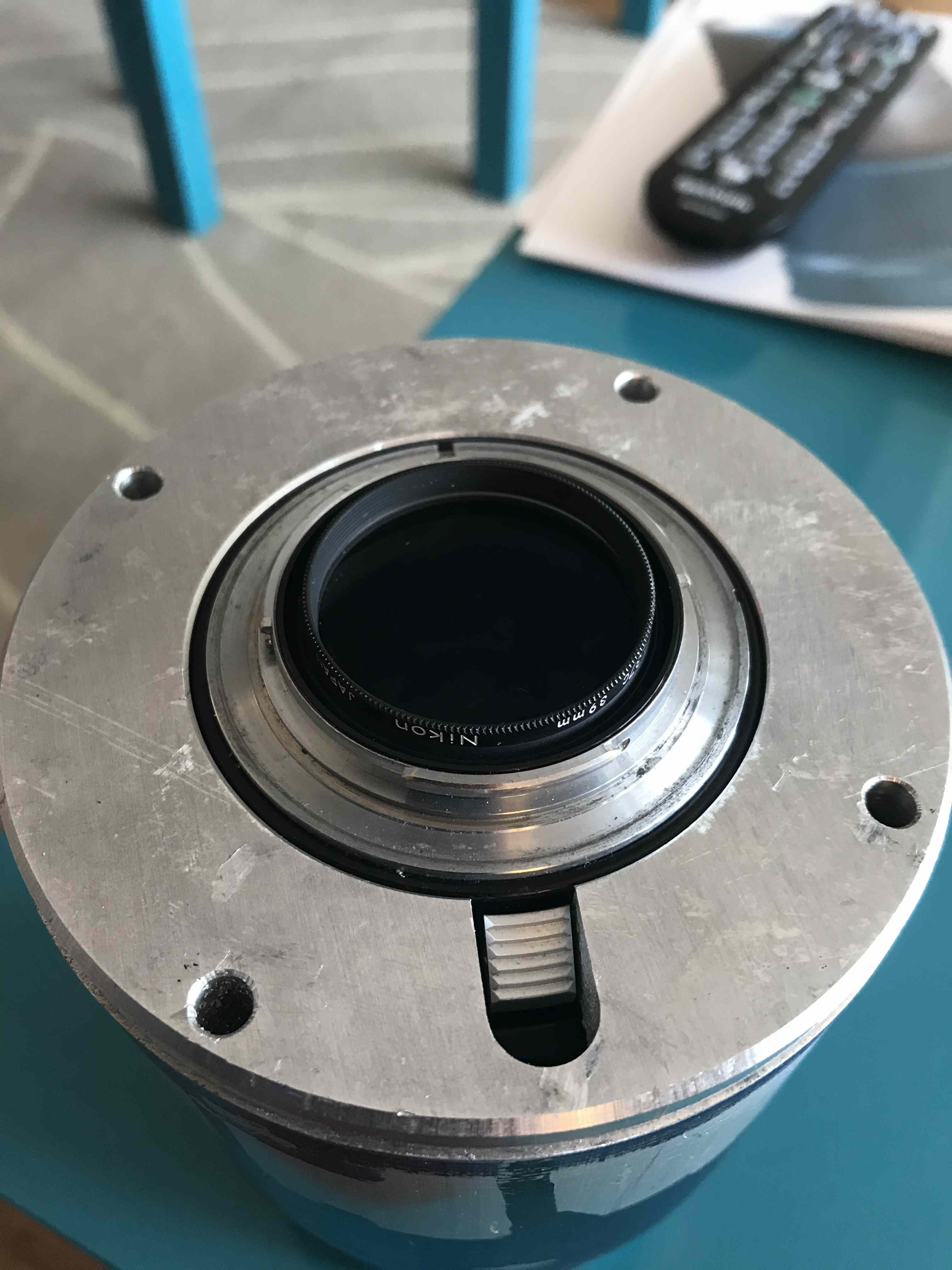

So I made this aluminum sleeve for mine and it works exactly as I had hoped. I support the lens and camera right hand on camera left hand under the aluminum tube and focus with my left hand finger tips. I take a lot of shots and use a Sony A-7II which has motion suppression.
I had planned to paint the aluminum tube black using DuraCoat applied with my airbrush. This paint is very popular in the firearms community which made me think it would be plenty good for this application.
Then it occurred to me that I could print a black PETG sleeve using vase mode. So finally, here is the question. Do you think I can find a diameter to print the sleeve that will let me shrink it onto the tube? My plan would be to make it a bit smaller than the tube, then heat it up in hot water and hope that I can get it over the tube and that when it cools it will shrink for good fit.

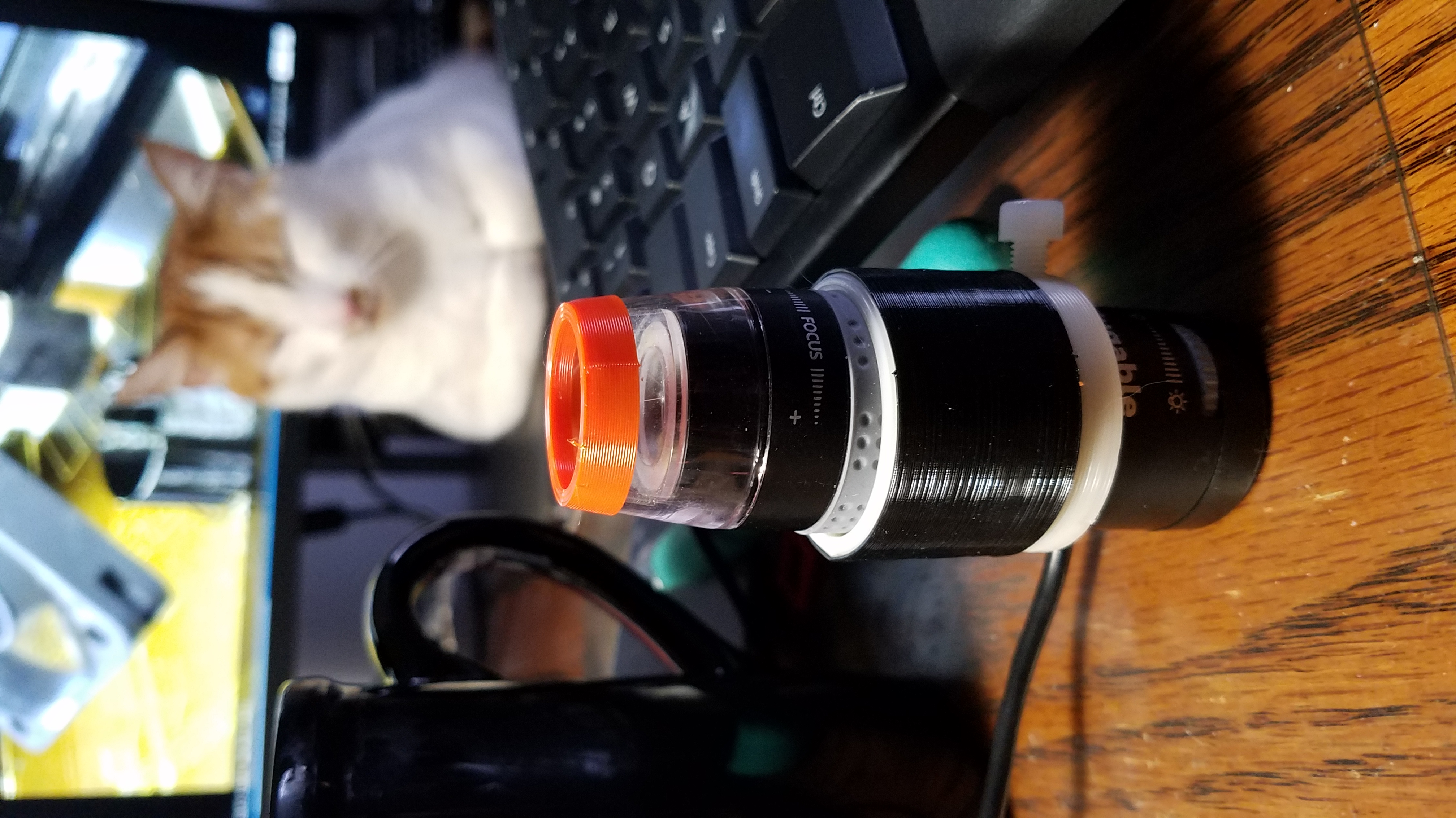

I think a much better option would be to print black Nijaflex in spiral mode and work it over the tube. I did the exact same thing to make an ABS tube less slipprey when working out a way to cover the focus ring of a usb microsocpe. I used the .35 nozzle with a solid modle and vase mode . I also have a gravity feed bearing spool holder and the extruder housing from thingyvers that was tightned up for the nijaflex.

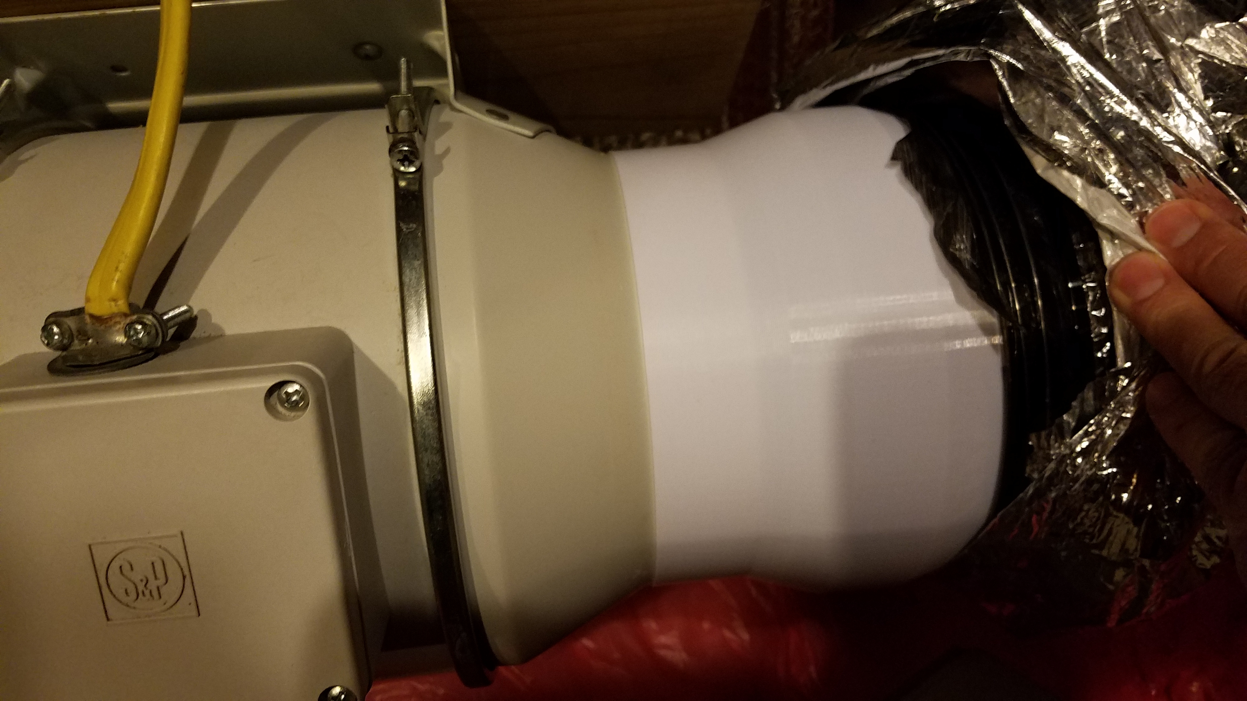

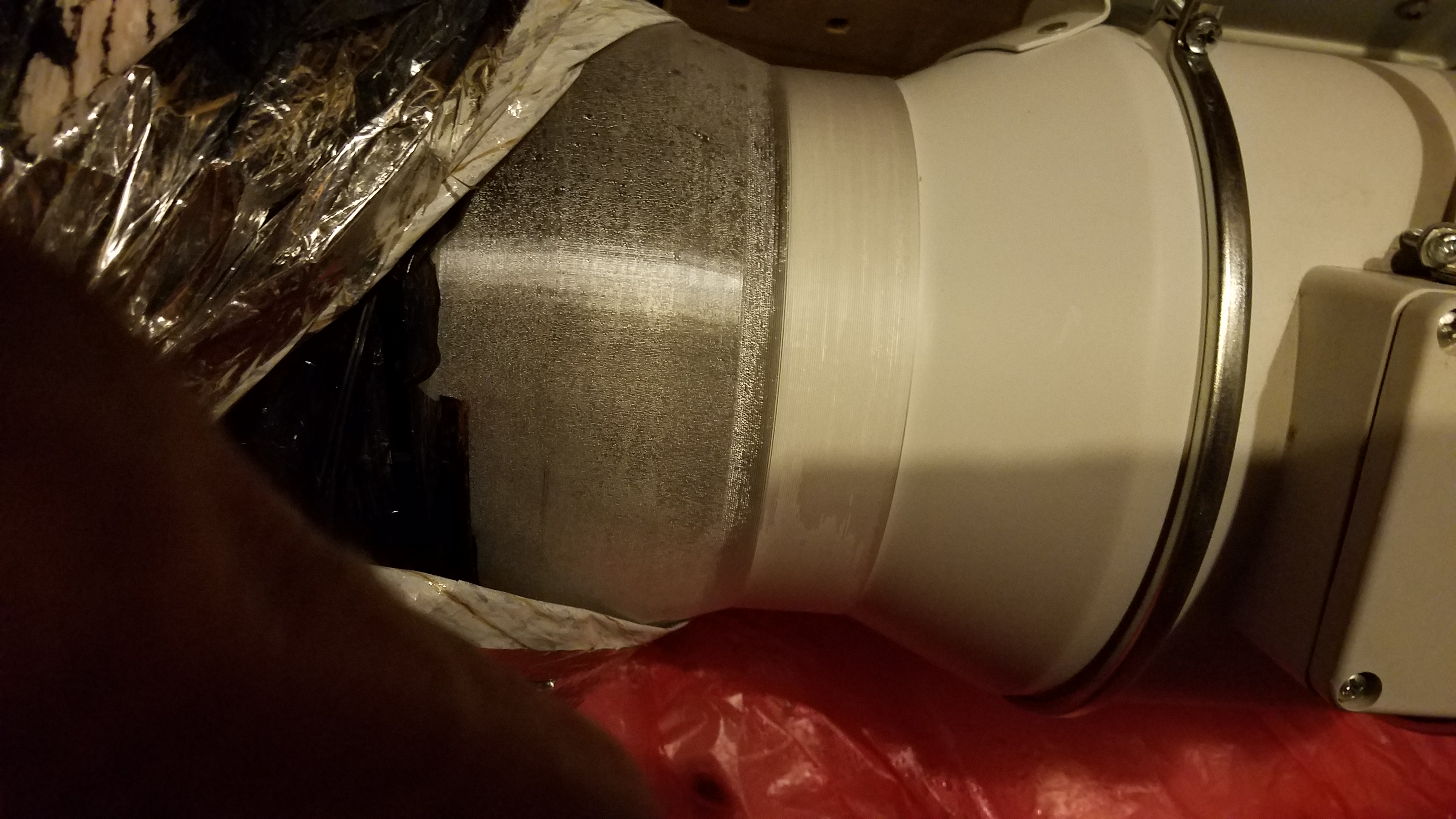

PETG is not going to shrink, or expand, it is very heat stable in my experience. With a lot of tial and error you can get a good interferance fit, I made adapters for a 6" exhaust fan using PETG and spiral mode, no clamp needed. The purpose of the adapter is to catch condensate as the fan is in a non conditioned attic.
