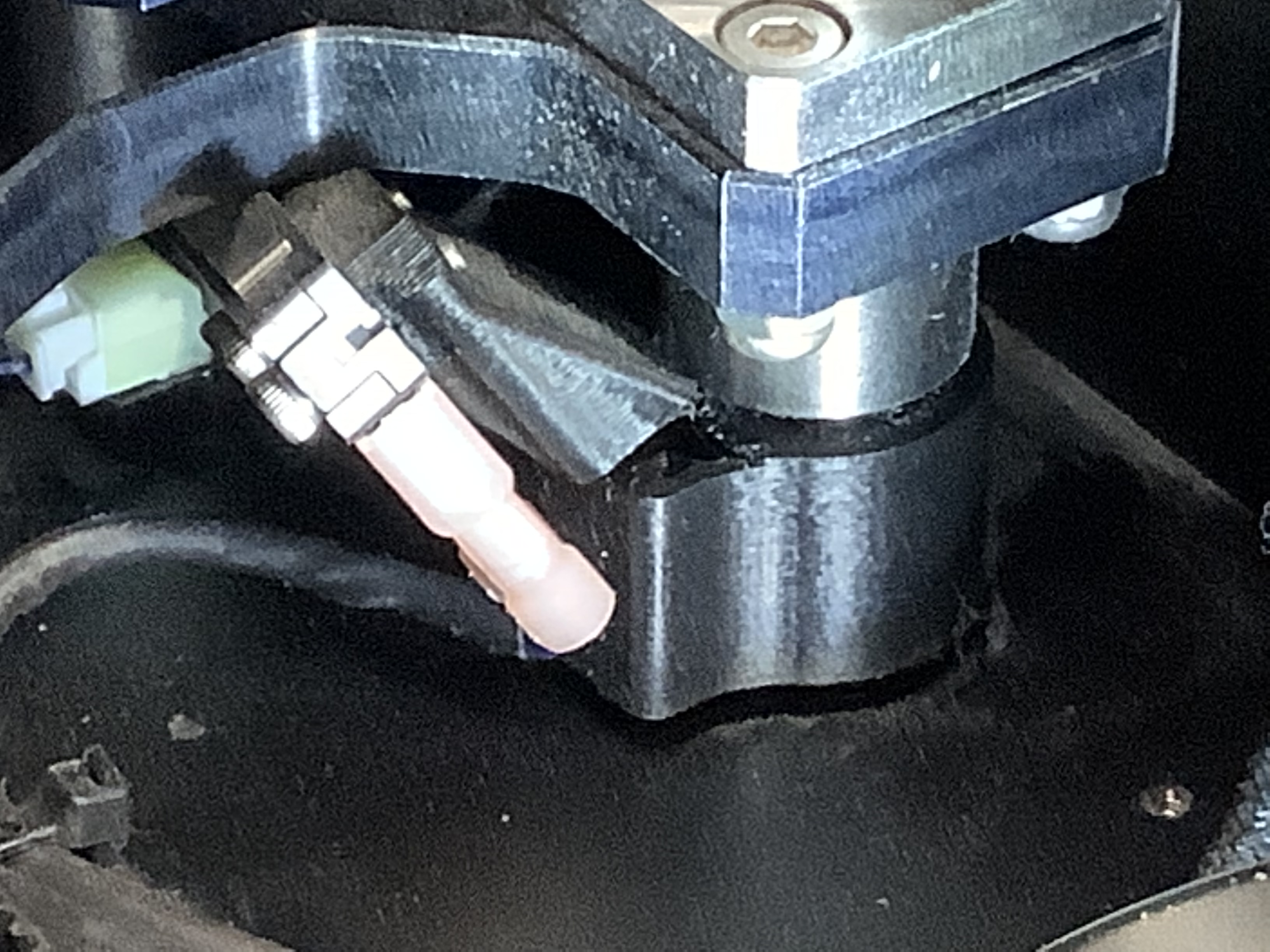

After noticing that my bed height was significantly lower a day after I leveled the bed, I saw that when the bed’s Z axis was homed a plastic spacer below the bed started hitting the top of the controller housing.
I then noticed that the plastic mounting bracket that the Z-limit switch is supported by is broken and the switch is now not securely attached any longer.
How do I fix this?

Glue it and print a replacement. Check here: https://github.com/MakerGear/M2/blob/ma ... racket.STL Not sure which version you have but this looks similar.

The bracket has been glued back together and switch is reinstalled.

There's something odd going on. I bought my M2E is July of 2017. The 3D file for the printed bracket on GitHub is from a little over a year earlier. I finally got around to taking a look at my printer. It has a simple machined metal bracket holding the Z-axis limit switch, bolted to the top of the motor. I suspect they had problems with the 3D printed bracket breaking, and decided to go with something sturdier at some point before mine shipped.
