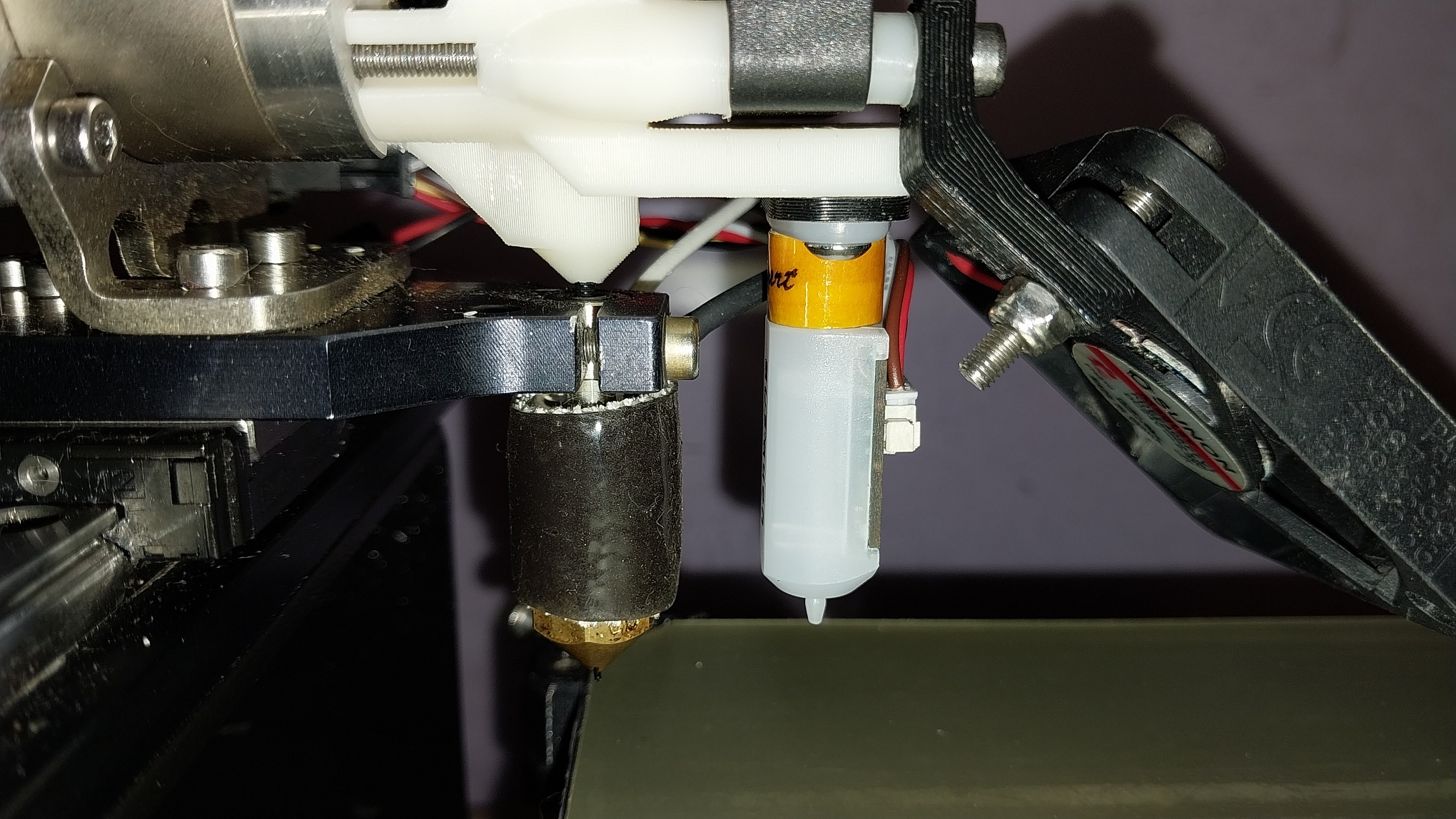

BLT Extruder Redo. This is the one from Thingi that was tightened up to allow for better TPU printing. I added a front mount for the BLtouch sensor and have it working with Reprap on Duet 2 board.
