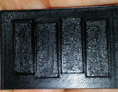

Hi All,
I'm having lots of fun with my new M2, it's quite an upgrade from my printerbot simple. I'm really close to getting it completely dialed in, my prints look great and are accurate. There is a weird quirk though that I can't seem to figure out after lots of tinkering with S3D settings and searching this forum and others. When printing medallion type prints (large, flat type objects like badges, logos, etc.) the top layer(s) look really rough and kind of burnt like. I'm using the supplied black PLA at 215c and have S3D set to high quality. It's not due to the head dragging, because when I printed the example below that has a flat platform and then objects on top of it, the base platform's top layer is nice and smooth but the final layers don't look nearly as clean. Your thoughts and tips are GREATLY appreciated.

Hmm well its hard to tell really but it does look like your underextruding a bit. Even around the outside where it looks better the lines arent touching so the with of the line being extruded isnt what the slicer is expecting. In the boxes the underextruding is probably causing the infill to be a little broken so the top layers arent bridging it. Measure your filament and make sure the dia is set right in the slicer then turn up the multiplier a little bit. For proper extrusion the edges of each line should just touch.

But if it's underextruding, shouldn't that apply to all layers? Only the top layer looks bad; the surface halfway down looks great.
215C is a bit high for PLA; I usually do about 200 to 205C.
Otherwise, the top layers can be affected by speed. . . the slicer will slow down the printing to force a minimum amount of time spent on each layer. That combined with too high a temperature might cause that effect. Otherwise, check all the conditions that are different between printing the lower (good) surface and the upper (bad) surface. Is the fan speed different? Print speed? How about the number of solid layers printed under the surface (I doubt that makes a difference but I can't tell how thick the piece is)?

i dont know. the surface around the blocks that looks better still looks underextruded to me. none of the top surface lines are touching on the edges. they are close but not quite touching. if the infill gets all broken apart with holes then the top surface will be very hard to get right. broken infill usually comes from underextrusion and as you mentioned tim, too high a temp. in s3d there is a setting "use random infill placement". turn this off. your parts will be stronger and infill will be less likely to break since each strand is supported 100 as its laid down. it likeS to break from trying to print over a mesh. im not saying this is whats happening but it does kinda look that way. if you notice in his print, judging by it sitting on his hand the part that looks good appears to be very thin so there is probably no infill being put there. they are probably a few solid layers then it does the blocks, adds the infill and then everything gets screwy. tim remember he has a new m2 as well so 215 is fairly normal i think with a v3b but i dont print pla either so who knows. i somehow remember 210-220 being about right. so if that were my print my next moves would be this.
1: uncheck use random infill placement
2: reduce temp 5 deg
3: increase # of top layers
4: increase infill density
5: measure filament and check filament dia settings are ok. if its right then bump up the mulitplier 3-4 points. if dia is off leave multiplier alone and correct dia setting
i would run the print at that point and see what happens. to the op, let us know how it works out

Can you post the .factory file? That would help troubleshoot the problem.
The .factory file is what you get from File->Save (or ctrl-s) in S3D. Also, you'll have to put it in a zip file in order to post it on the board.

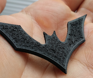

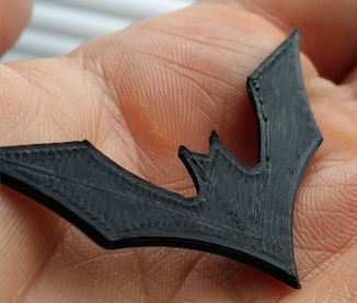

I really appreciate you taking the time to analyze this for me! I followed your directions exactly as listed above and I beleive it solved the problem. Top layer is much cleaner now. before and after pics below. (stl is different this time around because I felt that this batman logo illustrated the burnt looking top layer better than the previous picture). Thanks again for the help.jimc wrote:i dont know. the surface around the blocks that looks better still looks underextruded to me. none of the top surface lines are touching on the edges. they are close but not quite touching. if the infill gets all broken apart with holes then the top surface will be very hard to get right. broken infill usually comes from underextrusion and as you mentioned tim, too high a temp. in s3d there is a setting "use random infill placement". turn this off. your parts will be stronger and infill will be less likely to break since each strand is supported 100 as its laid down. it likeS to break from trying to print over a mesh. im not saying this is whats happening but it does kinda look that way. if you notice in his print, judging by it sitting on his hand the part that looks good appears to be very thin so there is probably no infill being put there. they are probably a few solid layers then it does the blocks, adds the infill and then everything gets screwy. tim remember he has a new m2 as well so 215 is fairly normal i think with a v3b but i dont print pla either so who knows. i somehow remember 210-220 being about right. so if that were my print my next moves would be this.

ahhh good. that looks much better. just now it looks like there may be a hair too much plastic. its close though. maybe bring the multiplier down 1 or 2 notches. it does look good though. i just notice your nozzle dragged across the surface so that can be a indication of a little too much plastic. also in s3d retraction control add .2 to the z-lift. it will keep it from dragging.
