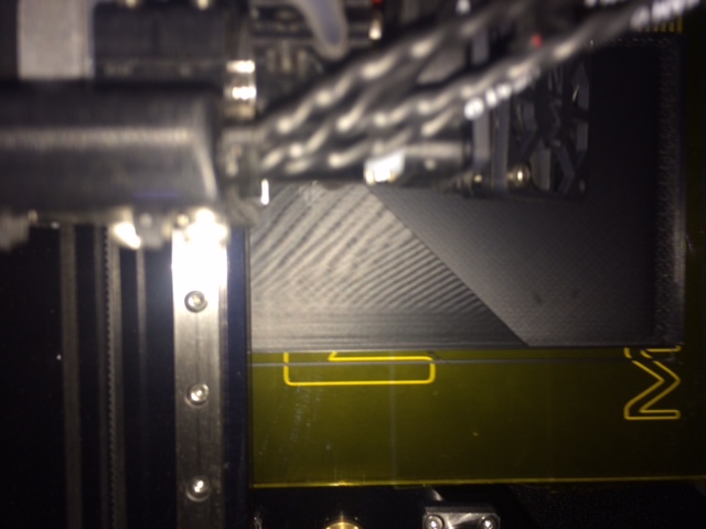

While printing I noticed the attached:
Layers added above smoothed it out. Not sure yet what the bottom will look like?

Looks like poor adhesion to the glass: that entire bottom layer is un-stuck, except for the perimeter. Once the nozzle creates a wave by pushing the loose layer around, it just won't stop.
Higher layers will more-or-less fill in the low spots and everything will work out OK, unless the bottom layer comes completely unstuck, in which case you get a bird's nest.
Are you printing on bare glass? Using hair spray or glue stick? With which plastic?
So many ways to have a thing go wrong... [grin]

Thanks for the quick reply:
ABS, Extruder Temp 240, Bed 100
Kapton tape...
Which do you have the most luck with: Kapton, hair spray, gluestick ,
I had a few small bubbles in the kapton tape . Could this begin the wave

Re: Bubble of bottom layer
Post by Tim » Mon Nov 17, 2014 4:23 pm
Try hairspray. It washes off easily in hot tap water. Plus it's trivial to put down, although you will want to take the glass off so you aren't spraying down the rest of the machine. Of the adhesion methods, glue stick is the easiest, followed by hairspray. Kapton tape is way down the list. . . total pain. Good adhesive surface, just not worth the trouble.
I have had bottom-layer bubbles form just because I put my finger down on the surface. It may not be your issue, but it is very easy to get a little oil onto the surface and end up with a spot of poor adhesion. Sometimes these imperfections correct themselves after a few layers, and sometimes they keep affecting layers all the way up.

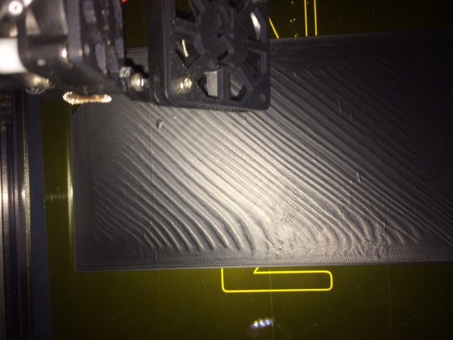

This is interesting. The bubble waves occurred after a few layers we already printed.. This time in the other direction. This is the layer currently printing over a smooth one.

Post by jsc » Tue Nov 18, 2014 8:10 pm
Perhaps you're over-extruding. One way to know if that is the problem is to use the dynamic extrusion control on your host (Simplify3D, Repetier, whatever you're using) and wait until you're getting some waves. Then turn down the extrusion by 20% and see if it stops. Then bring it back up slowly until the layer looks solid but without waves. Multiply your current extrusion setting by the multiplier you just dialed in and replace it with the new number.

Post by jsdonnelly » Tue Nov 18, 2014 11:49 pm
I have noticed some extruder calibration techniques. Does this apply or it depends situation.
I have only noticed this with larger flat surfaces.

Post by jsc » Wed Nov 19, 2014 6:11 am
There are a number of techniques (measure single wall object, etc.) I'm sure they all work to some extent. Since you're going to be adding in a fudge factor anyway (extrusion multiplier), I take the expedient step of adjusting it by eye, but if you want to be more scientific about it, feel free.
I have had similar waves appear when printing in ABS, and the culprit was over extrusion. Adjusting the multiplier down cleared it right up. I didn't chime in earlier because Ed's theory seemed believable to me, but if you're getting it AFTER a flat layer, then it's probably not adhesion problems. Although it is strange to see that it's only happening in one orientation and not the other....
Hm, now that I review your first image, though, I notice that the bubble lines go against the grain. That's not what I've encountered. Maybe get a short video of the bottom layer going down?
