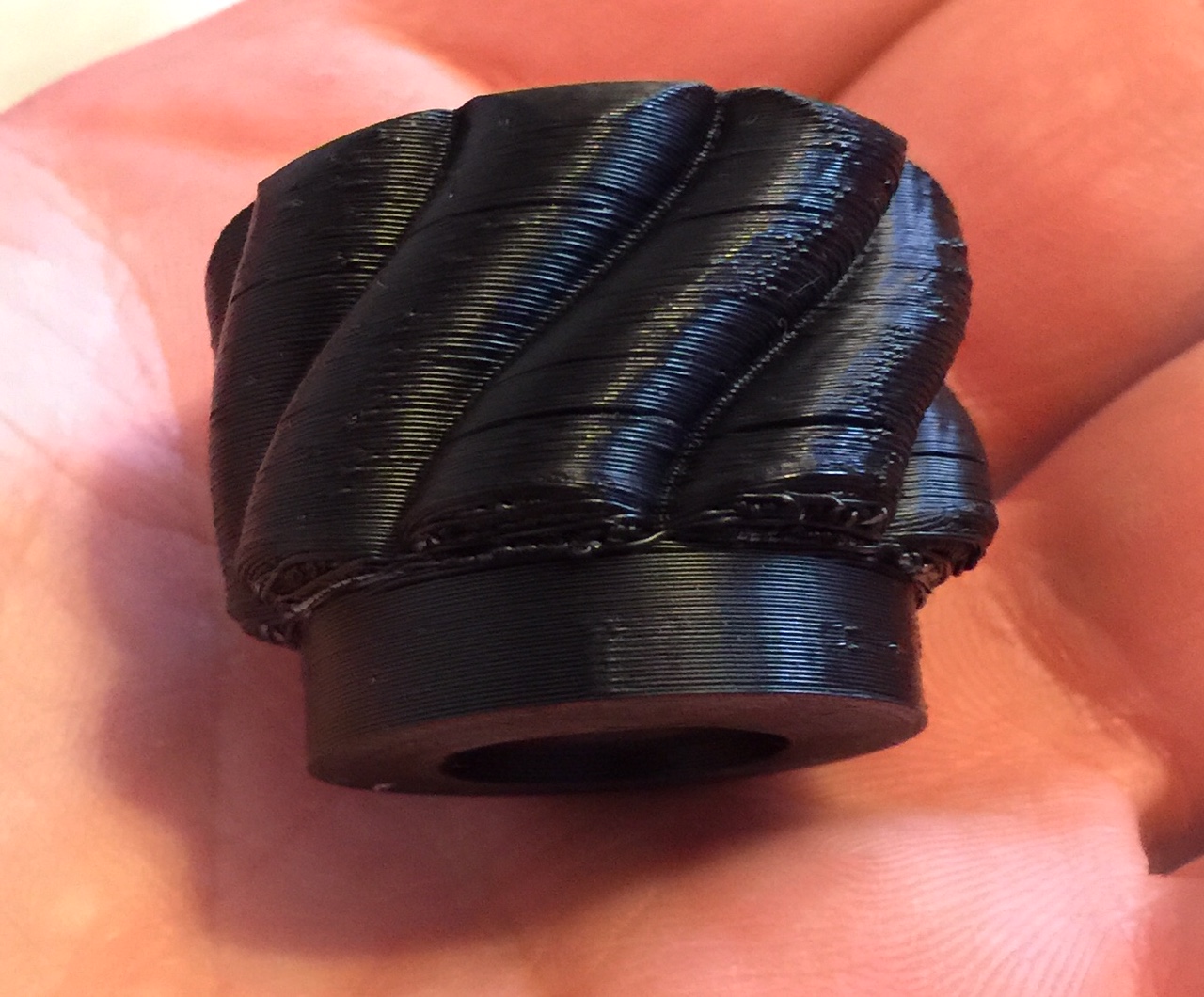

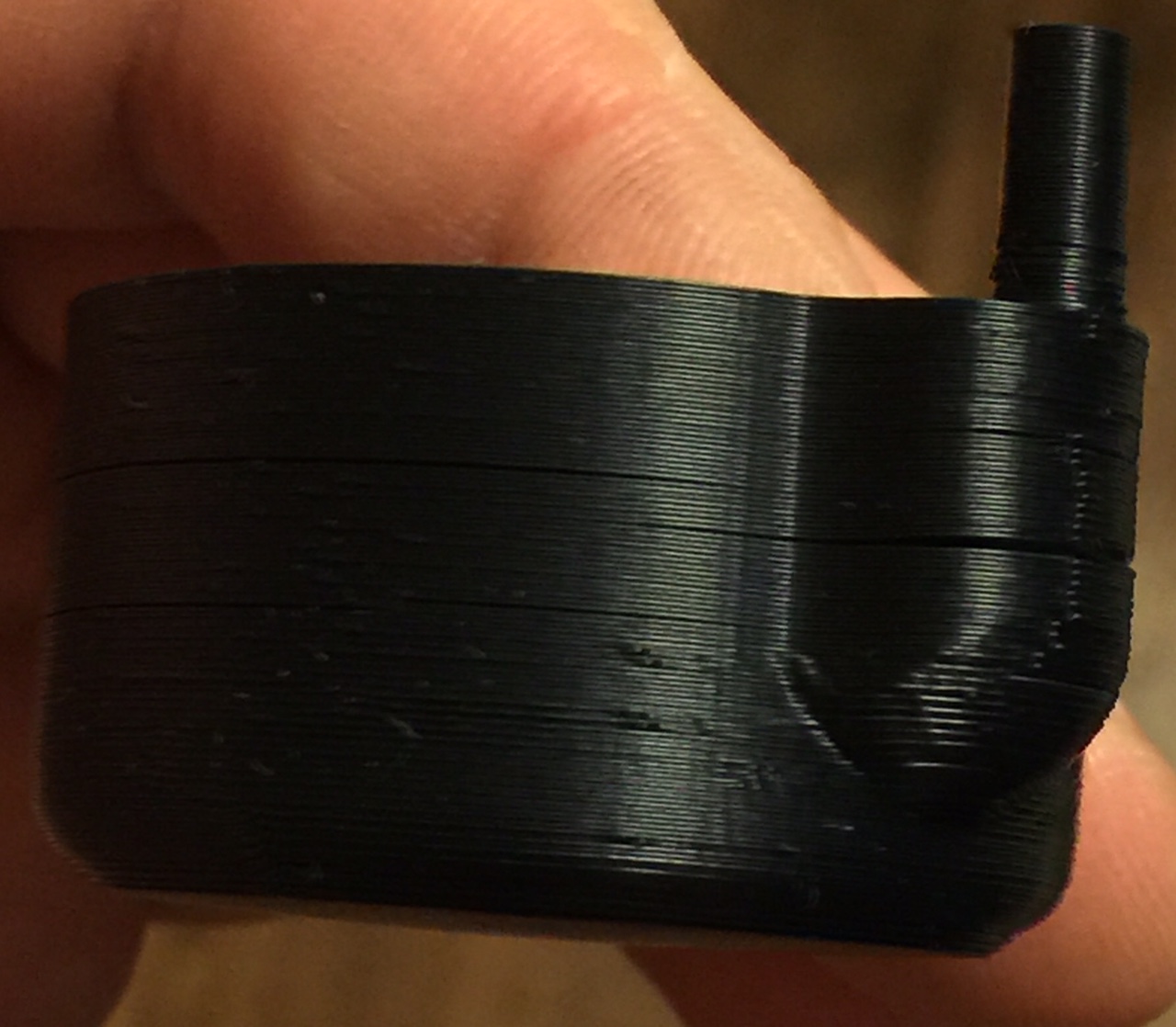

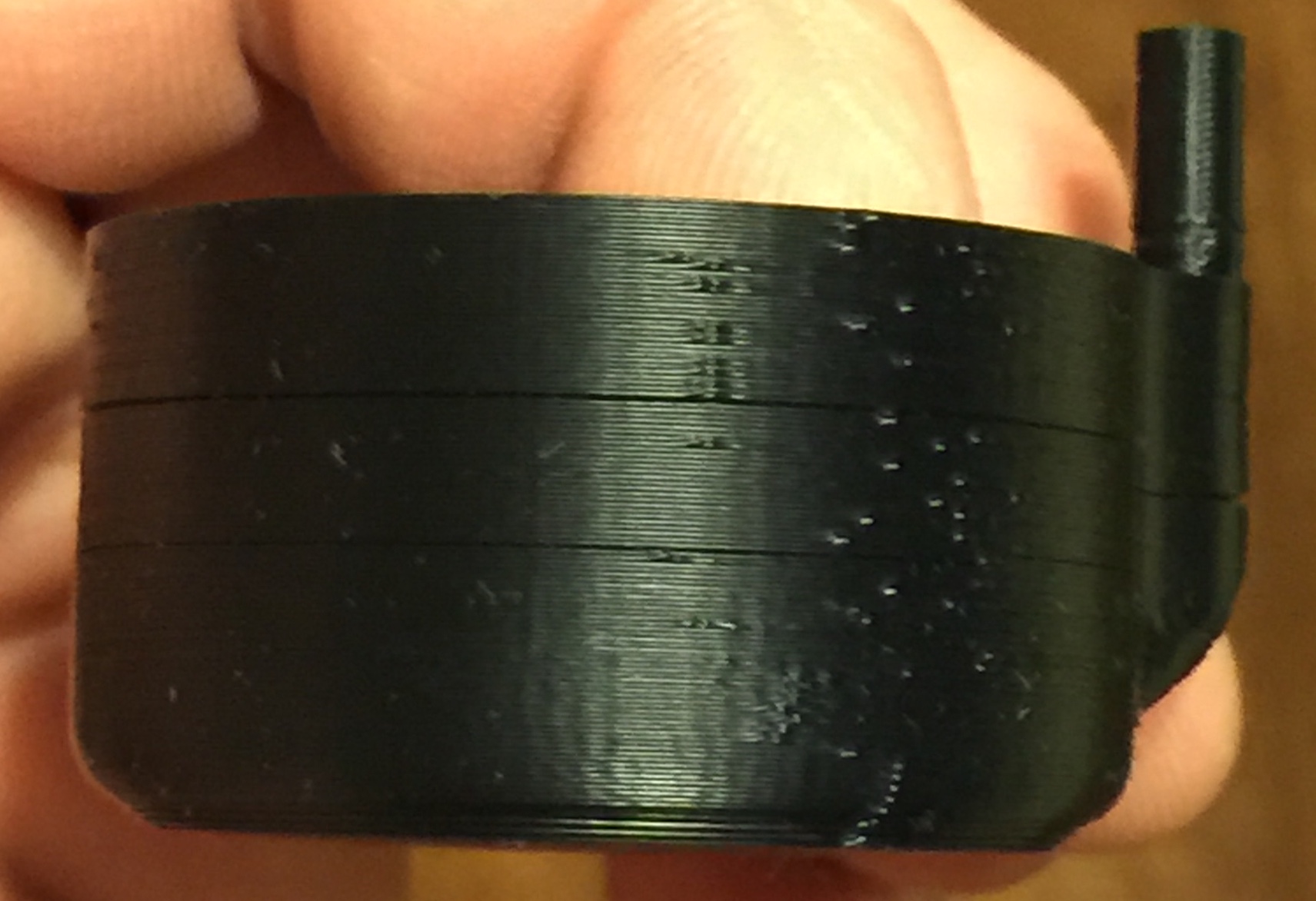

I got my M2 up and running and the bed leveled very well but something seems to be off here. I'm getting some layer separating and real rough rounded corners. Now I did slow the slow the X and Y down to 1000 as stated on the forum under tips I think.. I am using Simplify3D (newest version) and was wondering if anyone had a good G-Code setup they use for starting that works well and also what other fine adjustments might i make to get better prints? Also I'm adding a few photos to see what I mean about the layers. Extruder temp is set at 215c and bed is at 70c.

can you post a factory file or your fff file. something is off. it just doesnt look right. are you using makergear filament or another brand? looks like some poor bed adhesion, underextrusion and too high a layer height or extrusion width is too narrow for the layer height.
the knob model on the other hand looks like a real nice piece

Burn a small segment of that filament. If it's a small blue flame, its PLA. If it's a smoky orange flame, it's ABS. Also, PLA will smell kind of sweet, ABS will smell like a car fire.
I bet that's ABS...

jimc wrote:can you post a factory file or your fff file. something is off. it just doesnt look right. are you using makergear filament or another brand? looks like some poor bed adhesion, underextrusion and too high a layer height or extrusion width is too narrow for the layer height.
the FFF file is the stock file on S3D all I changed was the speed of X and Y and I added a rather sweet ending G-Code i got off the forum here (i forget who posted it as i save a bunch in a NOTES folder lol) T knob on the other hand is in fact awesome lol big thanks jimc you did a great job hands down!

insta I am using MakerGear filament.. When I buy something like this (a machine) I kinda go over board and go all out
and get this i found out what was wrong and your are dead on it was/is ABS! when I ordered my machine i also ordered like 8 rolls of filament ABS and PLA well since it came with black PLA i also got black ABS and of course i had to let my 7 year old help well i set the PLA on the table as he was going through and checking out what colors i got and confused the two well i didn't notice and sure enough i put it on! thing is i was running it at PLA temps and getting good results in small pieces such as the bed corners that adjust to the glass to keep it from moving heck they printed great! so i switched out to the PLA and printed the classic Turners cube and the bridging was awful it sagged all over the place way more than a little clean up can fix.. Im not really sure what adjustments to make to "fine tune" the nozzle without making it worse and is there a good test piece that is rather fast to try the bridging on?
