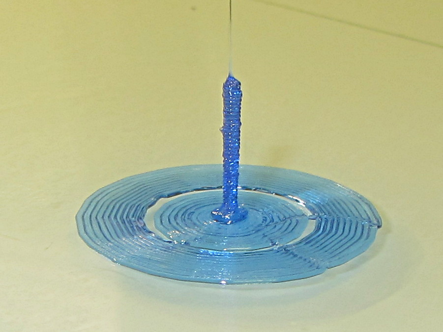

This isn't quite "perfect", but it seems reasonably good after maybe 15 minutes of tinkering:swbluto wrote:.7mm diameter 9mm tall cylinders
That's actually 0.9 mm diameter, because a 0.4 mm thread width from the 0.35 nozzle on my M2 doesn't fit neatly into a 0.7 mm diameter circle. If you have a 0.25 mm nozzle, then 0.7 mm would be feasible. It measures 1.1 mm diameter over the small defects, so a little fine-tuning may be in order; I'd want to tweak the Extrusion Multiplier more carefully if I were doing something like that.
Sliced with Slic3r for PETG at 1 mm/s, with fans in full effect. It sits inside a 5 mm brim and a skirt that uses 15 mm of filament.
The OpenSCAD model consists of one line:
cylinder(d=0.9,h=9,$fn=8);
When you say "it's not the slicer", have you verified all the essential settings between the two machine profiles? Differences in the minimum speed, thread width, or any of the automagic settings will definitely skew the results; my default settings for rationally sized models didn't work at all.
On the other paw, after a bit of fiddling, all I had to do was force the print speed to 1 mm/s and leave everything else alone.

You're (trying to) print something two threads wide at 50 mm/s and you wonder why the nozzle pulls a high-aspect-ratio pile of viscous goo off vertical? There's no possible mechanical slop affecting that problem that wouldn't show up elsewhere; it's all in your slicer settings.swbluto wrote:momentum of the motor during higher speed maneuvers
To wit, using your current settings, can your Rep 2 print a single 0.7x9.0 mm cylinder to your specs? At 50 mm/s, the entire cylinder should print in a few seconds and I find that hard to believe.
Comparative pictures of the same models on the two printers would be enlightening; I'd like to see them!
You could put a modifier mesh around each cylinder and print them with appropriate settings, without affecting the rest of your model. Oh, wait, that's a Slic3r feature.I'm not going to slow down my entire print to 1mm/s to compensate for this
Sorta like switching from PLA to PETG and expecting it to print perfectly, without changing any settings at all, because the printer & slicer settings have always worked before. Might happen, but ... different materials, different models, different machines all require different settings. Nothing surprising about that, methinks.I've been using these machines successfully for a while, so I know my printer settings are just fine.
