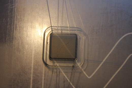

for a few days now I'm having trouble with my Y-Axis finding zero and or skipping steps with the result in shifting in x and y.
I made a video in this video every stop means zero on Y-Axis. http://youtu.be/S3VjHBG3UqY
Shift at first few layer.
