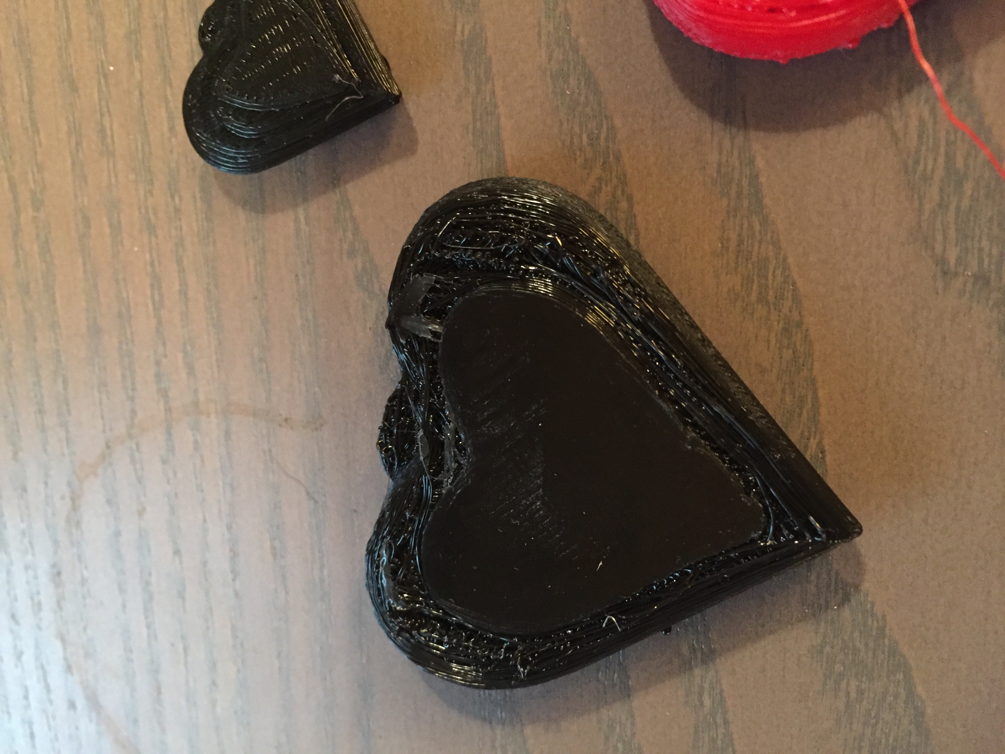

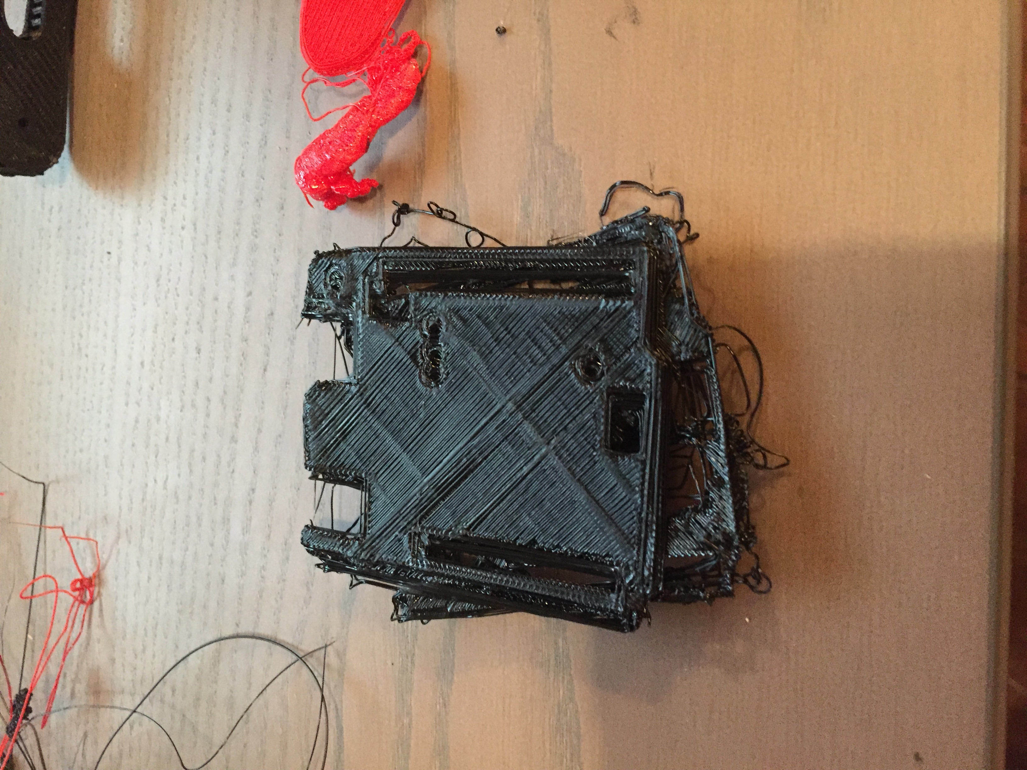

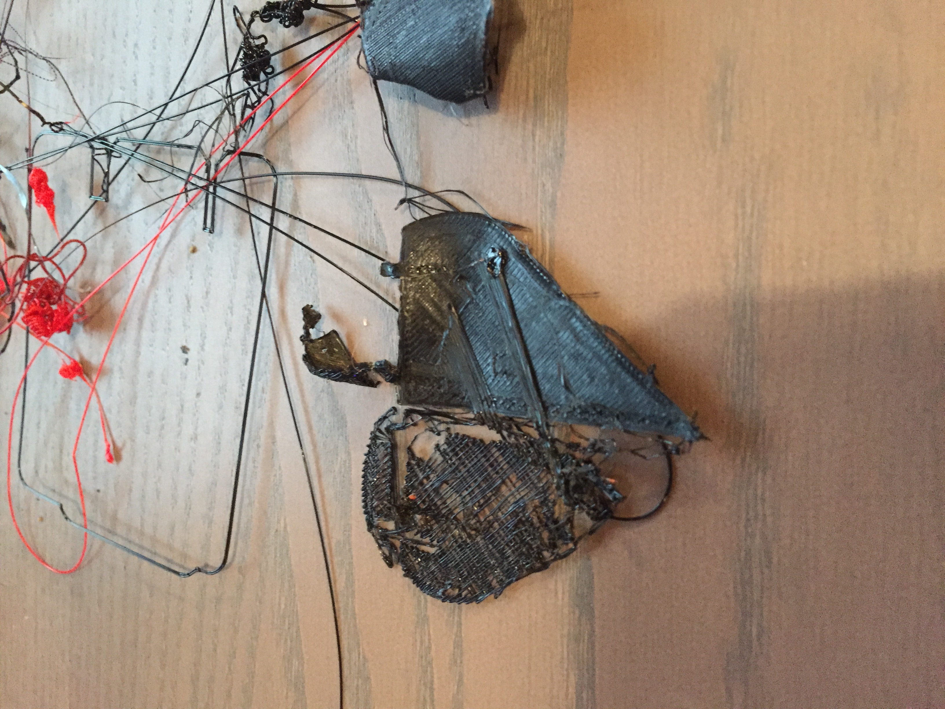

So bummed to say this but my new M2 machine is not something that's ready for prime time. I've been at it for a couple of days now. I've re-leveled the board plate and the pins a couple of times. I've rechecked and adjusted my temperature controls for the nozzle and the plate. Even simple shapes like a flat heart are just too much for this machine to output. I've given up on trying to print out my fancy robot legs and just tried to print flat plain legs but even those have all kinds of issues that i can't really use any of them and it seems impossible to get the same result to come out three times in a row. Once i had the leg done, looked beautiful but it melted to the plate. I waited for the plate to be cold to the touch but the printed piece broken while i was trying to pry it up from the table.
Here's a couple of photos of hours and hours and hours of hoping and tweaking and holding my mouth right and buying extra software. I did get half of a raspberry pi case printed. The bottom only, it seems the top was too complicated to hold up.
I kept simplifying a small heart shape i wanted to put a tiny light inside of. Printing it flat against the machine was impossible, I tried to standing it up but it build millions if feet which encased the piece in hard plastic. Finally a simple clip art shaped heart just to prove it works, too little heat it splits into layers, too much it burns the table film (yellowish stuff). I've adjusted the temp a few degrees at a time trying to find the sweet spot but it seems to change in the middle of the print. My dreams are dashed :( If anyone is wondering if this printer is ready for the average consumer, i'd have to say 'no, but i wish it was'. I got a tiny stool to print out great from a website. it was the first thing printed. It;s the only thing i've gotten to come out that was semi-decent. Tried the fast, medium and best quality but issues everywhere.

There may be some fundamental misunderstandings about the technology, as well as a few miscalibrated settings at play here. Nothing I'm saying after this is specific to the M2, but rather FDM-style printing (which is any printer you'll get for under $2000).
When choosing parts to print, especially without support material, you must pay special attention to the overhangs of the part. The plastic is coming out molten. Molten plastic sags, slumps, and is stretchy. Any individual thread of plastic must (with very few exceptions) have plastic underneath to hold it in place. Your heart shape failed because you have a very shallow curve upwards -- when the print head gets to the next layer, its putting plastic there, but there's no plastic underneath to hold it in place. If you didn't flip the raspberry Pi case lid upside down, it's going to fail in a heartbeat, as it's 99% overhang.

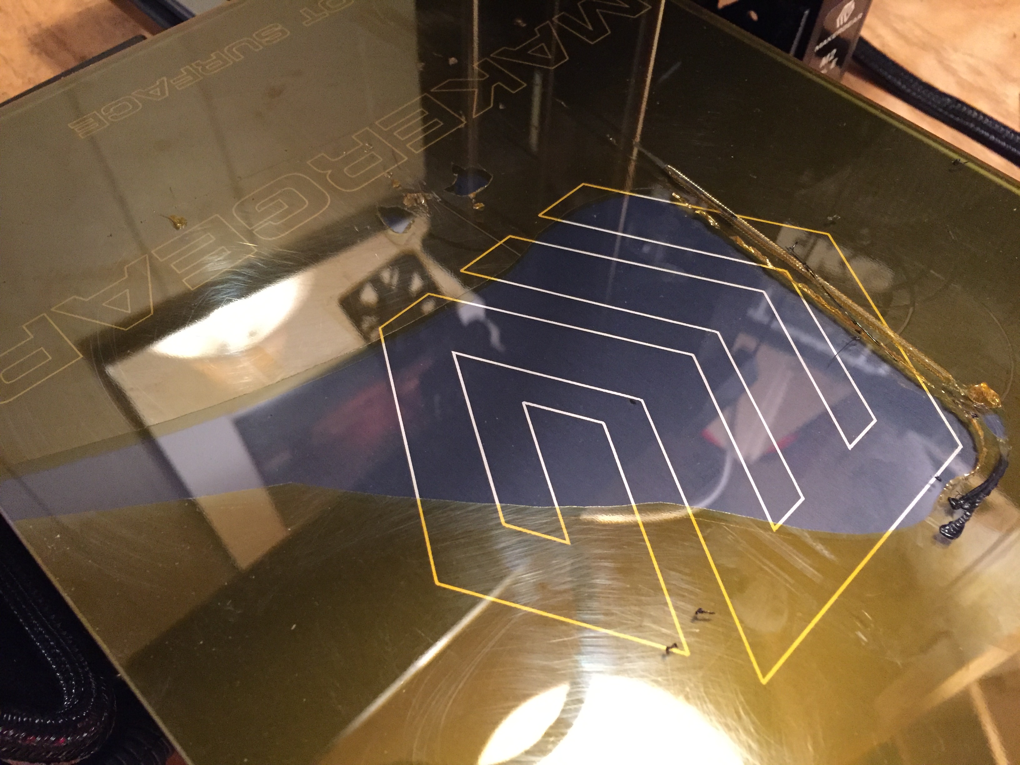

Also, I want pictures of your "burned" bed surface. Based on the sheer gloss of your posted parts, and the fact that Kapton can't "burn" at anything lower than the temperatures of an open flame, I'm guessing you're way too close to the bed -- and the "burning" is instead just mechanical damage from the nozzle ripping the tape up. If you haven't gone through the quick-start app to set the bed height, you aren't done, and I'm not surprised you're getting failures. A proper first-layer height is in the top 3 most important things that are mandatory to get correct for FDM printing to work without failure.
The included PLA with your printer should print at a nozzle temperature of 205C, and a bed temperature of 60C. You should be able to slide a piece of printer paper between the nozzle and the bed easily (both pushing and pulling) without it binding up.

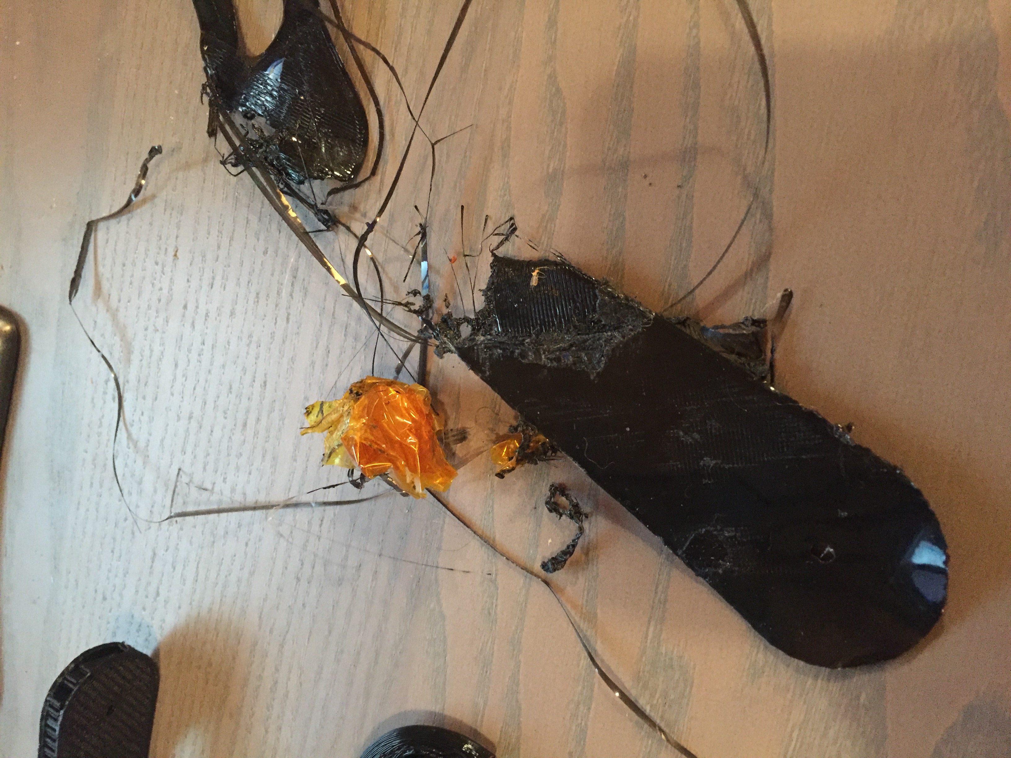

I am really wishing i was just getting some results to put me back in the fan column. Also, now that the yellow film is torn i don't know what to do. I've found some youtube videos that explain tape is used on non-heated beds, the 3d printer came with a roll of tape but i have a heated bed and this film? Not sure what it does. It told me in the directions not to remove it. Maybe i've missed a manual somewhere? Im not going to use it until i can find what the tape is all about and how i get some new yellow film for the heat plate.

I've attach the image of the "burned" part of the heat plate. Better word is "melted". I would be most open to anyone educating me about my results or how i can better understand this technology or use it more effectively. Right now, I'm not sure if buyers can expect to hit print and rely on an object to come out barring the occasional "paper jam" that consumer products will have.

That's definitely too close to the bed, and you cut & tore the tape with the print head. Remove the glass bed, peel the rest of the tape off, wash the bed very, very well with hot water and dish soap (and a scrubbie), until it's the cleanest thing in your household, then clean it further. Dry it front and back with paper towels. Tolerate NO specks, adhesive, or dirt -- use a razor blade if you must.
Place the clean bed back on your printer (don't clip it in), heat it to 50C, REMOVE IT FROM THE PRINTER, then set it down on a raised surface (I use the railing on my deck, or spanning a small trashcan), and soak the bejesus out of it with Aquanet "Extreme Hold" hairspray. It comes in a white & purple can at the dollar store. You want the hot bed to evaporate the hairspray quickly, and you do NOT want hairspray near your printer.
Once the bed is soaked and steaming, carefully place it back into the printer so the heated plate can drive the rest of the hairspray off. Once it's dry, swivel-clip it back in, start a print, and force the Z knob counterclockwise a few clunks, right before the extrusion starts. This will drop the print bed farther from the nozzle and prevent dragging. Get down at eye level with the printer, and clunk the knob back and forth until the height of the thread is about equal to its width -- this is a wholy unscientific method of getting prints running, but it will narrow down the machine working or not.
Use your PLA at 205/60C, and print something simple like my NEMA17-608ZZ adapter: http://www.thingiverse.com/thing:21499

As insta notes, there are severe limitations on the physical objects you can create by "drawing" with near-molten plastic. Overhangs, except for ones so slight that the extruded plastic can partially rest on the previous layer, are out. There are many possible solutions:
-- Change the orientation of the part to eliminate overhangs. For example, if you're printing a large letter "T", print it laying flat on the bed rather than standing vertically.
-- Use supports (you indicated that you've tried this. One nice thing about Simplify3D is that you can edit the supports the program provides. Often you don't need as many.)
-- Break the model into pieces that can be printed individually.

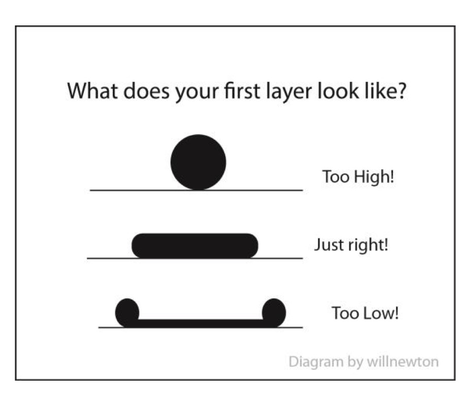

It's great that your bed is level, but you need that first layer to go down properly, as it sets the stage for the rest of the print. I prefer blue painter's tape vs. hairspray or Kapton (the yellow stuff you are dragging your nozzle through) as it is cheap and disposable and fast. The difference between a good first layer and a bad first layer is VERY small (.10 mm or less). Master the first layer by printing very boring squares and cubes. You can venture into overhangs later.
This picture is going to show you what to look for. Too bad it does not have the "So low you rip up the substrate" pictured, but you'll get the idea. ;)
