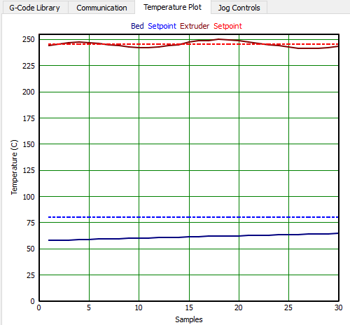

Now, my question is the following: I'm having actually some variations of temperature at the extruder (for a setpoint of 245, it goes up to 248 and down to 242, more or less), and as you can see on the image, it's doing it constantly.
What could be that issue?
