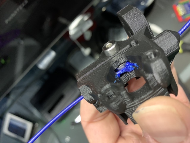

Ok I have been using the same petg filament for it seems like forever. So here goes. It will start a print, the first layer looks good then it will make it through the 2nd layer almost all the way then stop extruding. I was thinking the nozzle was clogged great, but not the case retract and the filament comes out. Cut it then put it back in and name extruding again fine. This is how it started and now the petg will get stuck around the extruder gear so bad that I have to remove the black filament guide or whatever you call it. I will upload a pic tomorrow it’s late. It seemed kinda hard to manually push filament through. So I removed the nozzle. Pushed all the old filament out put a new nozzle on .50 this time. It worked great for 2 prints then started to do the same thing. Not sure what is going on have tried higher terms ends in the same problem. Need some advice please.

Measured it was 1.76 going in I attached a pic of what it does. Have it all cleared out going to try it again. Measured the filament down the spool a ways it was all 1.75 or 1.76 but will give it a try again.
