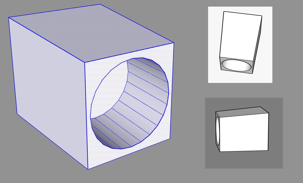

Again, thanks to all for the helpful info and advice. Since I can't seem to upload the actual model file, I made a simple JPG so all can see what I'm trying to make. The scupper is, as I said, 0.080 x 0.080 at the top, and tapers to 0.070 x 0.070 at the bottom, and is 0.100 long. The hole in the bottom is 0.062 diameter, and is where the drain pipe attaches (made from 0.062 diameter styrene rod). The backside upon which the scupper lays during building is flat and perpendicular to the top and bottom surfaces.
- Scupper.jpg (238.8 KiB) Viewed 17100 times

(0.07 in - 0.062 in) * 25.4 mm/in = ~ 0.2mm. The thinnest parts of the wall are too thin to print with a 0.4mm thread thickness. You will need to increase all exterior dimensions by 0.2mm at the least.
Re: First Self-Created Model Won't Print
The geometry will prevent the top from filling completely: the acute angles where the perimeters neck down to a single thread width (that's after enlarging the dimensions) won't allow solid fill, because the angle will be narrower than a single thread width.jsc wrote:increase all exterior dimensions by 0.2mm at the least.
Also, if you want the hole to fit a rod, then you must slightly oversize the hole to ensure it'll actually come out right.
I did a quick OpenSCAD model and the box disappears around the hole, leaving a single, round-ish perimeter thread. The slightly larger base consists of two nested squares, plus an infill dot.
It's simply too small to produce with a fused-filament printer.
