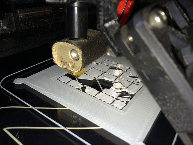

Can I hijack this thread a bit: i have similar print issues. I dont have access to my configs until Monday though.
Support bases tend to peel up, this is a really bad case of it:
(as an aside i feel like where the infill meets the perimeter could be better.)
Overall quality looks okay but.... The first 2 layers look pretty abysmall 0.35mm base and 0.2mm layers: Finally, the perimeters seem to be a bit anemic... I know this last one is blurry but you can make out that the perimeters have a gap between them
Re: I cant seem to get nice prints
1. Are you using anything on the glass? Try hairspray or glue stick or diluted white glue. Bare glass will work for a few prints, but it will quickly stop holding on tight enough to prevent peeling up unless kept meticulously clean.
2. You are probably printing too far from the bed. Get a set of feeler gauges from Amazon or an auto parts store, they're very cheap. Find the one that says 0.006, then adjust your z stop until it just drags out from between the glass and the nozzle when the stop trips. Check several areas of the bed. You can see in that base print that your first layer looks thicker than the others.
3. Run Ed's suggested calibration to dial in your extrusion multiplier. (Or just keep bumping it up until your perimeters fill in if you don't care too much about absolute dimensional accuracy.)
