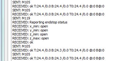

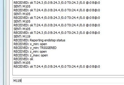

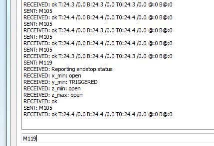

Here's what I get with the switch closed... Y_min: TRIGGERED
And then open...Y_min:open
M119 open.JPG (21.62 KiB) Viewed 36361 times
What does it mean?
