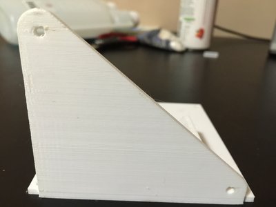

No, that's not a hardware issue, it's more likely a filament issue. There are different stressors acting on the plate with the different motions - they are always there, but some filaments show them more readily than others. ABS is an easy filament - it's more forgiving of not having everything set to exact tolerances. Unfortunately, PETG isn't. It's very fiddly. Once you get the settings correct, it prints like a dream, but frankly it takes some experimenting to get it set just right.I was printing ABS before, and didn't have any of these issues occurring in either direction, but I'm not sure if that is proof enough of a hardware issue not existing.
(Yes, i have noticed a difference in how bridging is impacted when it's performed in different directions. You're not wrong, but you might be smacking up against the limitations of the filament. Try slowing down the print a bit more.)

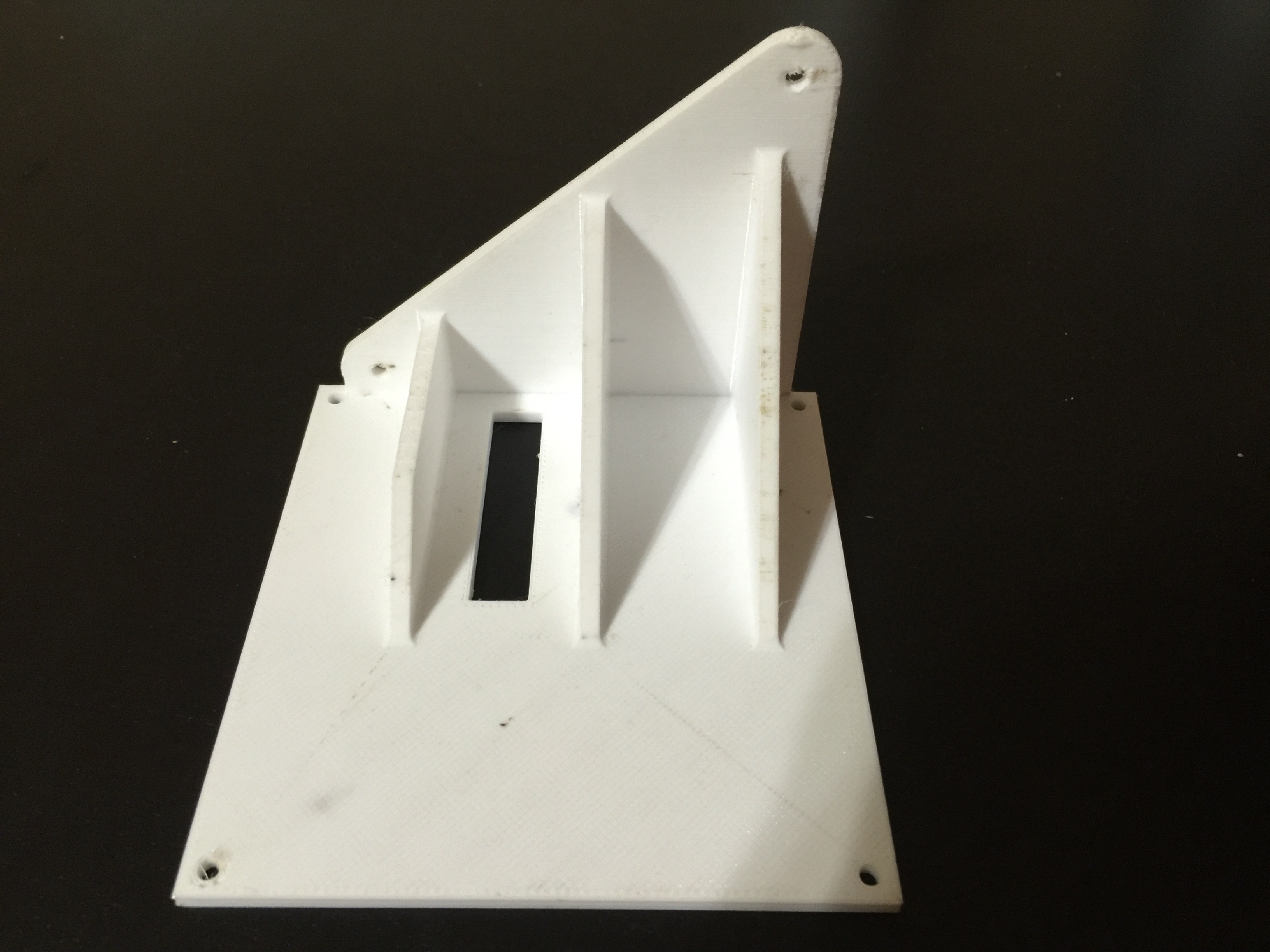

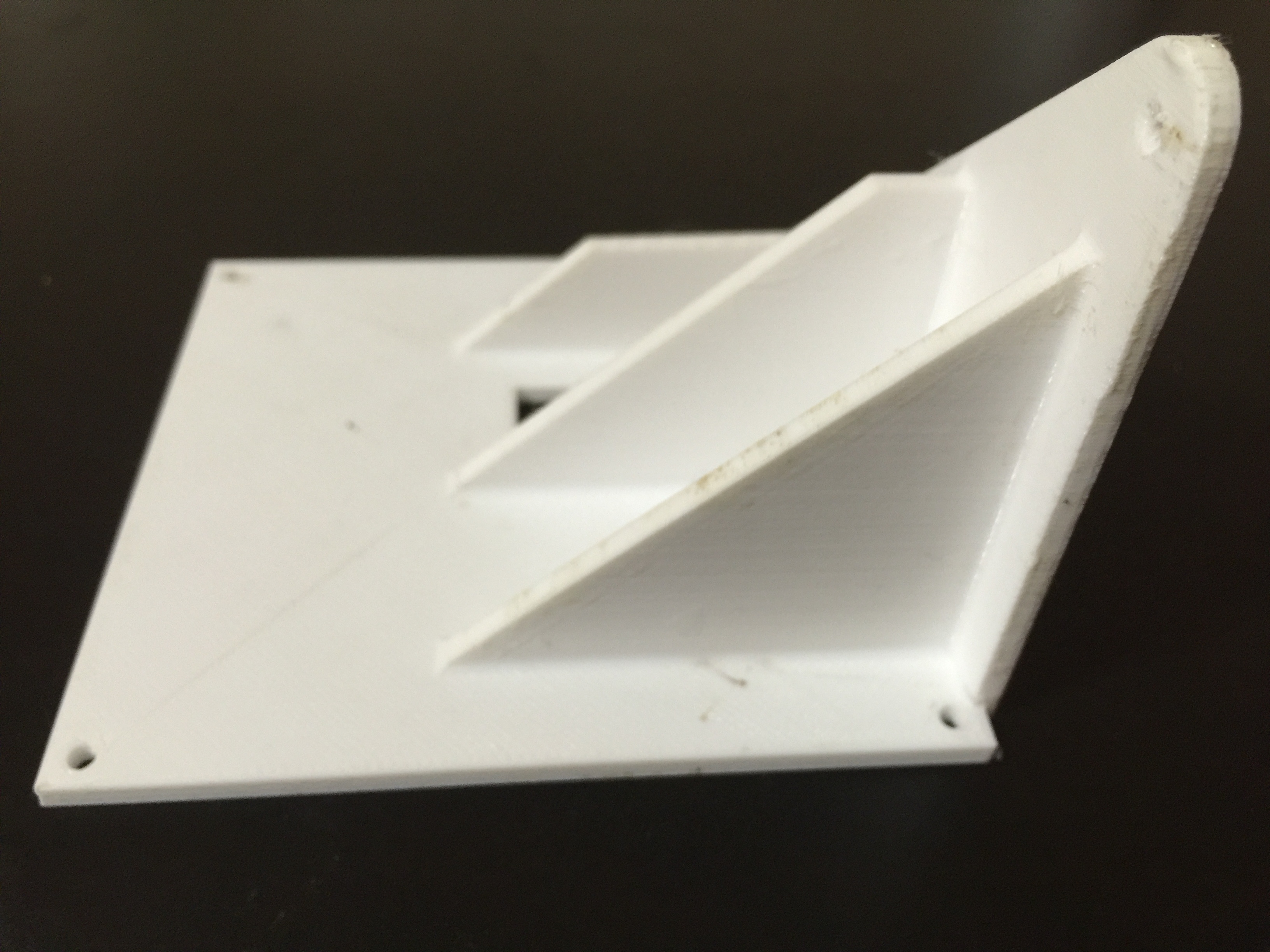

What you need to do to avoid the little threads that are created on the nozzle is "air-print" the PETG just a little. Since your initial problem was with incorrect tension and fill percentages, and you changed the Starting Height (aka: Z-Gap). You needed to get past that before the threads became a problem. Do not adjust your gap again - it's as close as you are going to be able to physically get it, and the print looks good with the exception of picking up threads.

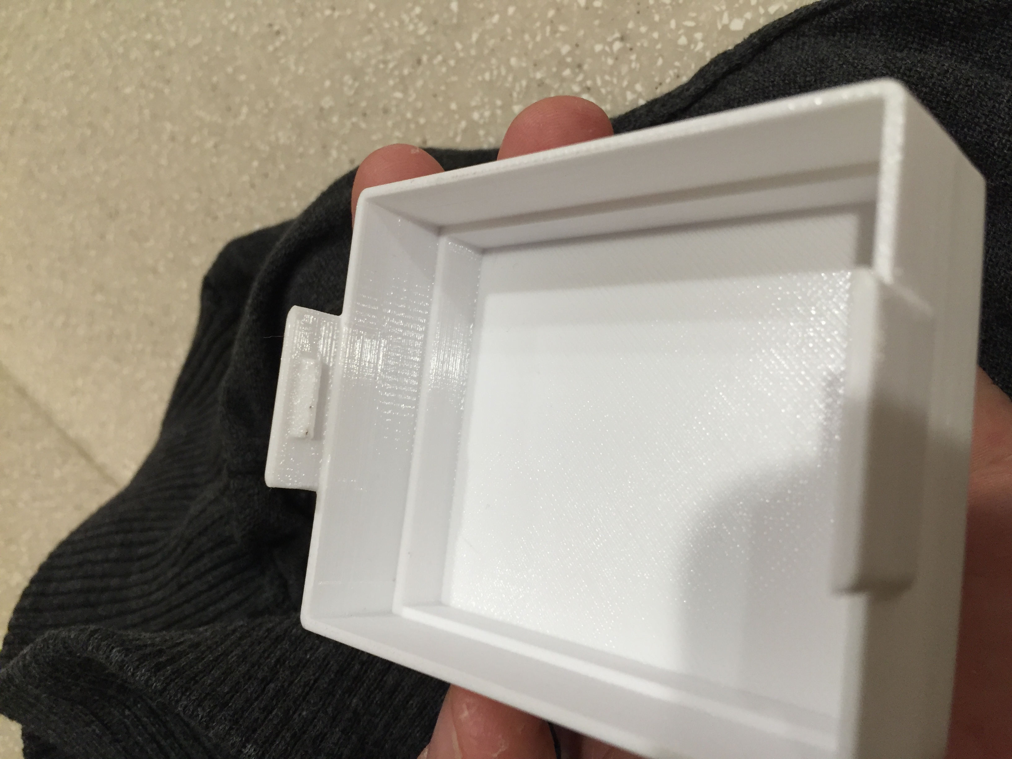

The threads are formed when the very tip of the nozzle just barely brushes against the top of the filament that has already been laid down. It sticks to itself very readily. (You can see it if you get down at eye level and watch the tip of the nozzle while it prints. For PETG, you should be able to see a fine line of air between the nozzle and the previous layer.) So you need to increase the gap size by from about 0.02 mm to 0.04 mm. Start with 0.02 mm, give it a try, and if it's not enough, add another 0.02 mm to the gap.
The Rev E. machines, due to the way the starting point is calculated for the first layer, need to be modified for small increments using Steve's explanation below:
sthone wrote:
From the Command Line in S3D
First Type M501 to read the EEPROM parameters
Look for the M206 line. (it should look something like M206 X0.0 Y0.0 Z4.20)
You can then adjust it using M206 Z[new value] (so add or subtract your .02 mm to what ever your value was to raise or lower the starting height)
and then M500 to save it to the firmware.
That should take care of it, but it might take a sample print or two to fine-tune it. Just use small increments.

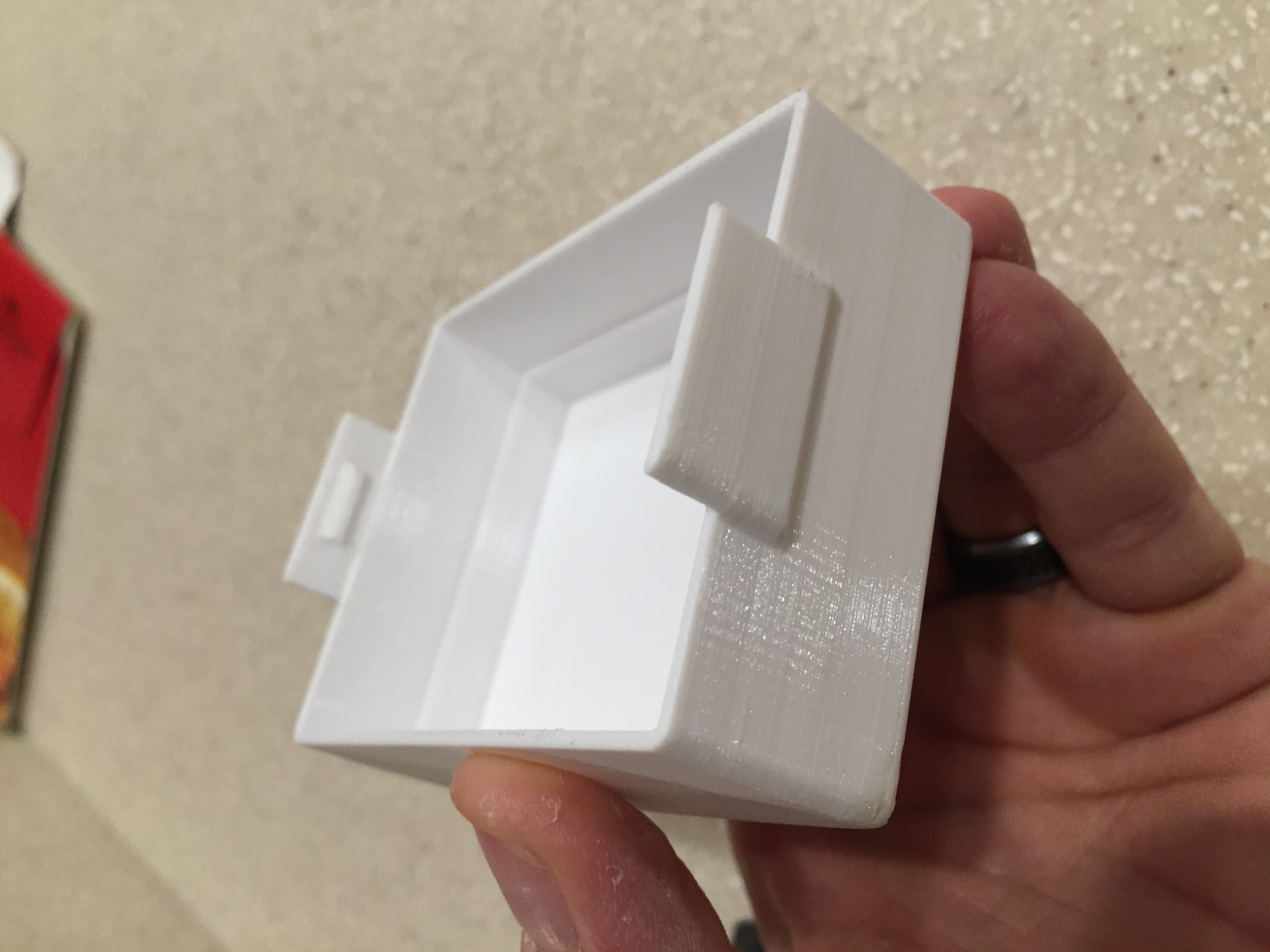

One other thing - PETG prints best with taller layer heights. 0.1 mm high is too ambitious for me to have tried with PETG, and your print ratio at 0.4 mm wide for 0.1 mm high would be just about impossible to control.
Set your layer width to 0.47 mm, and your layer height to 0.25 mm. That's the sweet spot for printing PETG.
