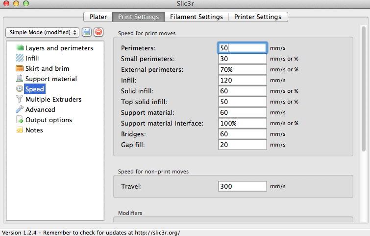

@JSC, Thanks for the info, but I'm a bit confused. here are my settings for now...
Screen Shot 2015-01-07 at 8.47.05 AM.png (90.86 KiB) Viewed 15173 times
and my perimeters are already quite slow at 50mm/s
the value that you quoted was the infill and the ex-perimeters doesn't reference the infill.
@everyone Overall are these speeds appropriate for an M2 or they more generic to any machine?
I set my Default acceleration to 1000mm/s^2 and the perimeters to 800mm/s^2, does this seem reasonable to everyone else.

I must have made a mistake, you are correct. You are printing at 120/50/35 (infill, exterior, interior)
