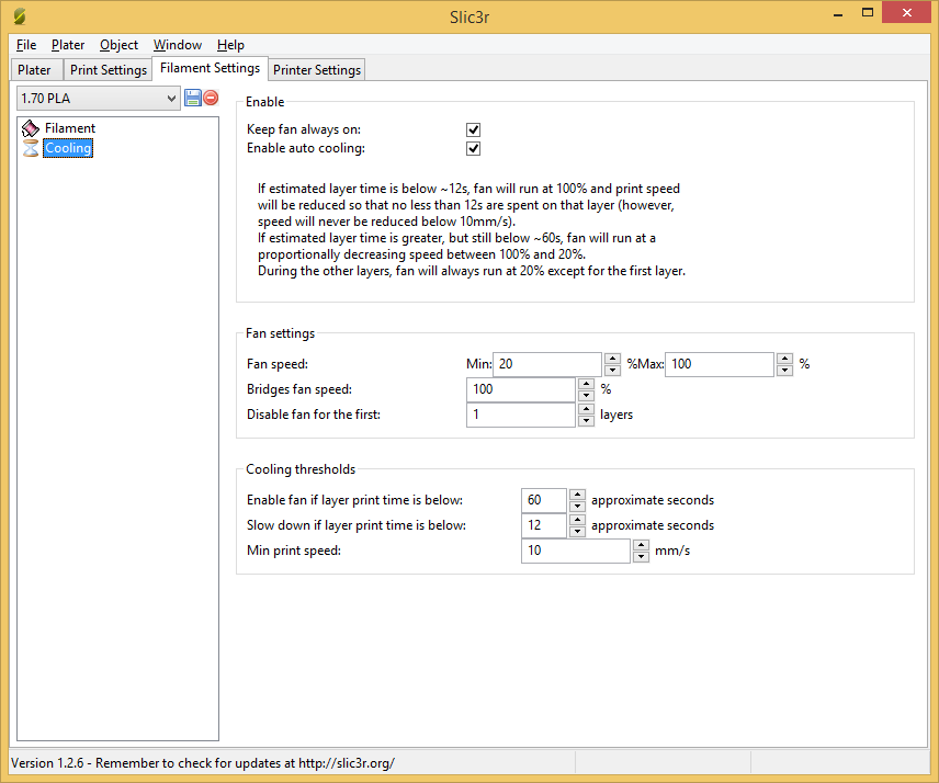

70C is too hot for PLA, it'll actually heat & soften the plastic and cause it to curl. Try 57-60C with hairspray or diluted Elmer's glue for a bed surface. Make sure your first layer is good, and the bed is level -- there are many threads (usually posted by Jules) about how to do it.
M106 is the command that turns on the fan, but slic3r will generate those commands for you.
