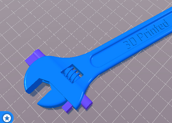

Okay, ran the wrench, and had one devil of a time prying one of those supports out of there. Matter of fact, it chipped a little piece off of the wrench end trying to pry it out (very low infill). Did manage to get the other two supports out after running an Exacto knife down along the movable jaws.
Supports in purple.
Might just be the tight tolerances on that one support behind the movable jaw - you'll probably have to get that one out before you can remove the others. Everything else printed just fine, without any filament sag, but i have removed my bed fan guard. That really cools the whole thing - (might even be better than using a shroud, since it hits the whole thing at once.) You could try it if nothing else works.
For files like this one - with a lot of internal bridging that needs to stay neat to keep from sagging down onto a print below, you could try increasing the bridging speed by about 10-15% or so. (PLA is usually very good for bridging though, so you wouldn't need much.)
