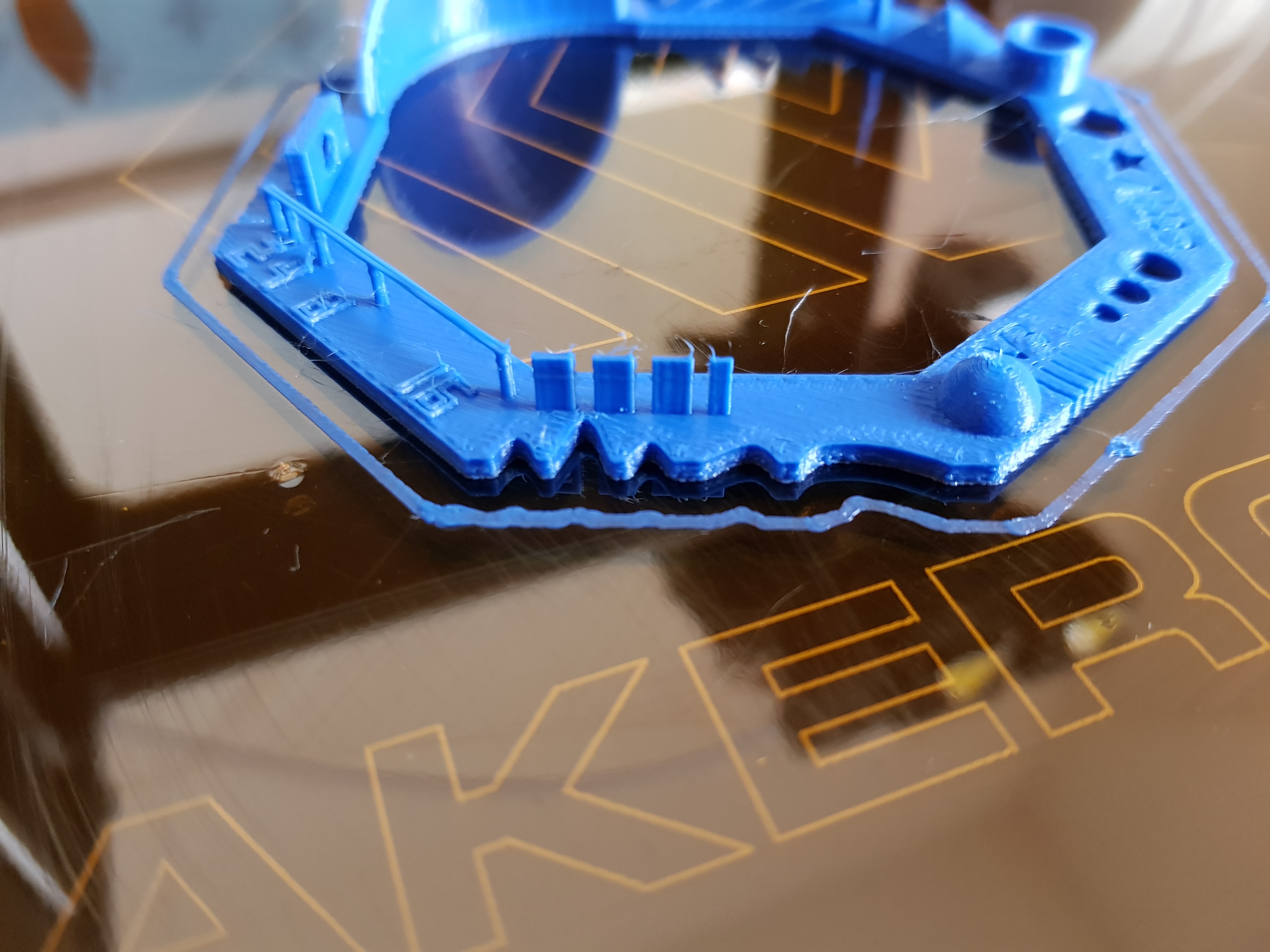

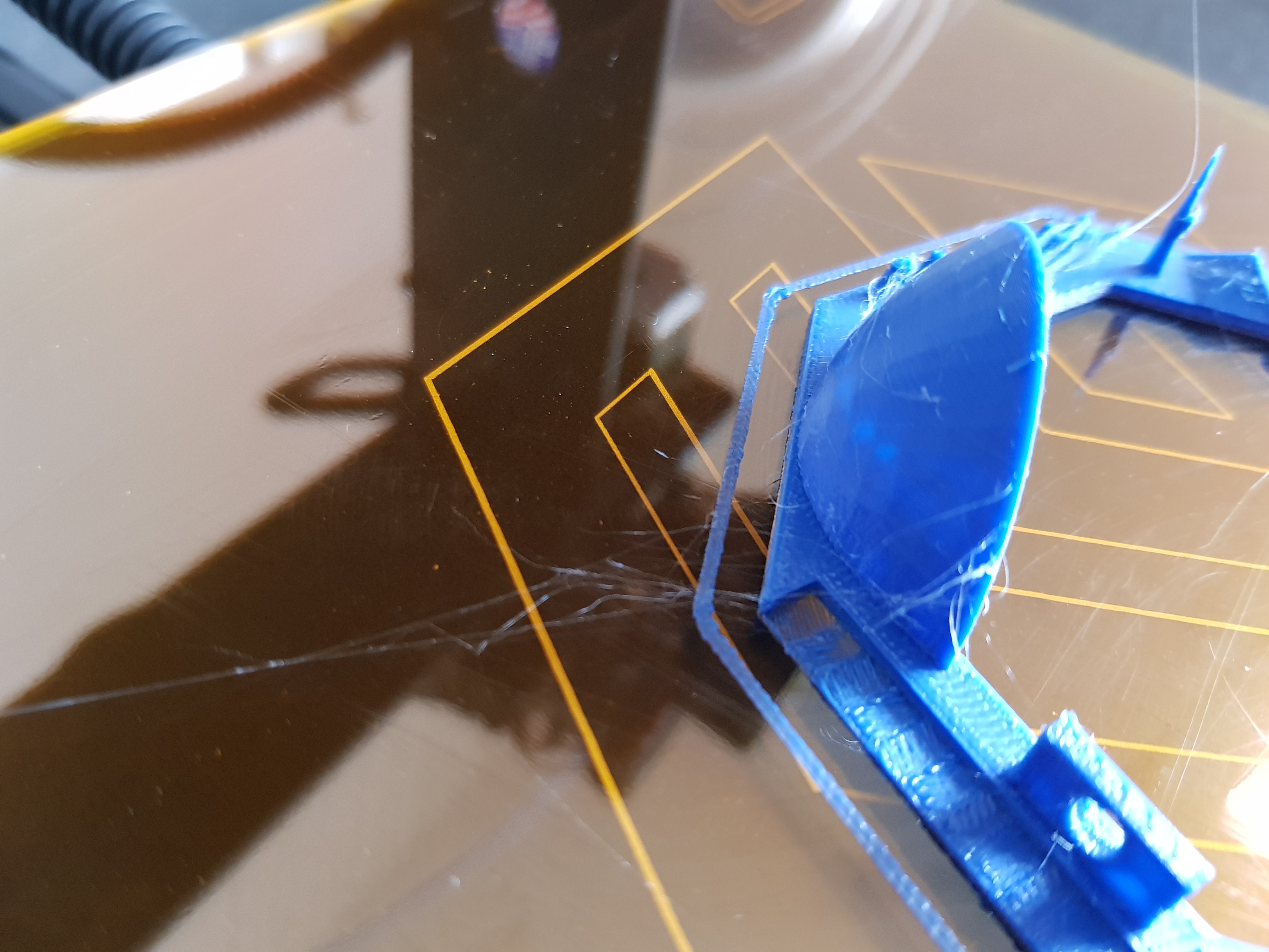

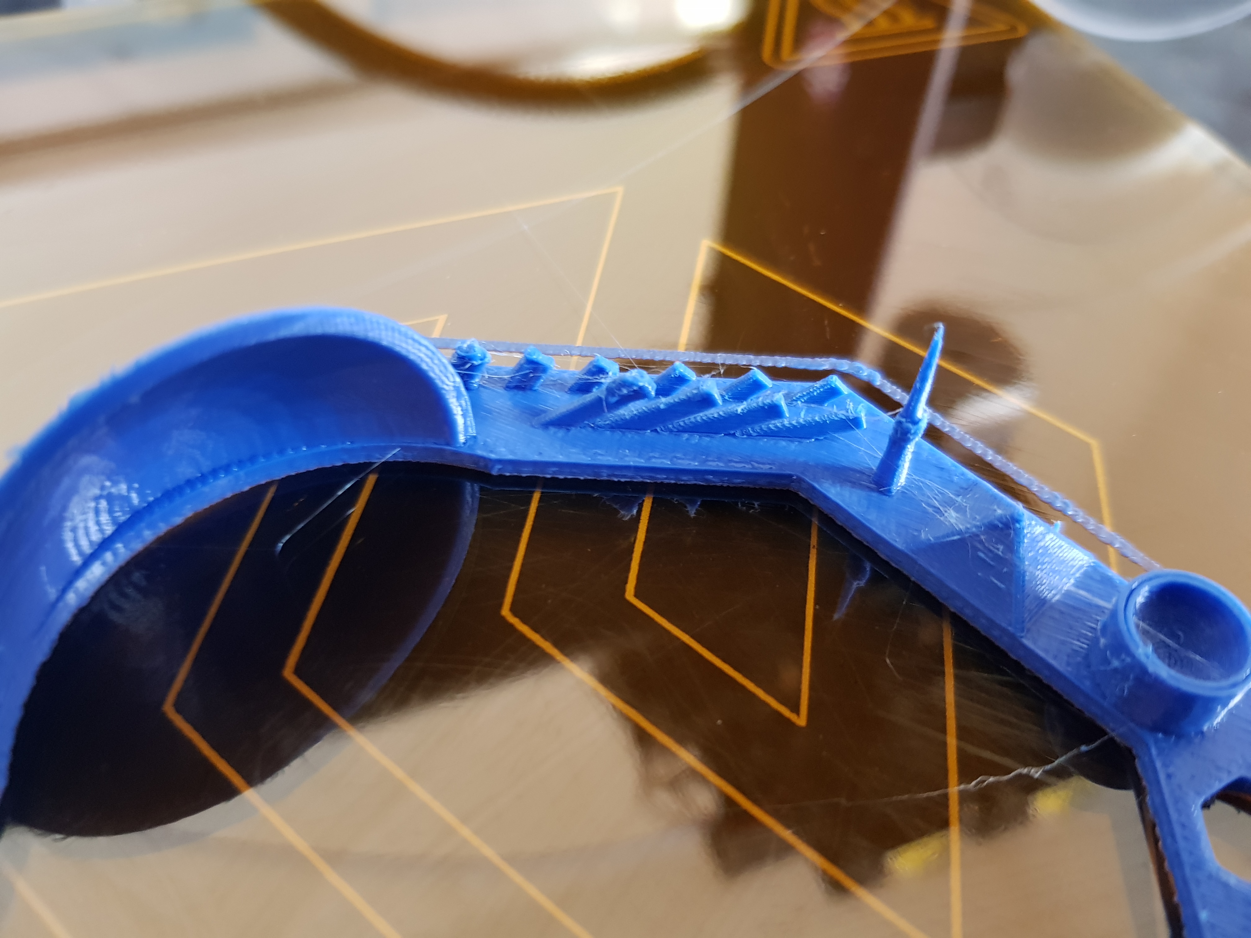

Hi all,
I performed the CTRLV V3 test for the M3ID and the issue I encountered most is stringing,
Now I know I should fiddle with the retraction settings, but as I'm really new I don't know how much or which settings.
I'm using al the basic settings and PLA from makergear. 0.1mm layers. speed 50mm/s or 100mm/s not much difference there.
Can someone give an me a headstart based on the pictures of the part?:
Re: stringing with the standard settings
Post by sthone » Wed Jan 10, 2018 7:18 pm
Even if you do not use S3D this is a great guide for learning how to fix all the issues that may arise ... https://www.simplify3d.com/support/prin ... eshooting/

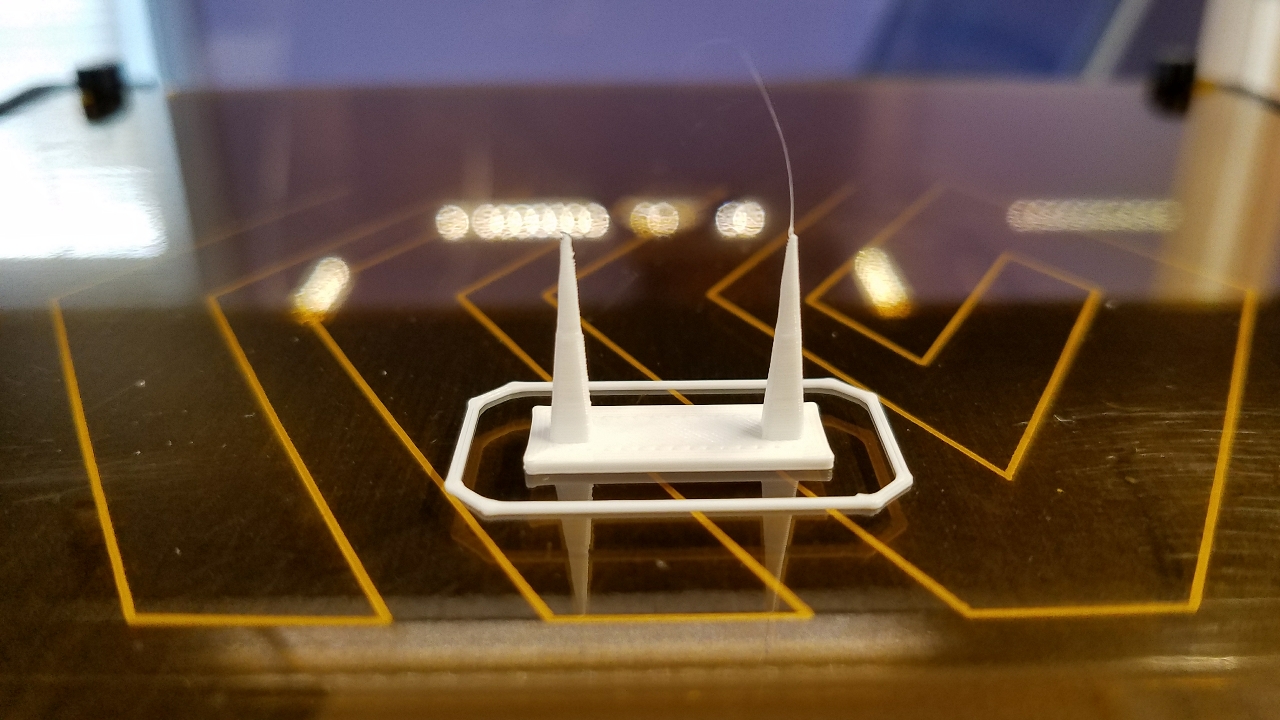

I am about 4 days ahead of you.. I had my white PLA out using it for a few day in about 50% humidity before doing the simple string test model I found online and I has some fin strings.. Cranked the retraction speed way up and was better. I then ordered a Presto Food dehydrator and ran the pla in it over night at 140F. Reset retraction to default on S3D and all the strings were gone..

M2 string test with dry PLA and stock retraction settings Simplifyed3D
