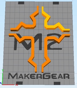

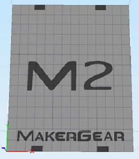

Just for kicks and following Jin's suggestion I modeled the M2 logo on the bed as flat polygons and used the feature in S3D that allows you to include a model on startup. It's in Tools->Options->Machine of all places. I also put in rectangles for my binder clips. You can color the model however you want. Here's what I ended up with:
Here's what it looks like with a model on the bed:
The logo doesn't interfere with slicing in any way that I've seen.
To check registration I also modeled the logo in a printable form and printed it out. Here's a pic of that. It's not 100% spot on, but pretty close.
Attached are the two .stl files: M2Logo.stl for adding into S3D as a background model, and M2LogoPrint.stl in case anyone wants to print it out.
