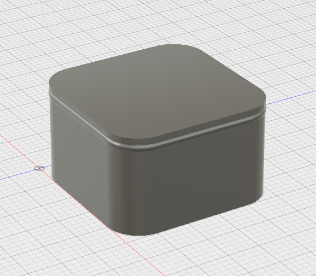

Ok Fusion 360 people - I have a box with filleted corners... I would like to put a bead around the top edge of the box of say 1mm. How in the name of all that is good and holy can you sketch on a curved surface, I need to create essentially a line at 1mm from the top running around the entire top edge of the sides of the box. The sides are easy enough to do - but then I hit that curved surface and I hit a brick wall. This seems like something you should be able to do but
a) The manual for Fusion 360 was written by ... well I don't know what but it sucks
b) I have tried every plane addition known to man and while I can draw some construction lines for a start and end point of the bisecting arc ... I cant get the point on the curve itself correct.
Any ideas would be much appreciated at this point

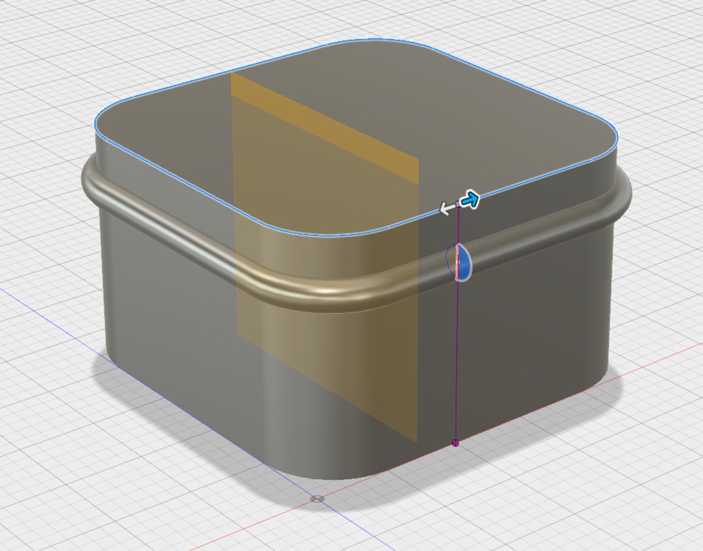

Not sure I understand exactly what you're trying to do. Something like this?
  1. Use Offset Plane under Construct to put a plane 1mm from the top.
  2. Project the outlines of the box to the plane.
  3. Offset the outline by some distance.
  4. Extrude your new sketch by the thickness of the bead, joining to the box.
  5. Use fillet on the top and bottom edges to taste.
An alternative construction that will let you control the profile of the bead:
  1. Construct a vertical midplane between any two of the opposite side faces.
  2. Sketch a circle (or any bead profile you want) on that plane somewhere along one of the walls.
  3. Create->Sweep using your bead outline as the profile and the top edge of the box as the path.
