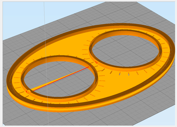

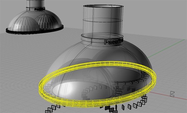

Maybe they fixed it then because in 4.0 there is definitely something buggy going on. I never had a problem until now, but these rounded hollow models are really giving me a lot of trouble. It is not even a complicated model, and I'm stepping through each Boolean operation one at a time and checking it in Simplify 3D to find out which step is breaking it. In the example below, it is the swept edge contour that is causing the leak once it gets merged with the shell containing the outer elliptical housing, floor and two inner spherical shells. The defect shows up better in Simplify 3D, as I can not even see that triangle shooting across the left opening in the Rhino model. I've tried every imaginable sequence of adding these parts together and it always screws up in a similar way. It just should not be this difficult. I've also built this exact same model in a different size using the same method and it worked fine, so it doesn't even consistently happen.

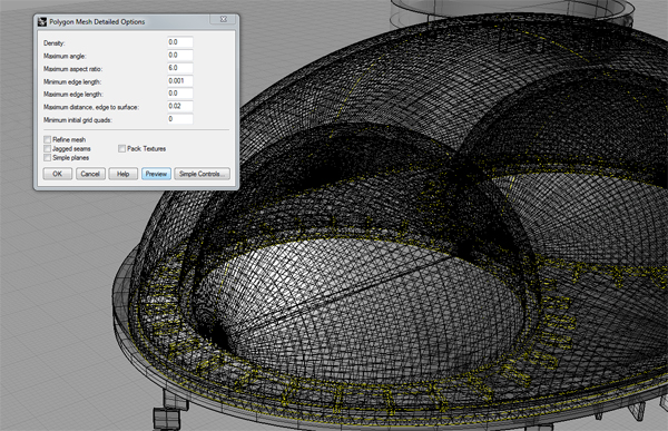

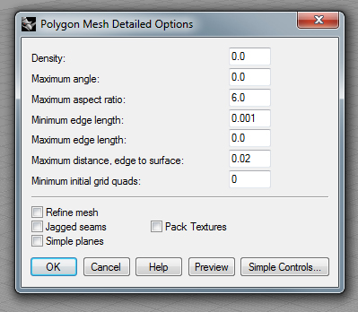

Post by pyronaught » Tue Sep 01, 2015 4:26 am
The absolute tolerance is .001mm and the stl export settings are below. Setting "Maximum distance, edge to surface" from .01 to .02 healed the holes in some cases, but not for this current model. The defect always occurs along the same axis as shown
In the STL preview here you can see the defect sprouting from the point on the inner sphere where all the triangles come together at the axis. This is always where these leaks occur. Note that it doesn't happen on the other sphere, which was created in the exact same way. Also note that the sweep edge isn't included in the model this time and yet it is still happening. This is the random nature of it.
