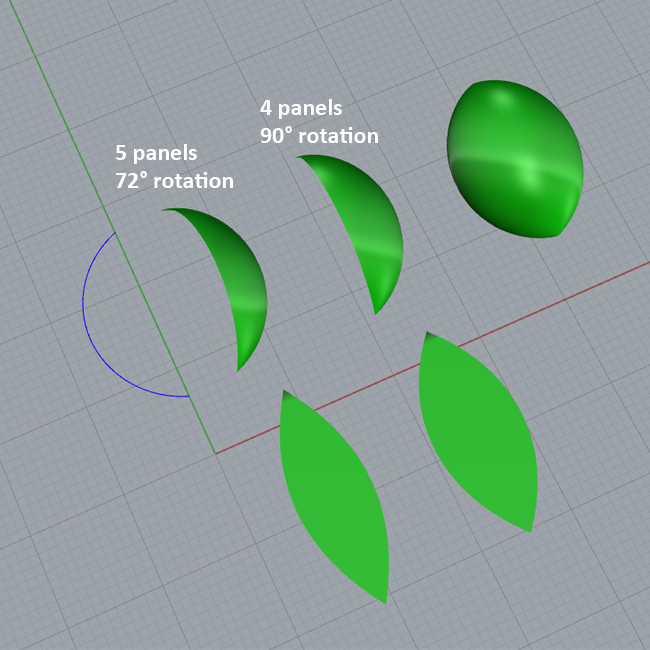

To generate a football shape with separate panels, I would use the Revolve function with a simple arc of varying degrees/shapes. The math generates the panels, the arc dictates the shape. And the end result is going to look the same either way when it's assembled. But the difference is, (if you are using it for a pattern of some kind), the individual panels can be smashed flat and turned into a cutting guide. (The full 360° rotation couldn't be smashed out flat when i tried it.)
Just revolve the arc according to the formula: 360°/ number of panels that you want

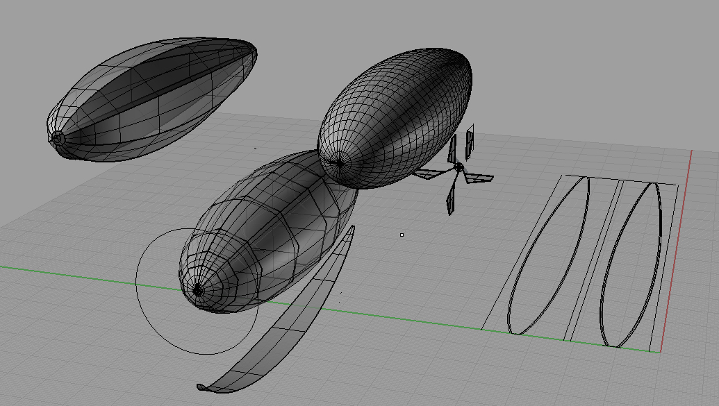

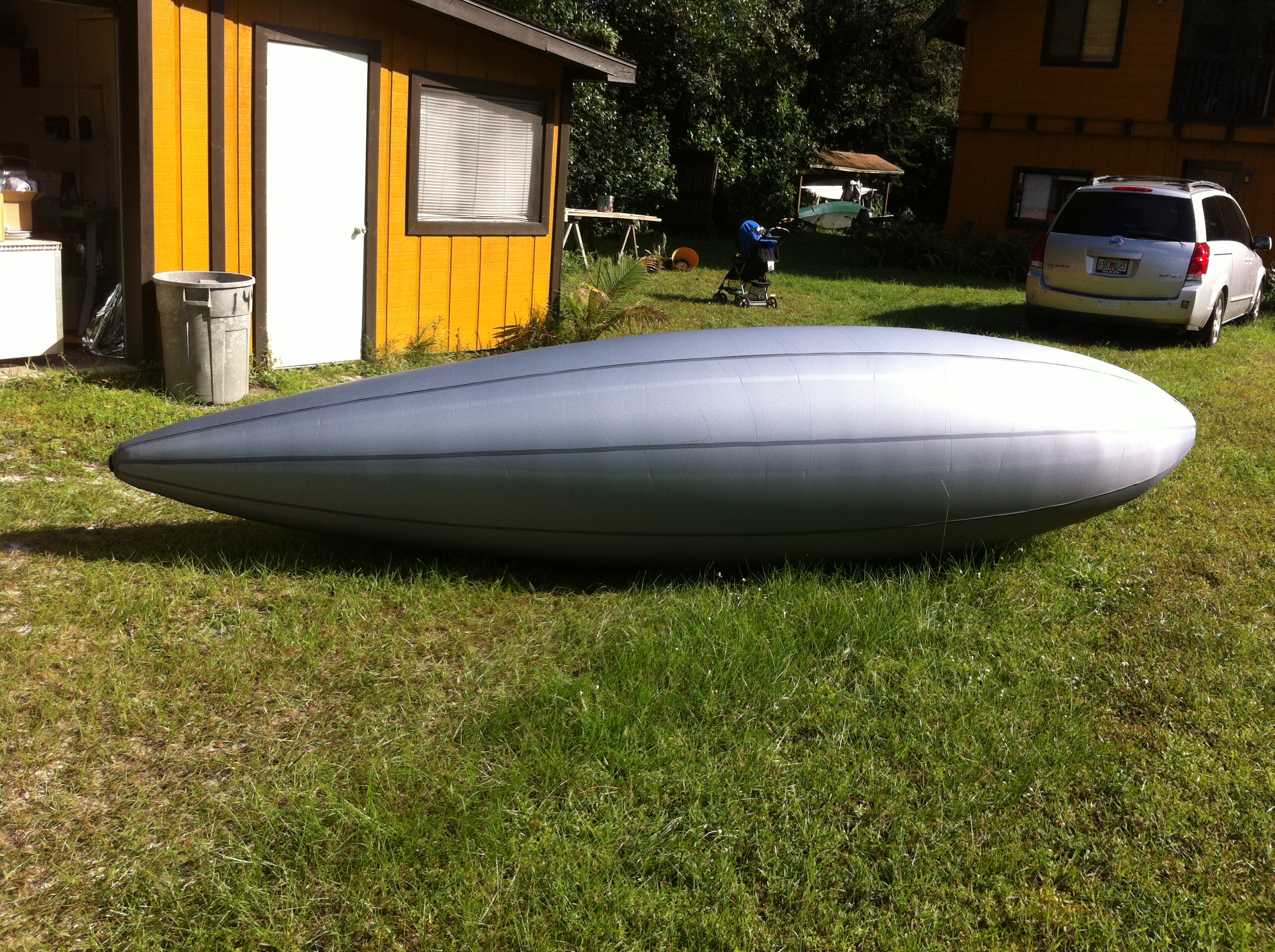

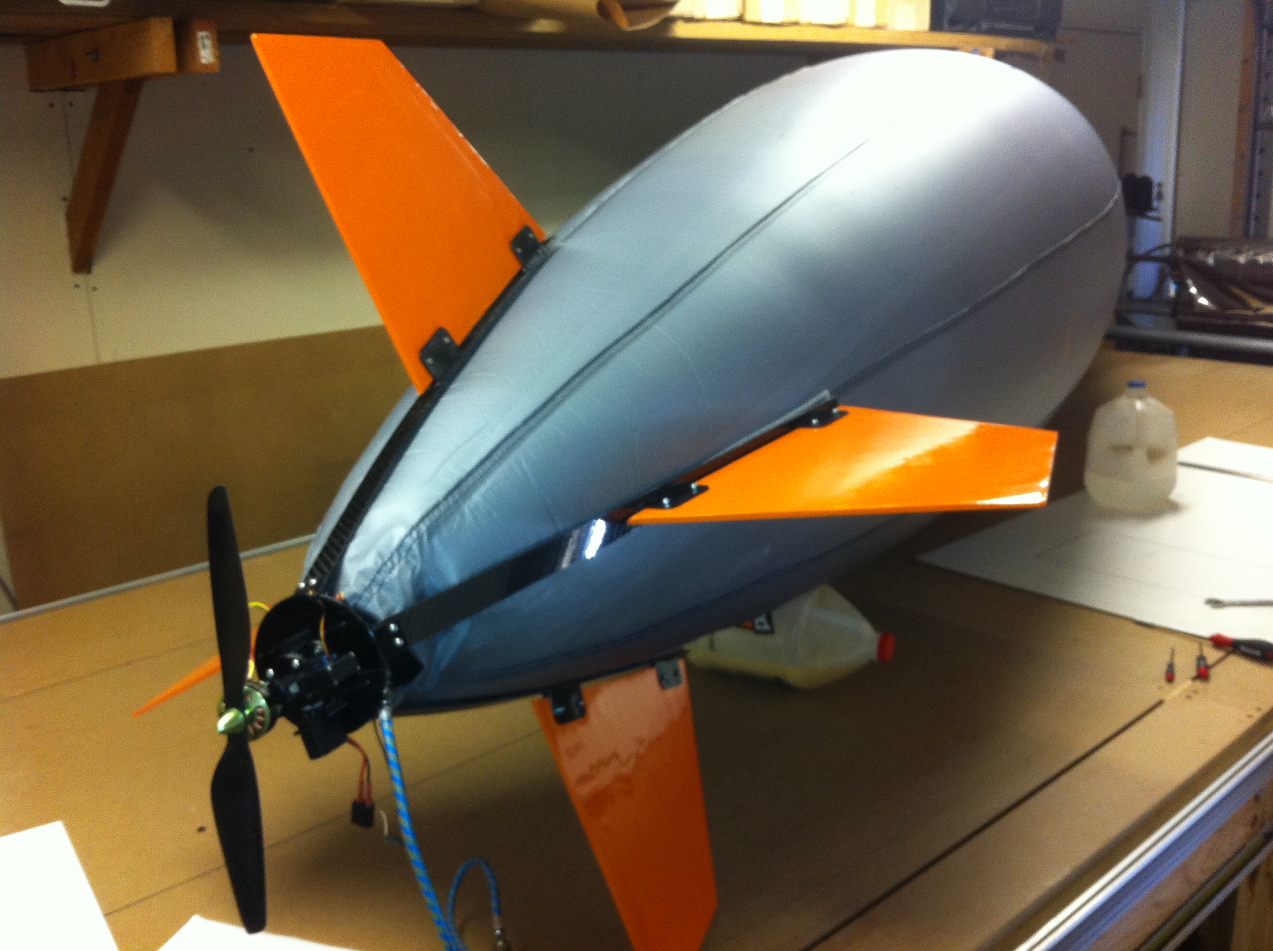

The unroll surface command only works accurately if the surface is curved in only one dimension. So in the case of a foot ball where the panels are curved in two dimensions, you have to choose to flatten one of the dimensions when generating the 2D panels with unrollsrf. When making blimps (same as making footballs), I flatten the short dimension that would normally have a circular arc to it, which results in the object on the upper right in the image below looking like the image on the upper left with the flat faces.
What I'm trying to do is take one of the 2D panels already generated for a blimp designed to use 8 panels and expand the actual blimp being made by sewing in a 9th panel. The blimp becomes unhinged from the 8 panel 3D model at that point, so I no longer know what it's volume, diameter and profile curve is. I did search the McNeal forum and some boat building forums where people want similar functionality for taking hull panels and going in reverse to find out what the hull will look like. No such functionality exists as far as I can tell though. I did find a manual way of doing it though which gets close enough to use. I used cross sections of the panel to calculate the diameters of various bulkheads along the center line, then used the curve fitting tool along the edges of the bulkhead to get the new profile curve. Once I have the curve I can then sweep it around a circle to produce the hull and have the new 3D model to use for volume calculations.
It can be done in software, it just hasn't been done in Rhino yet. The very expensive specialty software used in the textile industry can do it though.

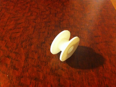

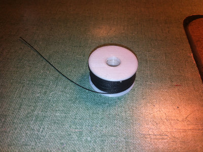

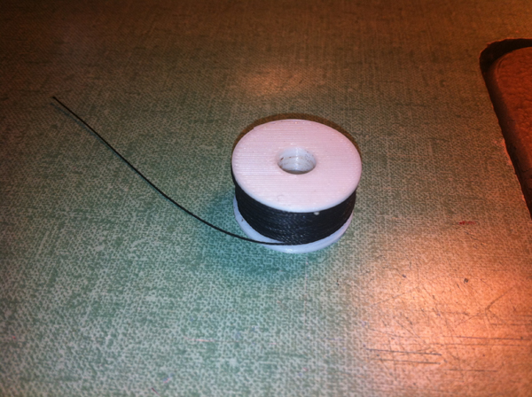

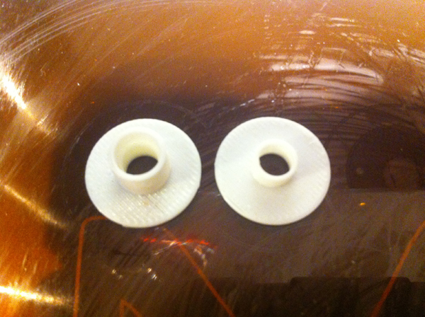

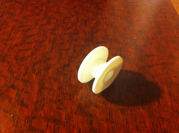

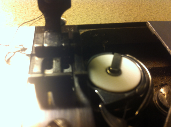

Here's another trivial but very useful 3D printing application I came up with today. After getting frustrated trying to find pre-wound bobbins for my industrial sewing machine, I decided to try my hand at using the fixture built into the sewing machine for winding your own bobbins. A bobbin is just a tiny reel of thread that fits inside the sewing machine and works in conjunction with the main spool. The problem is that since they are small, only 21mm diameter in my case, they run out of thread pretty frequently and you are always having to change them out. If you can find them pre-wound cheap enough then you can find a box of 144 for as cheap as $40, thus eliminating the chore of having to wind them yourself. But if you can't find them, or can only find them at a price closer to $80 then you are paying 55 cents for something that takes you about one minute to spool yourself. Then the problem becomes finding the empty spools, and they are often made of metal and sell for $5 each. You really want to have dozens of these things on hand so that you don't have to keep stopping and winding them as you go. You also can't reload the empty spools from the commercially wound bobbins because they collapse when the thread is gone and are designed to keep you from reusing them (and also to make them cheaper to produce, since the end discs are made of paper and not plastic or metal).
So I decided to see if printing my own spools would work, and turns out it works great! It only takes 12 minutes to print each spool, which is a two piece print that snaps together tight enough to not require gluing. I can print 36 sets on one plate in about 3.5 hours. Now I don't have to worry about sourcing these little bastages anymore

. I understand what you are up to now and love the blimp. The seam geometry for 9 panels would change, especially toward the tips. It is a subtle change, but will happen nonetheless.pyronaught wrote:What I'm trying to do is take one of the 2D panels already generated for a blimp designed to use 8 panels and expand the actual blimp being made by sewing in a 9th panel.
I do have an idea to add a single panel with no math involved. Gimme a minute to draft it up.
