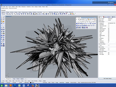

by Jules
Yeah, all part of the learning process. (Should have seen my first few designs in Rhino....they looked like they were all joined up properly. :roll: :lol: )
Wait a minute....I might still have a picture of one........
Spider!

by sthone
Spider? Looks more like your profile pic. :lol: :lol: :lol:
