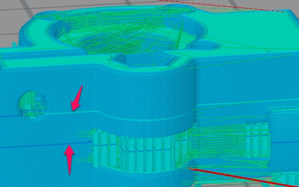

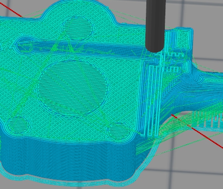

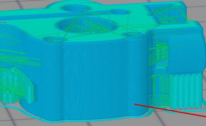

So I was trying to print the Super Filament Path http://www.thingiverse.com/thing:267137 using S3D. I didnt notice it until I was printing that S3D "skipped" a couple slices (or created weird ones) which showed in the preview and in the actual print. In playing around I flipped the piece 180degrees and sliced again and the problem went away. I tried a few different settings but whenever I slice it face down a couple slices in the middle are messed up. If you actually look at the layer that's weird there is something there that appears to be a layer in the holes that doesnt exist in the model or in the print, just the preview. Ideas? First picture is "face up" which sliced correctly. Second one using the same settings but "face down' has two odd layers. Third picture shows one of the odd layers. There is no perimeter or fill, just a phantom layer in the holes where there should be nothing.

That was part 1 of the key jim. I did not have the "heal" box checked (I think it was before I upgraded to 2.1). That issue goes away when that is checked. Funny thing though is that I did run this through Netfabb previously and there were a few very minors issues that I repaired none in that area though. This was the repaired file. Nonetheless S3D found something it still didnt like and I guess discarded it and messed with those layers. However it looks like it created a new problem, it then filled the holes in on layer 63...
Then part 2 of the key came into play from jsc:
Short story, S3D sometimes has issues with model geometry that aren't actual mesh errors. Rsilvers' model was done in solidworks from scratch, and is manifold. I have encountered the same weird slicing issue myself. The workaround is to try to move the layer interface away from the problem geometry areas. The easiest way to do this is to change the first layer height percentage, so if you have it set to 100, try 99 or 101.
After changing my first layer to 110% that additional problem went away.

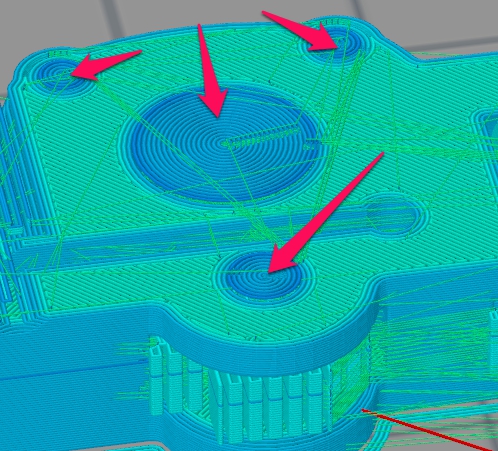

Spoke a little too soon. I printed the part and it did print a single layer over the holes about 60% into the print. I think I'll be able to clean it out and make the part usable but I'm going to mess with it some more to get to the bottom of it. The bad/missing layers issue was resolved however by using the "heal" check box. Printed this with 110% first layer.
