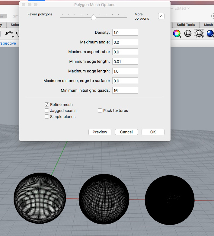

OK, here you go. These are the settings I used to make this 40-ish mm sphere. This list has a setting for metric then an equivalent imperial in size and appearance.
Sphere 1 only has the max edge length setting changed to 3mm. It is 800k.
Sphere 1 only has the max edge length setting changed to .05in. It is 806k.
Totally appropriate size for the M2
Sphere 2 only has the max edge length setting changed to 1mm. It is 2.3 megs.
Sphere 2 only has the max edge length setting changed to .025in. It is 3.3 megs.
This size would be good if there were details and texture on this sphere.
Sphere 3 only has the max edge length setting changed to .5mm. It is 13 megs.
Sphere 3 has the max AND min edge length setting changed to .005in. It is 18megs. You have to change both since you can't drop the max below the min.
You are probably at overkill for the M2, unless it contained exceedingly detailed and specific measurements.
Notice how #2 is starting to look a bit dark, but is not blacked out like #3? That is a good looking mesh that will give you a lot of detail for printing, probably a hair more than you need for a filament printer. It is something you have to get a feel for. #3 might be the perfect setting for a resin printer though.
I learned about these basic settings from tutorials at http://www.infiniteskills.com/training/ ... ino-5.html You really need to sign up for a month and watch them all. Top notch vids!
Depending on your object, you may want to have the "Simple Planes" box picked. It builds planar surfaces with the minimal number of triangles it can, regardless of your settings.

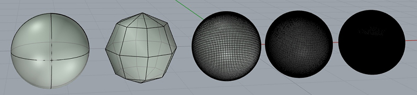

In this pic, sphere 1 is the original NURBS object and sphere 2 is a mesh with min and max edge length set to 1 inch or 25mm. It is a measly 2k!
This is where the cool low-poly stuff starts to happen when you do it intentionally, but it obviously not going to give you a very spherical print.
One thing to note here is that it does not matter if these spheres are 40mm across or two miles across. The deal for 3dprinting meshes, is that they should have that slightly dark look when you pull back from it a bit, no matter how big it is.
You simply go in an tweak the edge settings to get the appropriate mesh density.
None of this is set in in stone, but I have found it to be an EXCELLENT rule of thumb on how to get a starting place for meshes for the M2.
