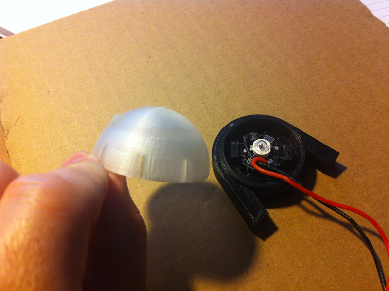

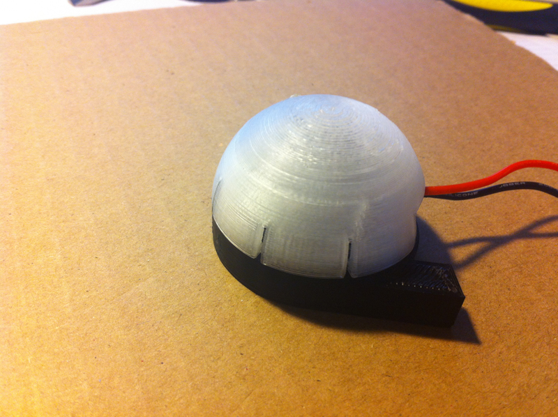

I need to make lots of these though, so they need to be fast and easy. One UFO requires at least six of them, preferably more. I want to be able to just run off a plate full of them over night and have plug-n-play parts the next day. What I wound up doing is increasing the wall thickness from 1.5 to 2mm, then using a manual extrusion width of .5mm to insure no air gaps between extrusion lines. This created a tougher tab, then I opened up the lock rim diameter a little to loosen the fit so that the tabs don't have to flex as much when snapping it on. So the ABS version is working pretty good now, but it will be interesting to compare the PETG version when the filament gets here.

I've found it's not really an issue of layer bonding strength but rather air gaps between the extrusion lines that cause the easy breaks. It's like the phone book trick where you rip one page at a time instead of all pages at once-- the wall strength is only as strong as a single extrusion width when there are gaps between them. Even when the extrusion lines butt up against each other, you still have voids where they curve around at the top and bottom. You have to increase the extrusion width manually to get the lines to squish up against each other so that the voids are squeezed out between them. I'm using an extrusion multiplier of 1.0 with a manual extrusion width of .56 and the tabs are substantially stronger than with my normal settings of .95 and .42 respectively. These settings have to be dialed in for a specific wall thickness, which is 2mm in my case. Transparency also seems to increase a tiny amount with the better layer fills too, probably because the reduction in air voids result in less refraction due to less medium changes as the light passes through. I guess an absolutely perfect fill would be 100% clear, so the opaque fills made from clear filament shows just how far from perfect this type of printing is.

I noticed higher temps help with ABS too. I got the ABS dome light cover to where the tabs can take a fair amount of force before breaking off-- enough force that you wouldn't accidentally break one off unless you were trying to. Here's the key params:
extruder temp: 260C
print speed: 3000 mm/min
extrusion multipler: 1.0
Extursion width: .56mm
coast: 1mm
wipe: 5.5mm
infill 100%
There's still lines through the break face though, indicating that there are still voids. I can minimize voids, but can't seem to get rid of them entirely. Where the plastic breaks the lines are white, while the lines where the voids were are the color of the plastic. Weak settings will show thing white lines and wider color lines, while strong settings will have thick white lines and thin color lines. The ideal settings would result in one big fat white line with no color lines at all, but I could never get there.
