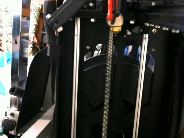

Well it worked fine but the picture is very funny. You cant see the print the way I have the camera setup. Getting a email when the print is done is priceless.

- printDone.jpg (40.37 KiB) Viewed 15750 times
