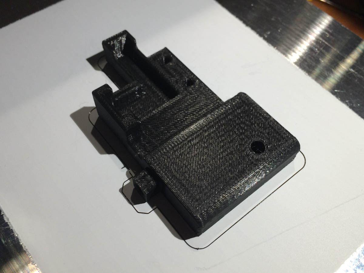

OK... so I pealed the old stuff off. (It comes off pretty easy I just had to clean up the edges with some alcohol to get rid of the little ridges that were left from the tape line.) I spray another 3-4 light coats on and let it dry all day. I set my z height almost to high this time to see how well it would hold and ... it seemed to work great. Even the thin supports stuck without any problems.
It looks like everything printed fine... the adhesion definitely works great from what I can tell so far. The bed seems cool but the part is still stuck on there pretty well so I'm going to leave it overnight to see if it pops off by itself like say glue stick would.
I'll report back in the morning.

Give it a little wiggle if it doesn't pop off immediately - I had a part tonight I had to basically break the seal - so to speak. Tiny wiggle and it came loose.sthone wrote: OK... so I pealed the old stuff off. (It comes off pretty easy I just had to clean up the edges with some alcohol to get rid of the little ridges that were left from the tape line.) I spray another 3-4 light coats on and let it dry all day. I set my z height almost to high this time to see how well it would hold and ... it seemed to work great. Even the thin supports stuck without any problems.

I had to pry if off with a razor blade to get it off and it's hard to see but the peel coat did peel up a little with the part again.
The adhesion is great though even with a slightly higher z height the first layer printed great with no lifted threads anywhere.
I'm not giving up yet... I'm going to try applying it thicker next time and if that doesn't work I'll try a different color. (maybe it's just like filament where white just sucks.

Sorry to hear you are having issues. It could be the white. Ive only tested the bed up to 80 deg so not sure if you are going higher than that.
