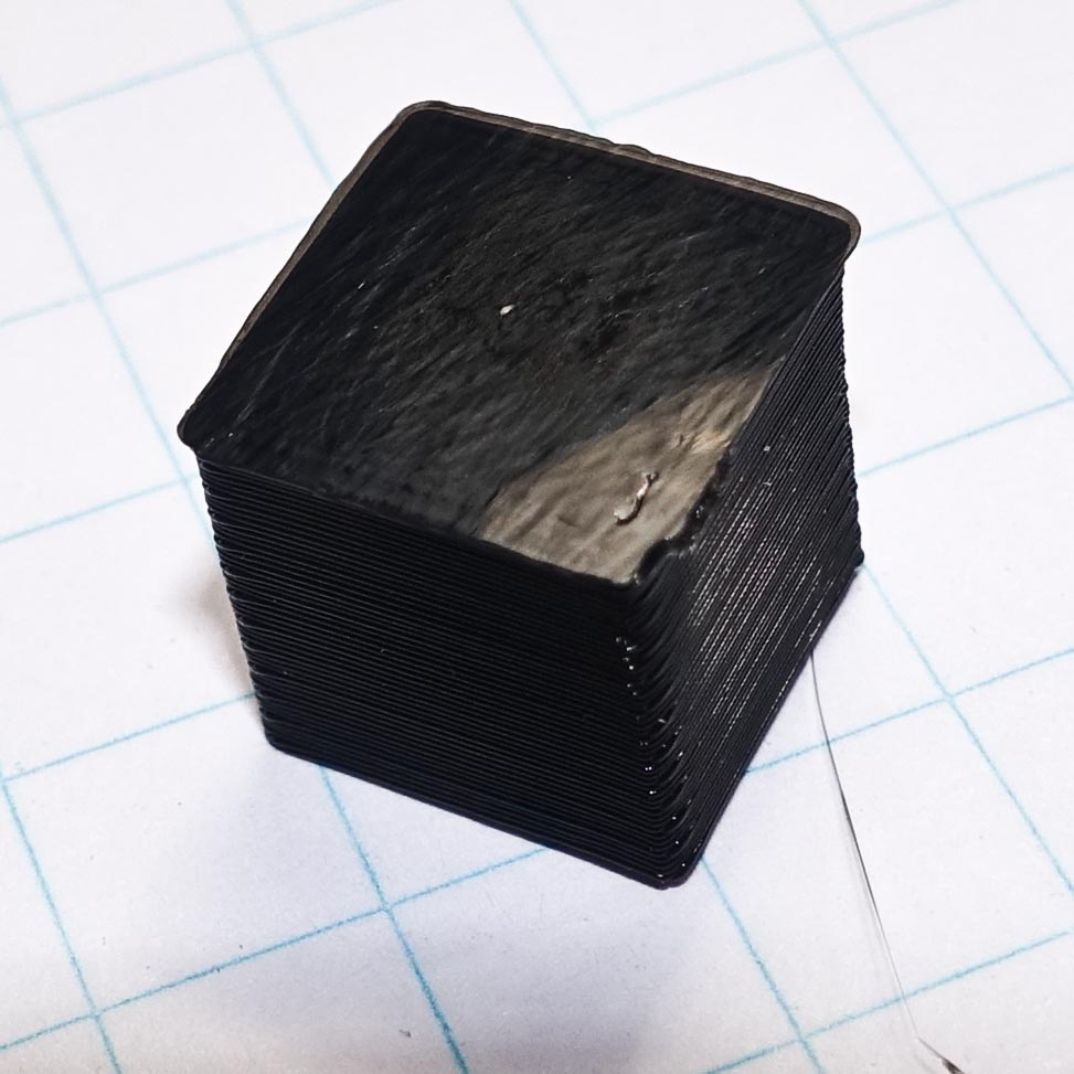

Glas platform can stay in place after print and film is detached.
The film can be bended while the cube stays in place (r~1cm): After bending further than, that the cube came off easily: Bottom surface quality was ok (smoother than my Kapton prints): View from below after bending: According to some posts online the max temp for monochrome laser film is 190°C, this is why I used color film (220°C).
