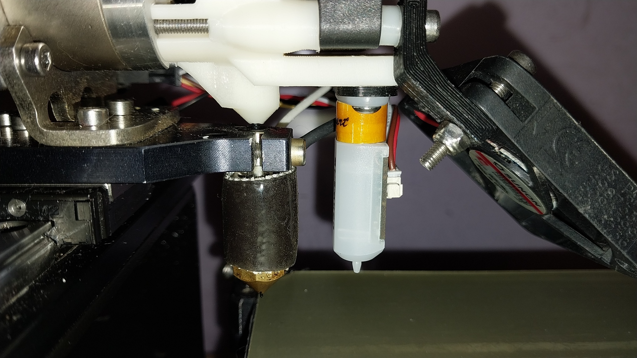

Posts: 605
Re: BLTouch Auto Leveling Sensor
Post by airscapes » Fri Apr 14, 2023 4:00 am
BLTouch installed on my M2 with Duet2 and working. Still have to play with the offset somewhat for whatever reason but the having different height maps at different temps is really nice.. full plate measured every 11mm makes for a really nice first layer. I have yet to try the tapper off option on a taller part. Also using a Build-tak mag setup, and have a plate with their nylon surface, works really well with nylon 910 at 265C hot end and 45 bed no warping, no over stuck, makes me want to buy another roll of 910.. if only it didn't need to be dried for 24 hours before use..
