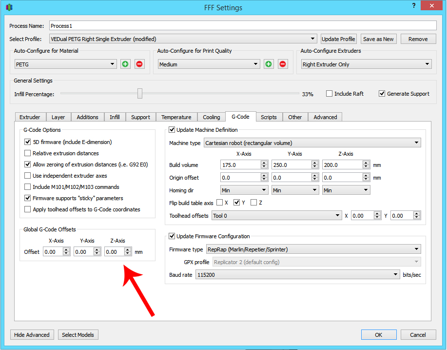

Jules,Jules wrote:
In the G-Code section of the printing parameters in S3D, there is a Z-Offset slot. After I print the first calibration square, I measure the height with calipers, subtract it from 2.0 mm and then enter that number into the Z-Offset slot for that spool. (If the square is not tall enough, you'd enter a positive number, if it's too tall, you'd add a negative adjustment.) A positive number moves the bed farther away from the starting point for the first layer, so that the thread gets laid down evenly instead of getting squished out. A negative Z-Offset adjustment number brings the bed in closer before printing, so that the thread can stick to the plate.
I can't find the Z-Offset slot in the G-Code section of S3D,
is it still there? if so can you please send a screen shot?
thanks
