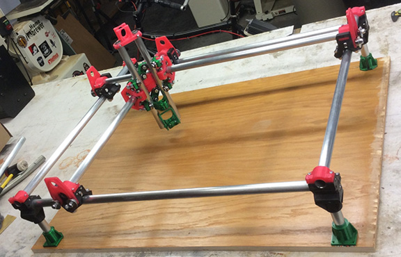

I am calling mine "The Watermelon".
Well over 100 hours of print time. I used PLA (black and pink) and PETG (green). I used a wedge tip soldering iron and PLA filament to weld the joint where the foot meets pipe holder.
This has a VERY heavily designed/built Z axis carriage compared to what you would see on a 3d printer. Can you say inertia? The chassis moves surprisingly smoothly. The PLA keeps the bearings preloaded. I am interested to see how it all works once firmed up and loaded.
So, I just decided to go for the biggest size I thought I might want and scale down as needed. My bars are 30x36" which gives me an 18x24" work area. I am not sure what my working height will be, as I have to get those parts installed, but it's probably 4-5 inches.
Pic 1 is a plain shot of where I am at.

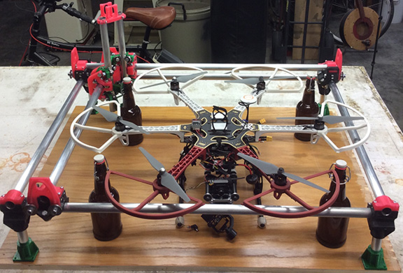

Pic 2 shows the print area holding four 16oz homebrews in the corners and my 500-sized hexacopter.

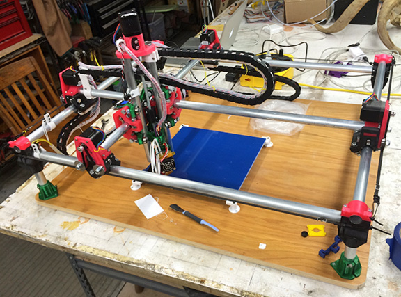

The build is mostly done and working. I can make a passable print but it's not fully calibrated, not does it have the final 18x24" bed yet. This was a pretty cool project. I was really proud of the little 15x15x1mm block that was my first print.
I learned A LOT building my own printer. The first thing I learned is that there is a lot to be said for buying one ready-made. I would not recommend a scratchbuild as a first build. The MPCNC is not really a kit for a finished printer by any means, just a source for some base parts and a set of plans. You will have a lot of assembly, wiring, programming, and testing to do. If you are already successful with 3d printing you will know what it takes to make a decent print via software/machine setup and that will save you a huge part of the learning curve.
As for the actual prints produced, they are passable. This printer shows evidence of Z-banding, and does not the make prettiest surface finish, and does not currently make a print that would be worthy of comparison to something off my M2. Not. Even. Close.
That being said, it does as good a job as I have seen on other lower-end import/homemade printers. I expect improvement as it gets dialed in, but this is just a chassis and motion control system issue. It is a flexy chassis running bearings in PLA mounts on EMT rails and a "meh" extruder. You just aren't going to make this thing print as well as a higher end model, no matter how well-tuned the firmware/software is.
Now that your expectations have been lowered some, keep in mind a cube that looks a bit wonky in white filament at 15 mm will look WAY different at 450mm in a translucent or clear filament. Similarly, a jump from a .40 tip to a .80 and layer heights from .25mm to .60mm will also change things as well. I have not reached that part in my testing, but I have hopes that when this machine is printing items designed for its huge build volume the .1-.2mm errors it currently exhibits will become less apparent.
Time will tell, but for now this is what it boils down to this- M2 vs. MPCNC = Scalpel vs. Shovel
