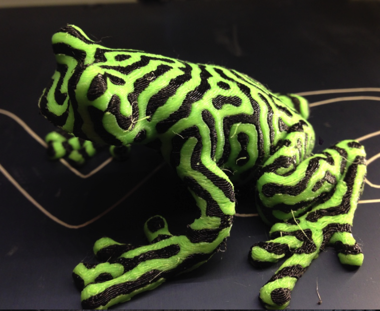

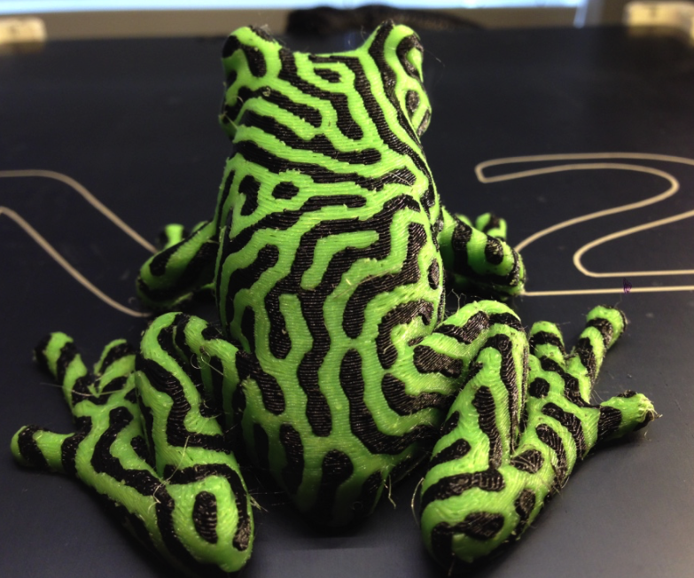

I am glad they finally updated and added much needed support. Here is my Tree frog done with simplify3d v3.0.

Now that IS nice! (Get some XTC-3D on that frog - it'll look like the real thing!) :D

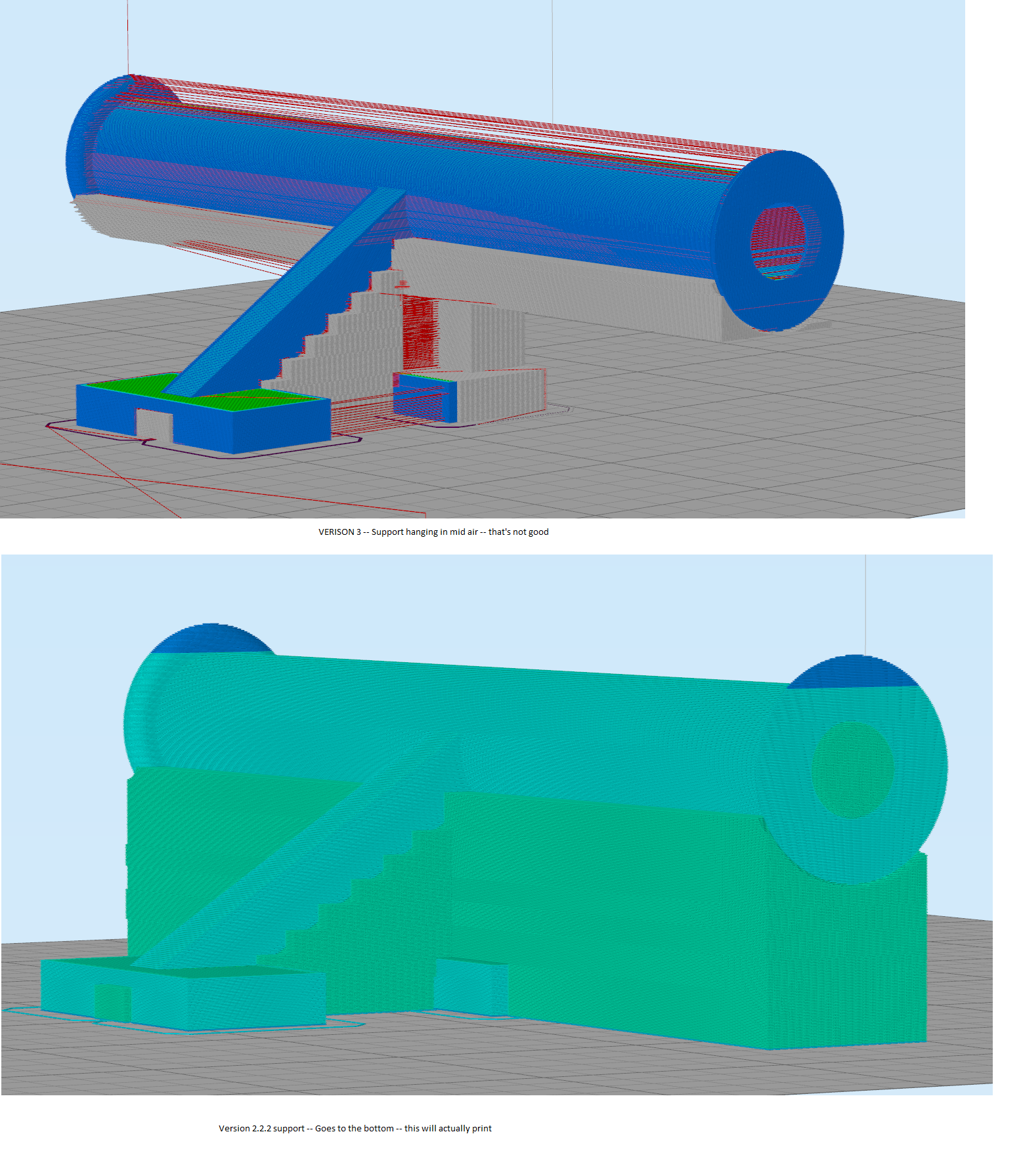

ok, support inflation distance is broken between 2.2.2 and 3.0 -- it does what it should in 2.2.2 -- and support comes out wonky in version 3.0 -- it decides not generate it in places where as version 2.2.2 works fine ...
See attached image.
I am glad they added dual extruder support and when I make that upgrade I may start using it, but it appears to be broken to me for normal use
