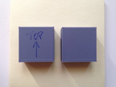

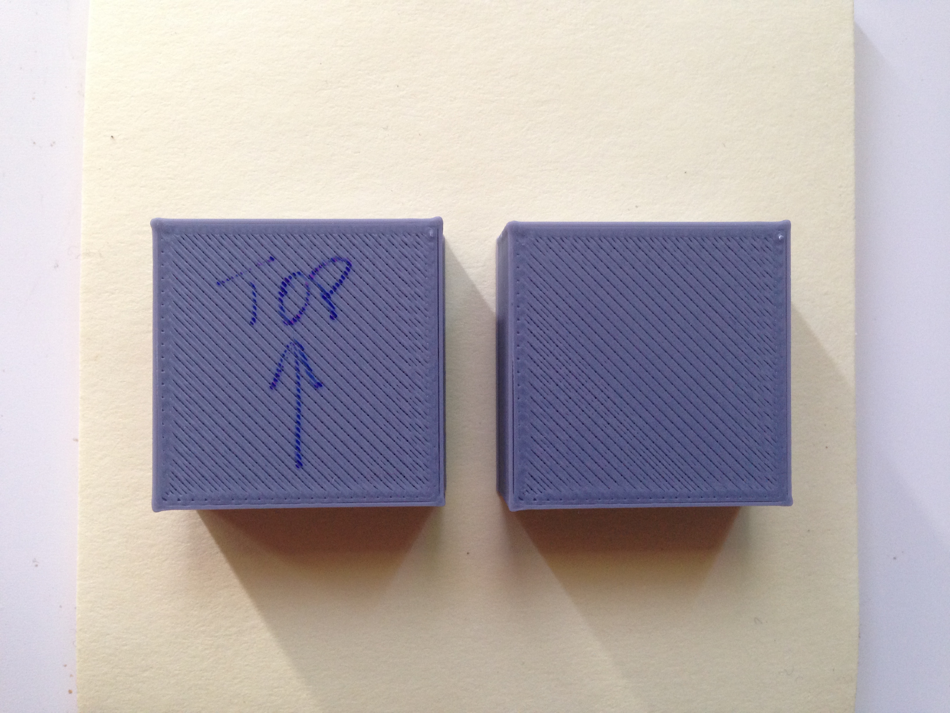

Finally got more time to work on this. It's is both interesting and frustrating - I pulled my .50 nozzle and threw the .35 in to try and get this thing dialed in with a more commonly used size. Burned it out with a torch just to be sure it's clean and clear.
My results are better. What is odd though is that my multiplier does not seem to be doing anything. Dimension-wise, I am rather happy with things coming in +/-.02mm or so. But to try and fill in the gaps and connect my walls, the extrusion ratio seems to be doing nothing. The cube on the left is printed at .92, the one on the right at 1.04, and they are for all intents and purposes identical. Same gapping in the top layers; same perimeter wall separation. Any ideas..?
Settings:
Temp: 210
Bed: 60 (on Buildtak)
Layer: .20
Extrusion Width: .40
![IMG_4498[1].JPG (1.88 MiB) Viewed 19495 times IMG_4498[1].JPG](./download/file.php?id=3977&t=1&sid=f5859cbd1f6c1c042fb126c9c0dd9037)
2012 M2 V4-PTFE
- Posts: 3144
Post
by Jules » Sun Jul 17, 2016 7:48 pm
After I switched to using a Dual extruder, I also discovered that the extrusion multiplier actually does very little in S3D.
(So now I just leave the filament diameter at 1.75 mm, and the extrusion multiplier at 0.90, and I get perfectly acceptable results.)
The only things I can suggest is that you are still just a hair too far away from the bed with the nozzle. (Might try shifting your Z-Offset number by
-.04 mm to bring it closer.)
You can also adjust the first layer
width upwards, but that's only going to impact the first layer. And make sure the Infill overlap amount is set to about 15%.
Other than that, I have no idea what to suggest. It's a puzzler.

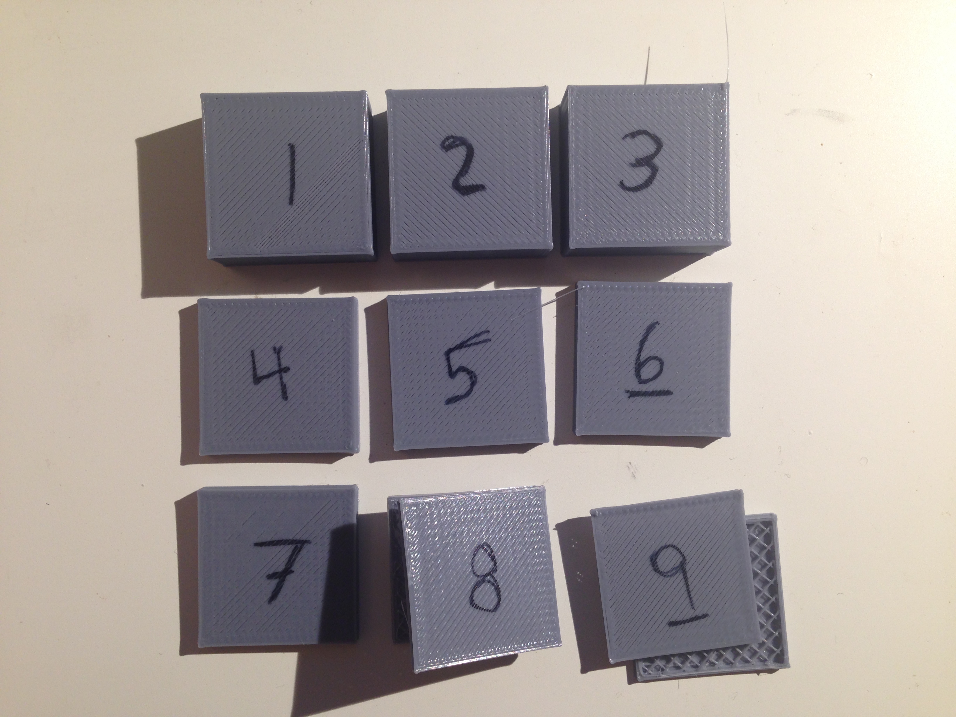

More cubes. This time I adjusted the filament diameter down, starting with the actual measurement of 1.74mm. 1-3 I dropped it .01mm each cube. Not noticing much difference, I ran 4-6, and then 7-9 at .02mm increments (but reduced my overall height from 10mm to 3mm for faster testing). #9 was set for 1.58mm filament. Virtually no change in the top finish if it's hard to tell, and X/Y dimensions on 1-7 are identical - 7's sidewalls were kinda wonky, but 8 and 9 looked pretty bad and were barely holding on, both popping in halves as I took them off the bed.
Time to try different filament...? Now I am really getting stumped.

The way that S3D describes it as working, is to leave the filament diameter at 1.75 mm, and start increasing the extrusion multiplier to increase the extrusion.
For PLA, the multiplier is normally about 0.90, so you would increase that to say 0.95 and go up by a couple tenths each time.
Actually, one other guy was talking about a similar issue this morning - everything was set correctly, but his prints looked identical, with spots where the extruded thread thinned out.
What's your infill width set to?

Right - well my multiplier manipulation wasn't seeming to do anything (adjusted between .90 and 1.06) so I tried to make changes via filament diameter to see if I could get the sidewalls and top layers looking better. I just ran the 7-9 set again, and #9 only made it 1/3 of the way through before it just stopped extruding; I tried increasing the filament tension and apparently it stripped.
Infill width is set to the S3D default PLA profile - or I think at least - 100%.
2012 M2 V4-PTFE
- Posts: 3144
Post
by Jules » Wed Jul 20, 2016 5:06 am
You could try bumping it up (Infill Width) by about 10% and see if it makes a difference. (Aside from moving the first layer closer, I'm out of ideas.)
(Did you use the Filament Tension setting guide to set the tension?)
