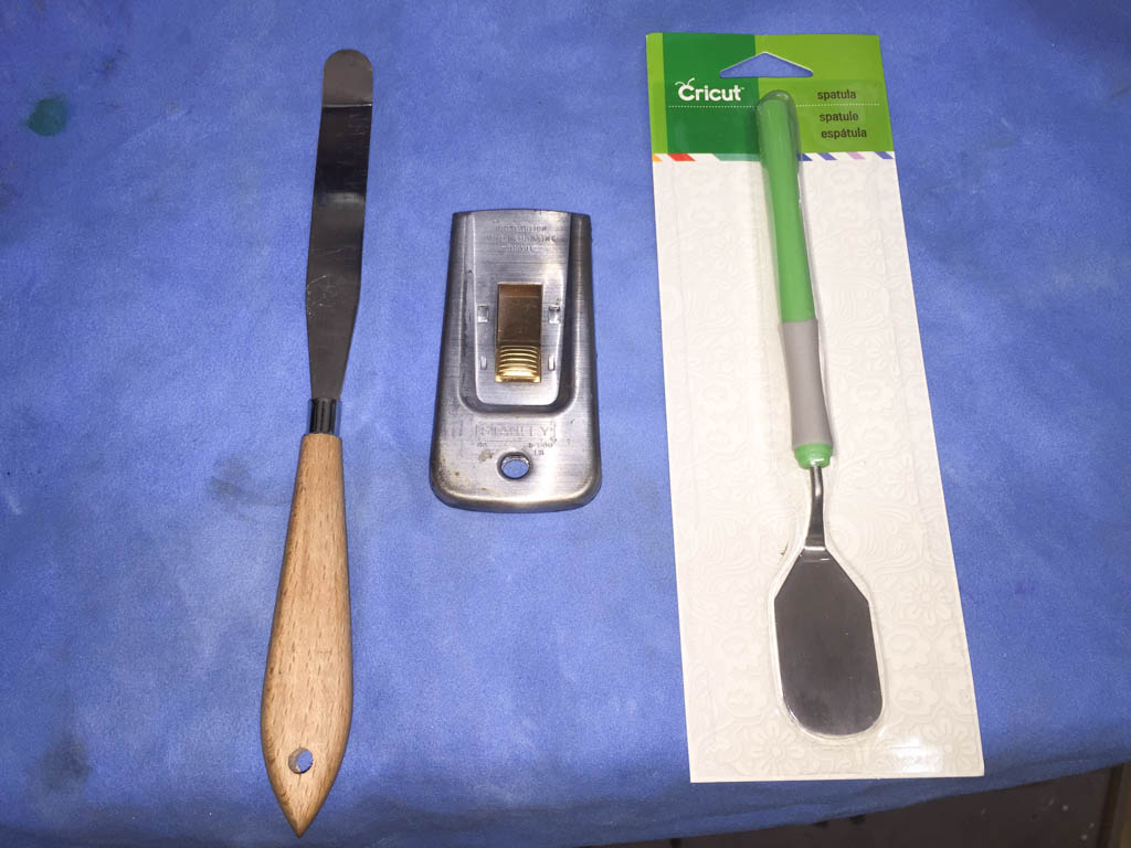

Here's the tools that have been working pretty good for me, at least with PLA and ABS. I use Purple Elmer's stick so these may not be good to use with tape, would probably scrape it.
The one on the left is my favorite. Found it on an online hobby shop but I can't remember the name will have to try to see if I can find the receipt. I use the razor knife to open up a gap then I insert the long skinny spatula and just push it in as far as it will go, move it side to side, then push it in some more, and so on and so on.
I've only had a couple that wouldn't budge at all. By the way, this is after I've broken two glass sheets since I got the printer, but haven't had any problems since I started using these. Anyway, like I was saying... I've only had a couple that wouldn't budge at all. On those I use the freeze spray used to troubleshoot electronics. I don't blast it on to the glass but just gradually spray the whole glass, wait a little spray some more and as the glass starts to contract the piece will usually just pop off. Other option is throw it in the freezer which I've never done, but same thing.
EDIT: Most important thing is always let the part cool down completely, hot parts not likely to come off easily.
The left one is my favorite as its almost paper thin. The one on the right was recommended by someone on this forum and works great, but its kind of short.
2015-02-19 23.09.05.jpg (126.83 KiB) Viewed 11953 times
