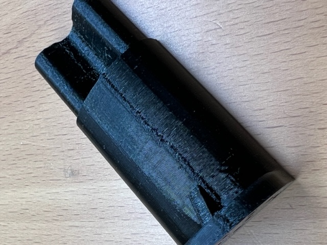

In the past, I have only printed PLA. My M3-ID has always printed it great with very little tweaking. I know, its the easy stuff....
I have started using some black PETG for some parts. I've got the temperature where I'm getting good adhesion and stringing is manageable for these parts at 235. However, I can't get rid of the seam on the side of the part from ooze where it starts and ends the outer perimeter on each layer. Also, a bit of bulging on sharp corners. Looks like a nasty scar going up the part. I've tried dialing up the retrack distance to 6mm with no affect and also the retract speed to 2400.
Can someone tell me what parameters I need to tweak and/or share their successful print settings for PETG. I am going to try the ooze shield next, but it's a pretty good size part and I need to print a lot of them. I'm also doing one at a time to eliminate strings between parts but would like to print multiples in the future.

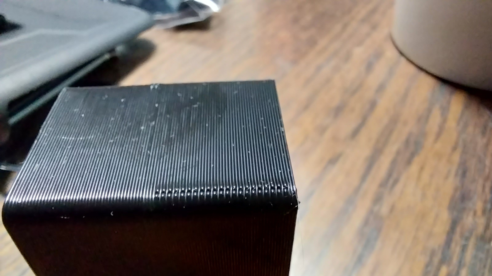

Hi! That looks like the Z seam and you really can't get rid of it. You can tell the slicer to put it in a certain location, like a corner rather than the middle of the curve. You may be over extruding a bit as well. You may want to drop the temp to 230, at least that is where I get best pet prints with my M2. I will not change the z seam but my give you a better surface.
The seam is just part of the process, I have never been able to eliminated it and still keep the integrity of the part. You can't move melted plastic to the side and then up and not have a seam..
This is an abs part laying on it's side to show the seam better.. this is a good print as far as I am concerned.
