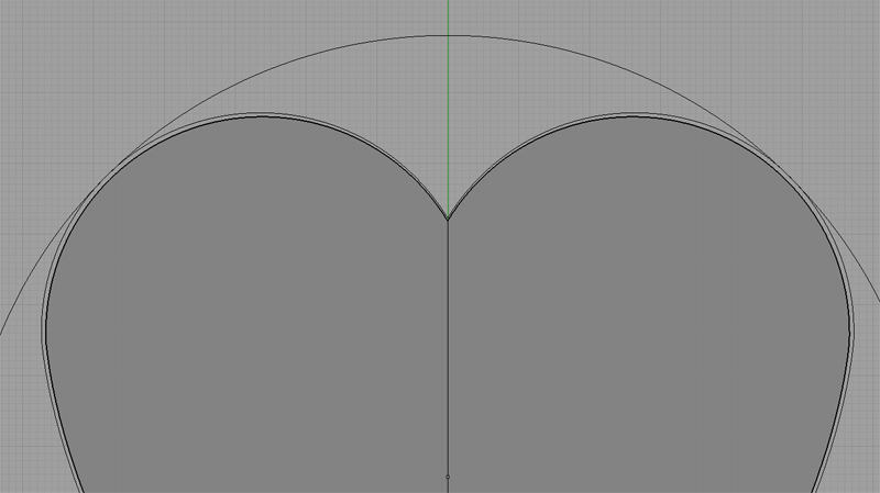

Using Rhino 3D, does anyone know how to take a closed curve and convert it to a solid extrusion which has a consistent wall thickness around the entire perimeter? This is easy for things squares or circles that have symmetry around the axis of extrusion, but not with shapes like hearts or rectangles because they don't scale equally in all directions. With a heart shape for example, you can't just clone it, 2D scale it slightly smaller and Boolean subtract it from the core of the original and have the same wall thickness around the perimeter of the resulting object because the heart curve will not scale equally in all directions from its center point. I'm using the area centroid finder to pick the center point of the scale operation but it just doesn't produce a second inner curve where the distance to the outer curve is exactly the same around the entire perimeter. Note in the image below how the area where the two curves come together have a narrower separation than other parts of the curve. I've had this same issue trying to make fabric seam allowances on rectangular balloon panels too-- you just can't create a copy and scale it around the center point, it won't produce equal expansion from the original edge at every point. Is there an easy trick for doing this?

PcS wrote:Couldn't you just 2d or 3d scale the object ?
The image above is what you get with the 2D scale. The distance between the inner and outer perimeter are just not equal at every point when doing it that way, except in the case of a circle.
