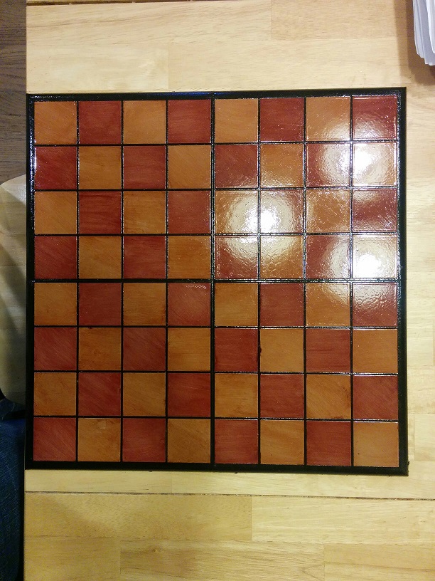

Needed a chess board to go with the steel and bronze chess pieces. Didn't like any of the available models so designed this one. Printed in hatchbox wood (my new favourite filament) and then stained and coated with several coats of shellac.
While not 100% happy with it I think it turned out ok.
Seriously though hatchbox wood is amazing stuff.

Cool difference in color I got 3 new wood filament i will add to my test after Thxgiving
Re: Chessboard - test of hatchbox wood filament
That's gorgeous! (I'm gonna have to get some of the Hatchbox wood.)

Sweet stain work.

Very nice work !!! I bought some hatchbox wood filament upon the recommendation of this forum and have been playing with it as time permits. Seems to print nicely have not gotten around to finishing any of it yet though.
What size nozzle, temps for extruder and build plate? Thank you.,

Pretty much what Pekish recommended.wmgeorge wrote:What size nozzle, temps for extruder and build plate? Thank you.,
Hotend 215
Bed 60
65mm/s
0.40 Nozzle
0.200 layer
