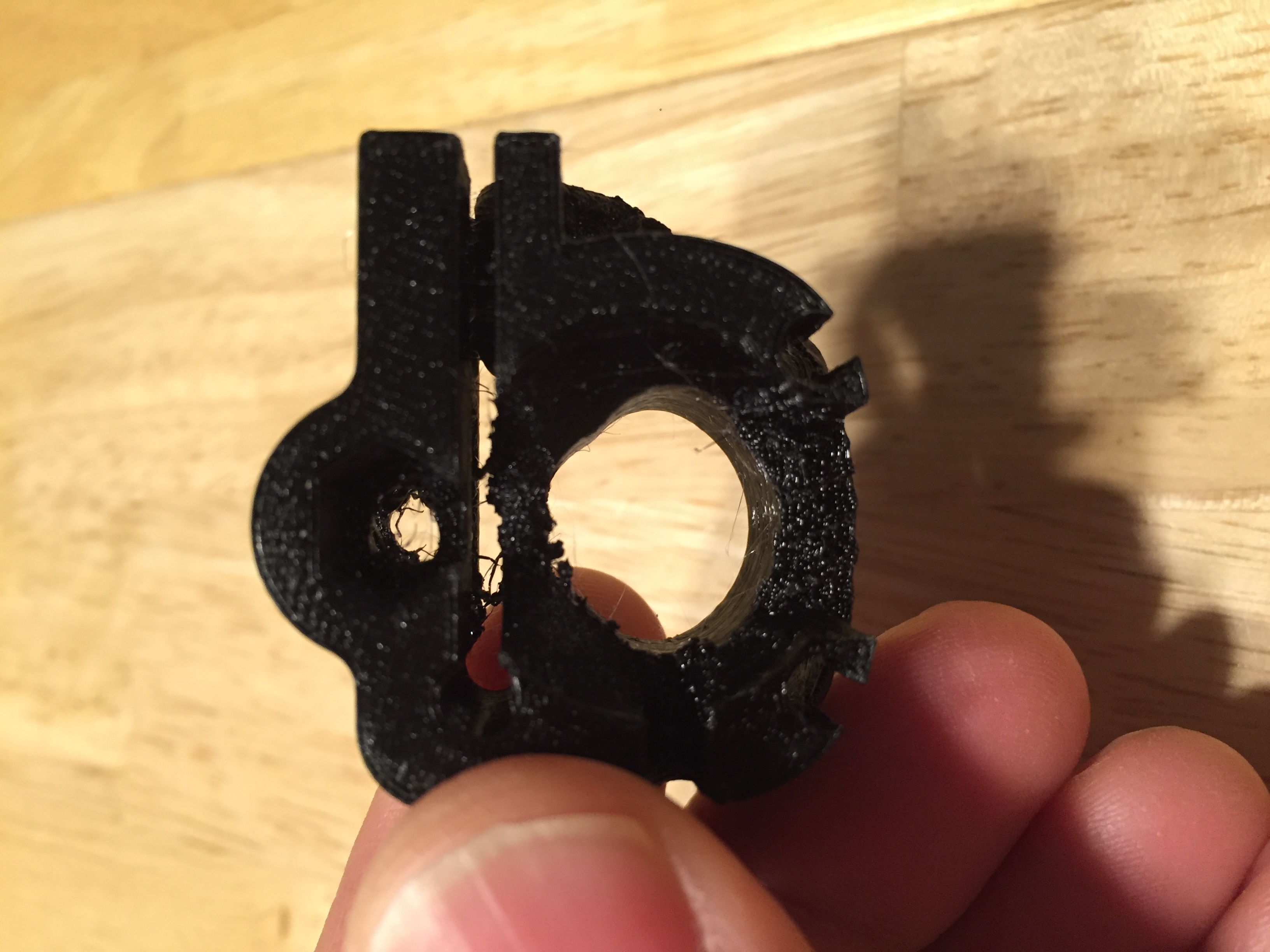

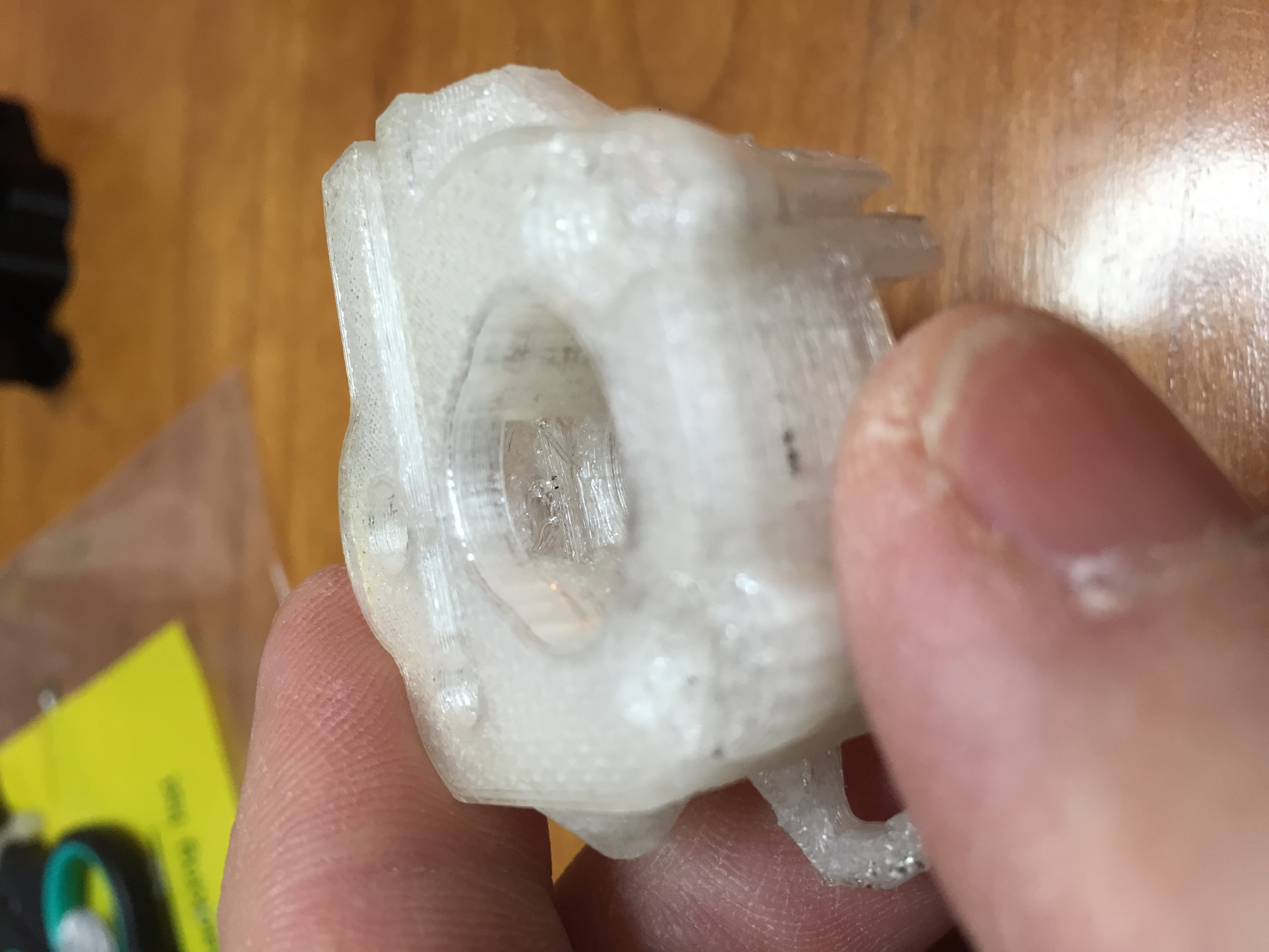

I took a crack at printing my first backup part last night. It's one of the filament drives for the dual setup.
I printed it in PETG for now as a test, but will likely look to print the parts in ePC as per JimC's recommendation...I know the Makergear parts are printed in ABS...
I printed this at 93% infill.
Here are the questions I have:
1. Did this part come out usable? There are some "fuzzy" areas to the print
2. I let S3D generate support (i removed 1 or 2 generated pieces), but should I have generated support at all? (I'm sure it affects the fuzziness mentioned above...should there have been more support??)
3. Can I export the parts with support in S3D for later reuse, or is that a waste of time?
4. When looking to bore the holes with the bits described on the forum, do you bore them by hand?
5. Any other recommendations to printing these replacement parts?
Thank you!!

1. Maybe, with cleanup, but it could be better.
2. Yes, but remove supports from the small bolt/nut holes if generated.
3. Yes, you can save it as a Factory file in S3D, but you aren't probably printing LOTS of them, so is not hugely important.
4. I usually just use a hand-held drill to clean up the holes. If your printer is working correctly, your holes should just need the slightest reaming to size. The bit will practically center itself when done carefully. If you have to use force or resize a hole, you might want to use a drill press. To much force or speed creates heat and melting, which can throw your drilling off. I use a slow speed and will pulse the trigger to keep the heat down.
5. Most of your issue on this print seems to be caused by PETG inherent "stickiness" which makes printing with supports a bit tricky. They can become difficult or impossible to remove without damaging the print. A switch to ePC or something similar will improve how the support breaks away and you will get a cleaner print.

1. I'm not so sure - there's an area in your second pic where it looks like the structural integrity of the part might be compromised. (Also might just be the angle of the photo....hard to tell.)
2. I have always had to generate manual support for the drives. i prefer to put more supports in there, (where the software doesn't always think it's needed), but it helps with that bird's nest underside on the curved bottom surfaces on the interior.

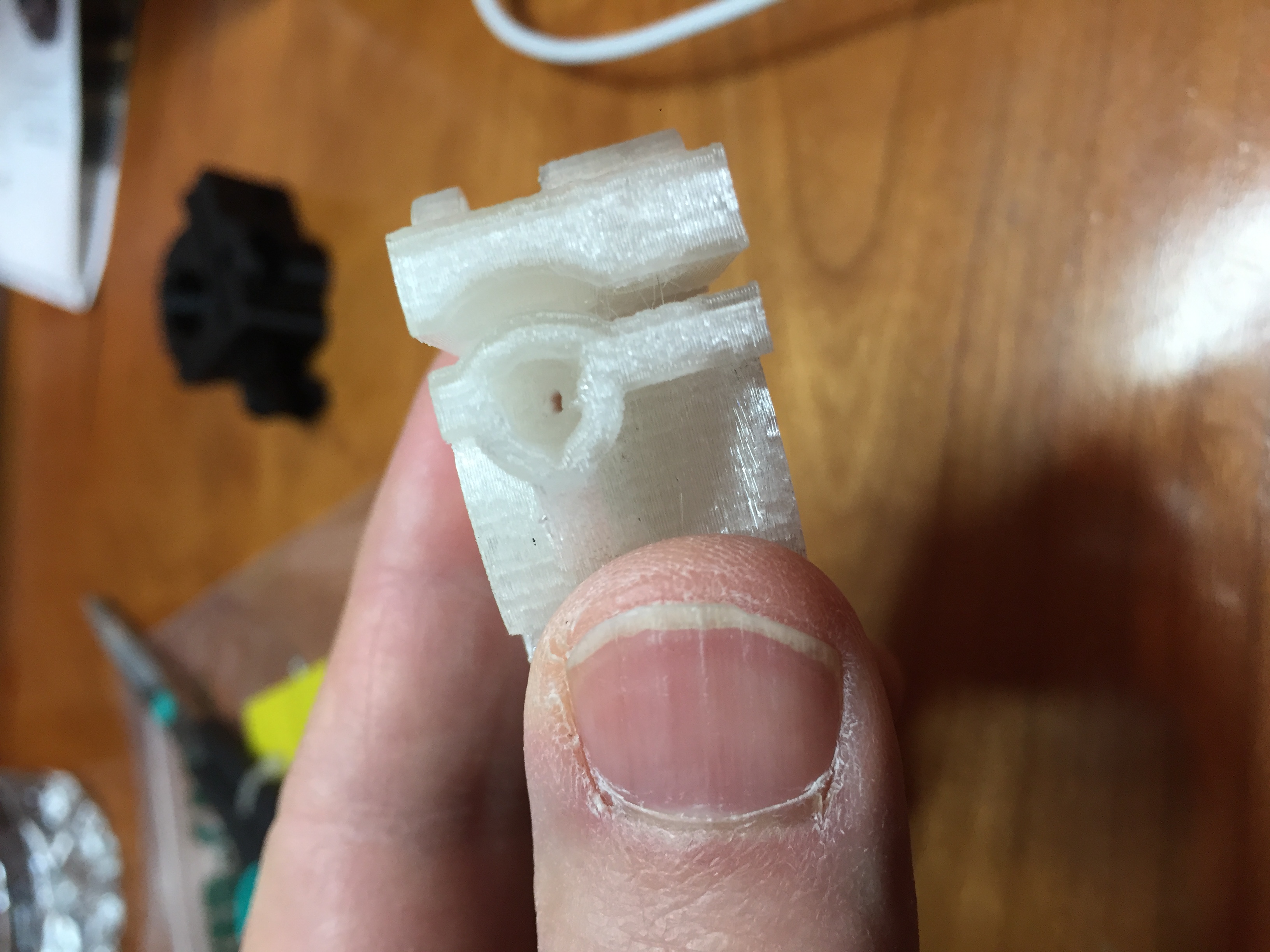

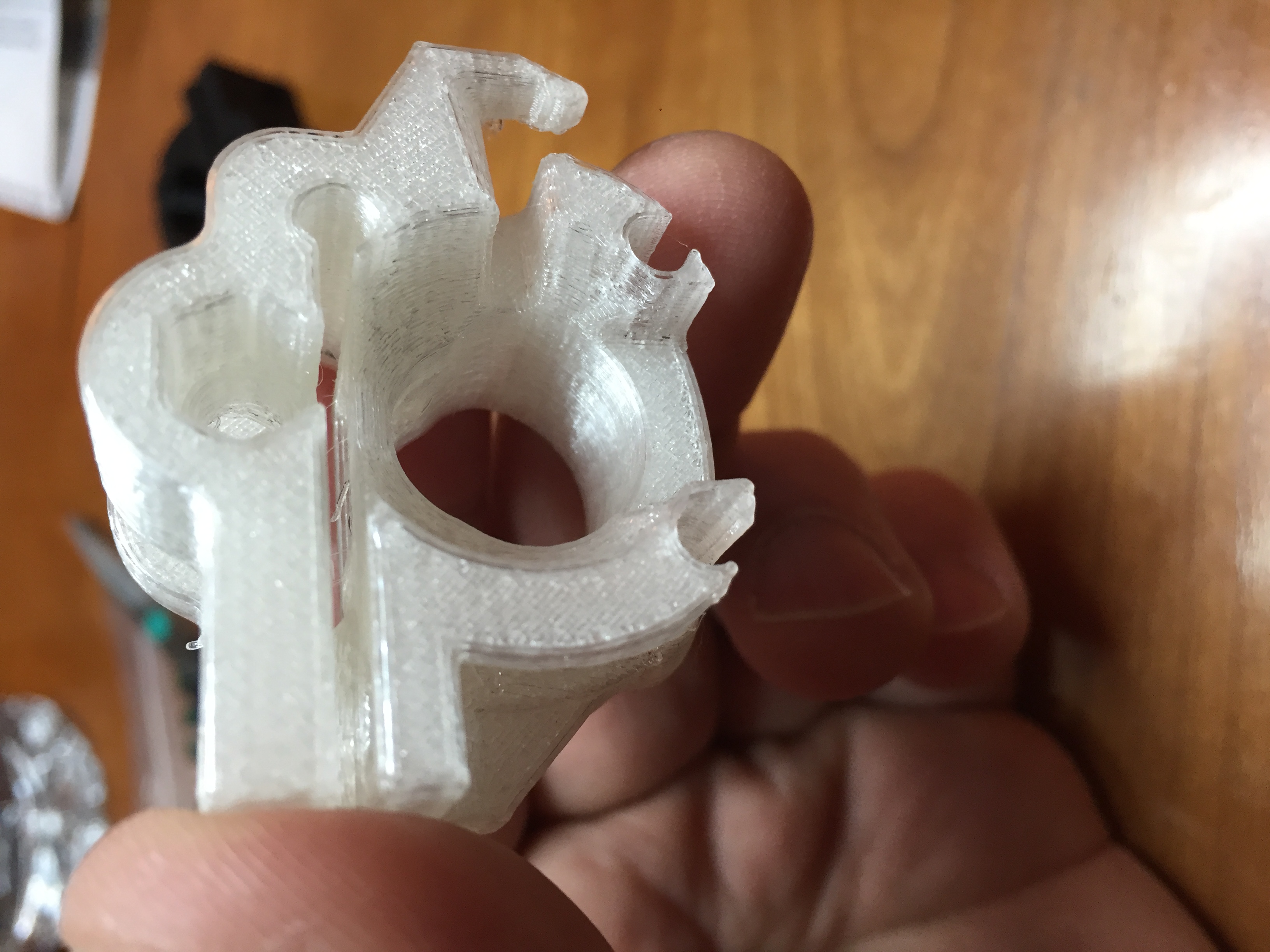

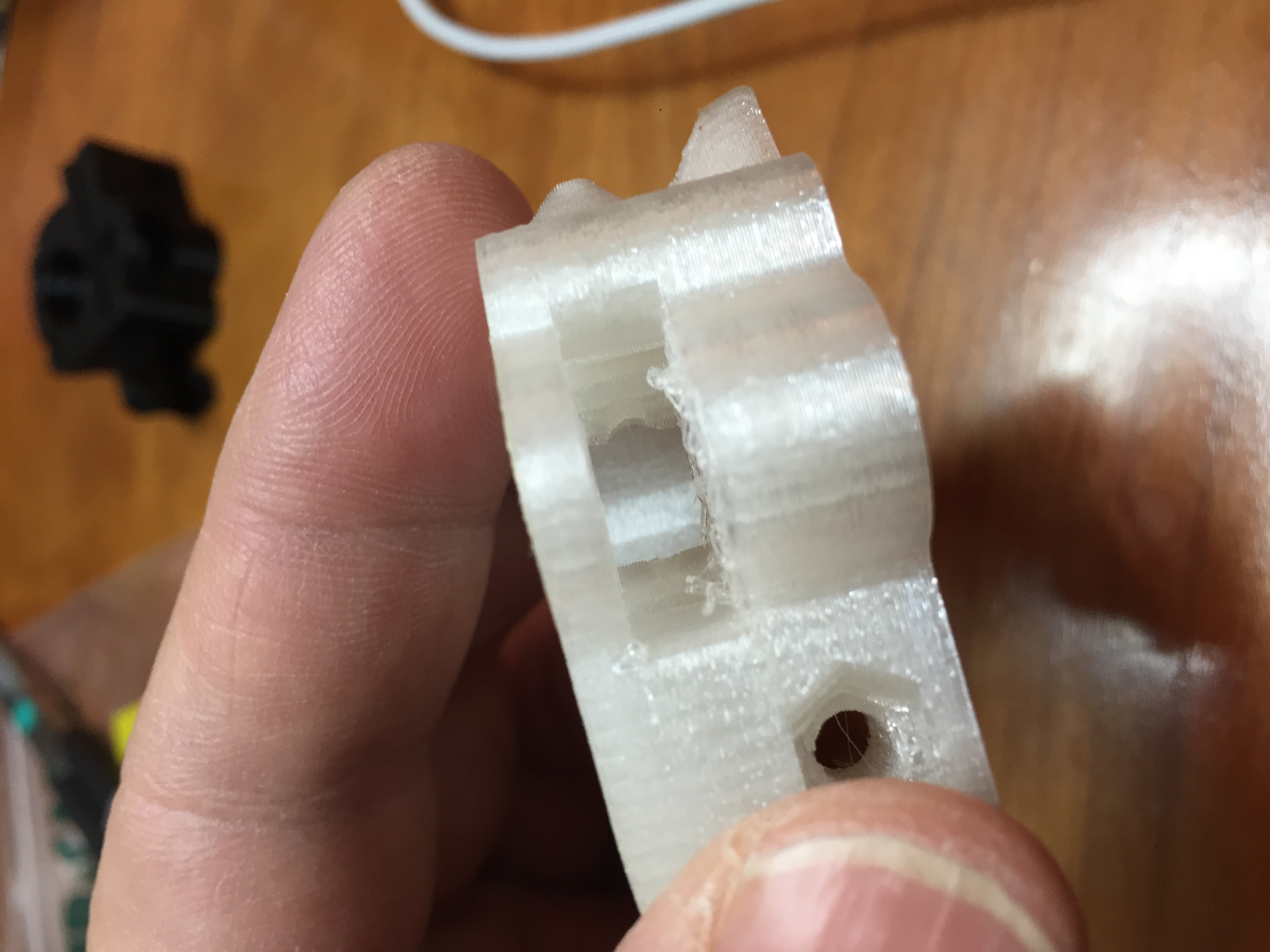

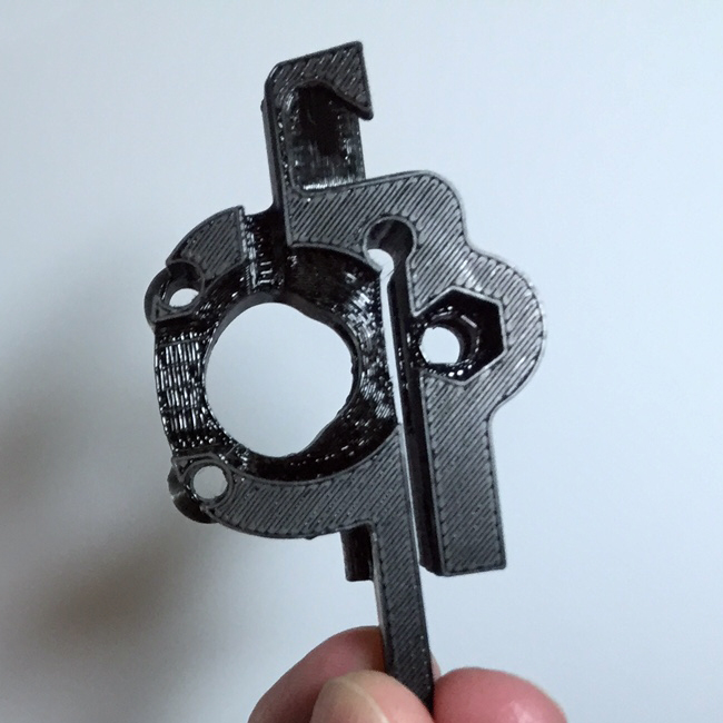

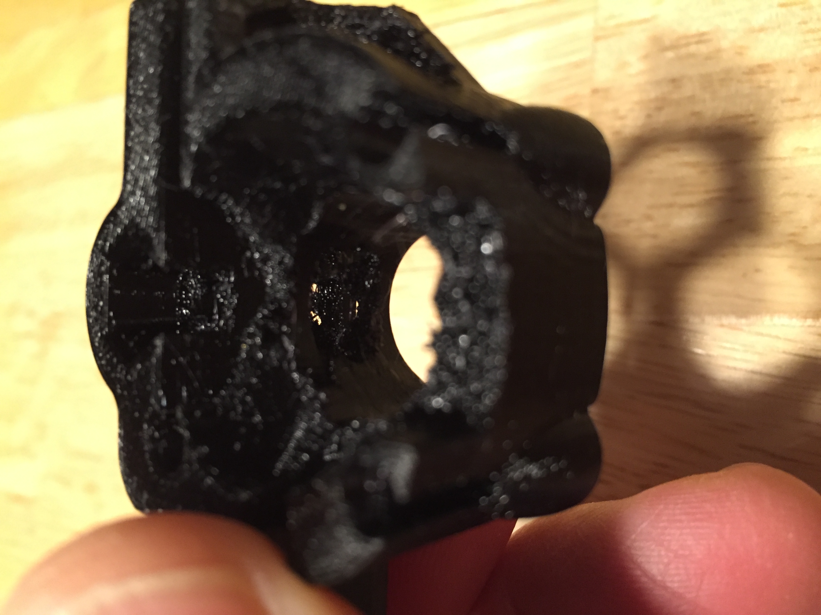

Here's a similar drive for the dual, printed in the black PETG, that I haven't needed yet. My other one is on the machine and I don't want to take it apart just for a picture. ;) (This style has a guide tube on top, but it needs the same kinds of support. The matte finish on the bottom is caused by printing on PEI, yours won't necessarily look that way.)
And from the top:
It just gives you more control and a better finish on the drives. (They're a tough shape to print.)
3. If you spend a lot of time generating the supports manually, you might want to save the factory file for future prints. (I didn't, but probably should have. It does take a while.)
4. i do. Just twirl it gently between my fingers. Some of the guys use a drill.
5. 60% infill is probably enough for these. (I read somewhere that the actual best strength is obtained in the 60-80% infill range, FWIW.) :D

Thanks so much Jules for the visuals/photos...It really helps to "see" what acceptable looks like!!
I'm glad to hear I can drop the infill a bit...It makes the print take soooo much longer!
I still need to determine just how much support to put in, and where...I'll do some trial and error...It will be a bit more bearable with less of an infill!!

Jules wrote:1. I'm not so sure - there's an area in your second pic where it looks like the structural integrity of the part might be compromised. (Also might just be the angle of the photo....hard to tell.)
Oooo, I missed that pic. Yeah, that is Not what you want to see. Jules' prints are much more in line with what you want to produce. I wish mine looked that good!

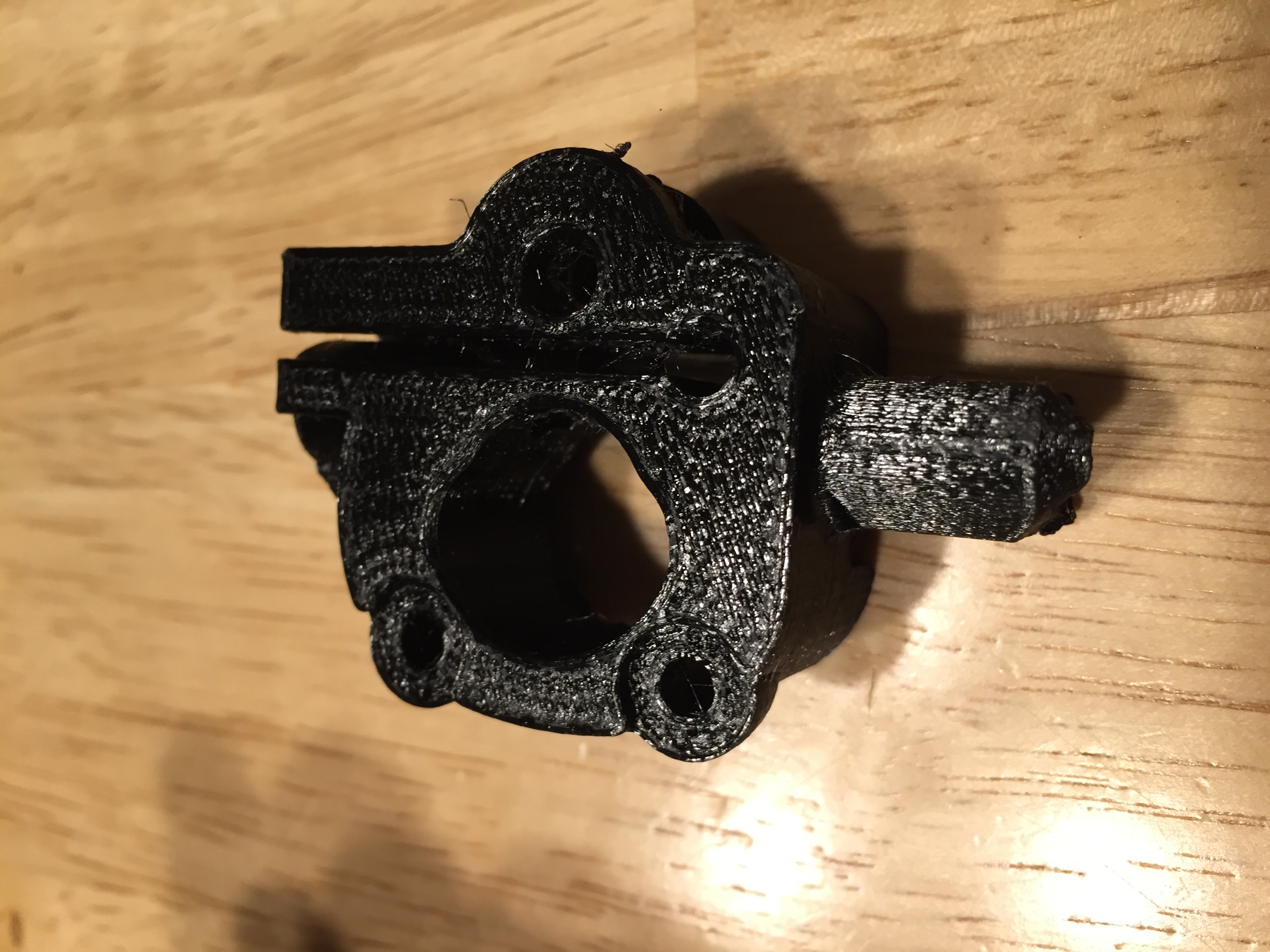

I think this came out pretty clean:

willnewton wrote:... Oooo, I missed that pic. Yeah, that is Not what you want to see. Jules' prints are much more in line with what you want to produce. I wish mine looked that good!
I'll bet yours do too look that good! :lol: (And I'm not at all sure about the problem area on the pic, it might be fine, it just looks a little loose right at that spot. :roll: )
