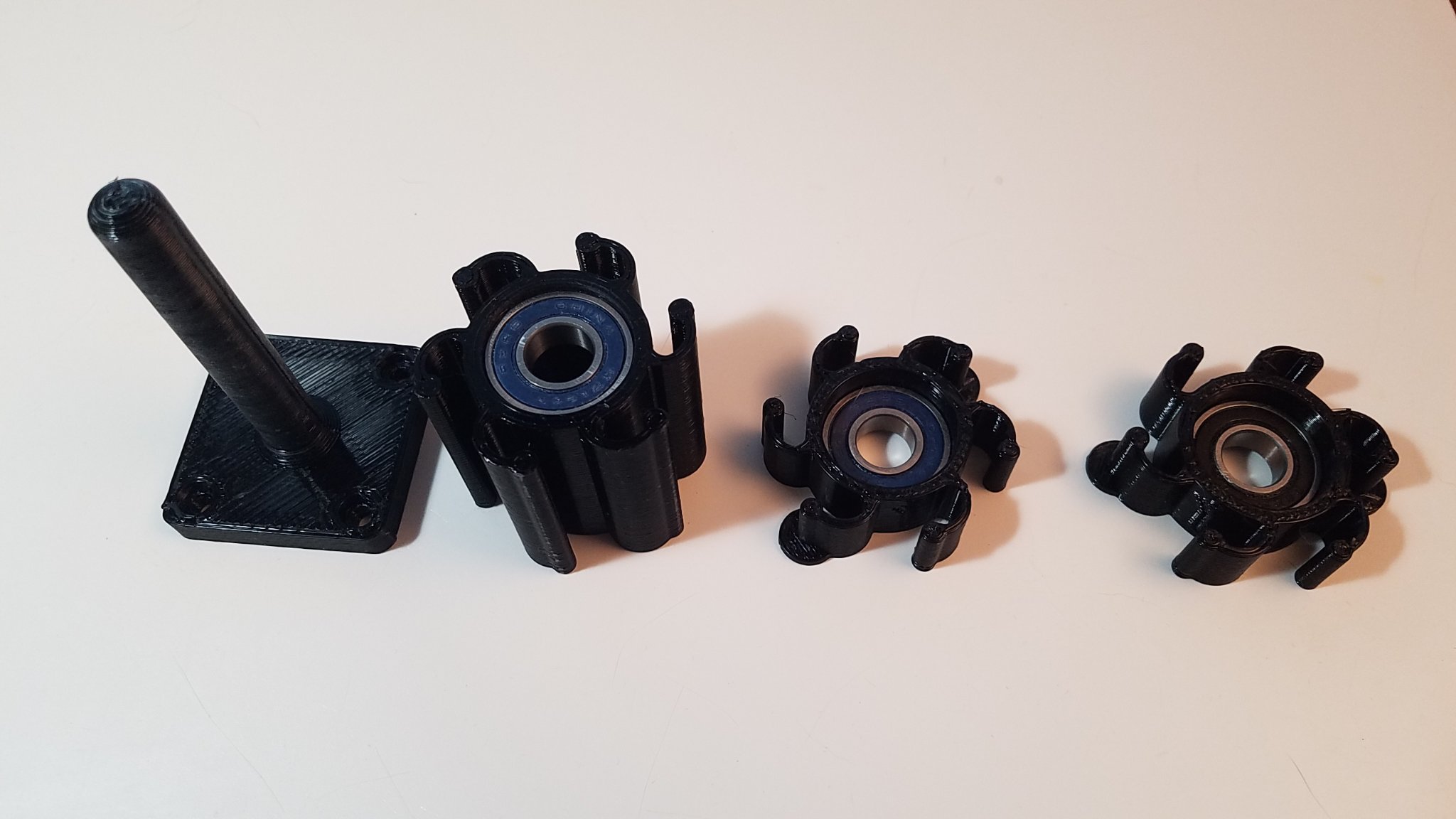

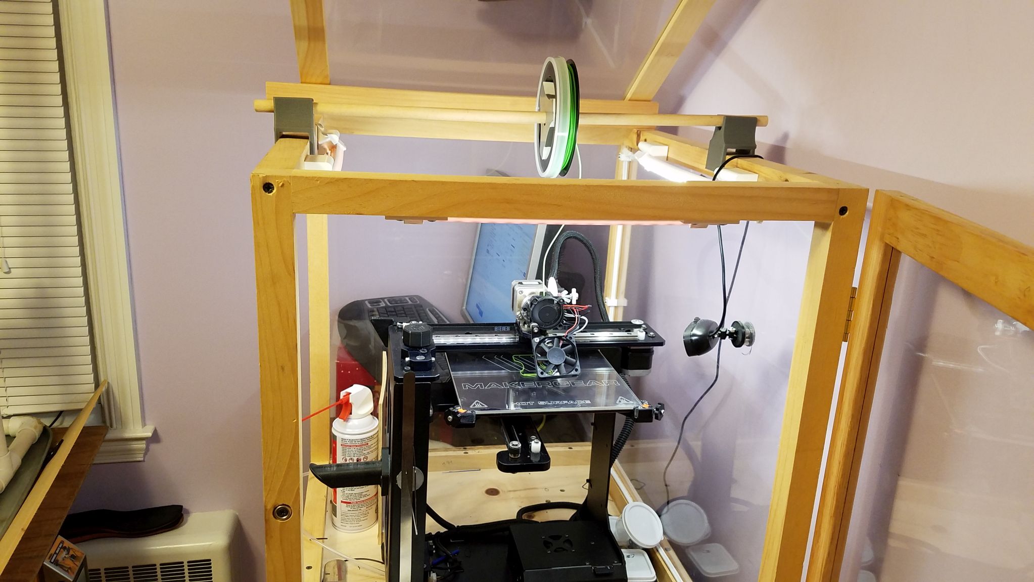

Gravity feed.. have inserts for the larger spools with bearing to allow very easy movement of the spool

I also have made a different spool holder that uses bearing. These parts were all designed for and printed with a .75 nozzle so not sure how well they will work with a .5 or .35 Since I use a .8 Extrusions width with the .75 and designed to that a.35 may with an EW of .4 would probably be best if the .75 is not available. I used PETG for all. The end cap is printed 2 times for spools that are very wide or have open spaces in the center.
These are the bearing I used https://www.ebay.com/itm/141791621106 If you can not do a gravity feed the bearing setup will help a lot.
