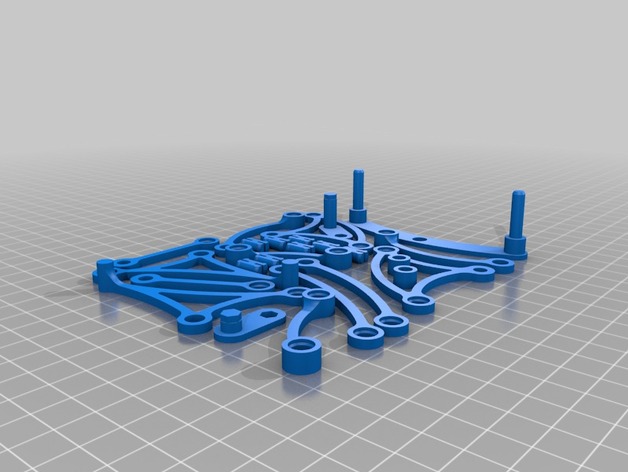

There have been more than a few prints that had many small parts that I wanted:
A) to print in one job for less intervention time
B) improve small parts quality.
On the V3b, there was about 5mm more clearance in the z-direction which enabled me to take care of a lot of small parts projects, the V4 however is just too short on the clearance.
Here is an example of where sequential printing would be favored:
http://www.thingiverse.com/thing:48087
Re: Maximum Clearance Height for latest MakerGear M2 in S3d
That print looks like it can be done just fine. Not sure how tall your shorter objects are ? Put the three tallest objects up front and set the order they print in so the plate prints forward objects last.
