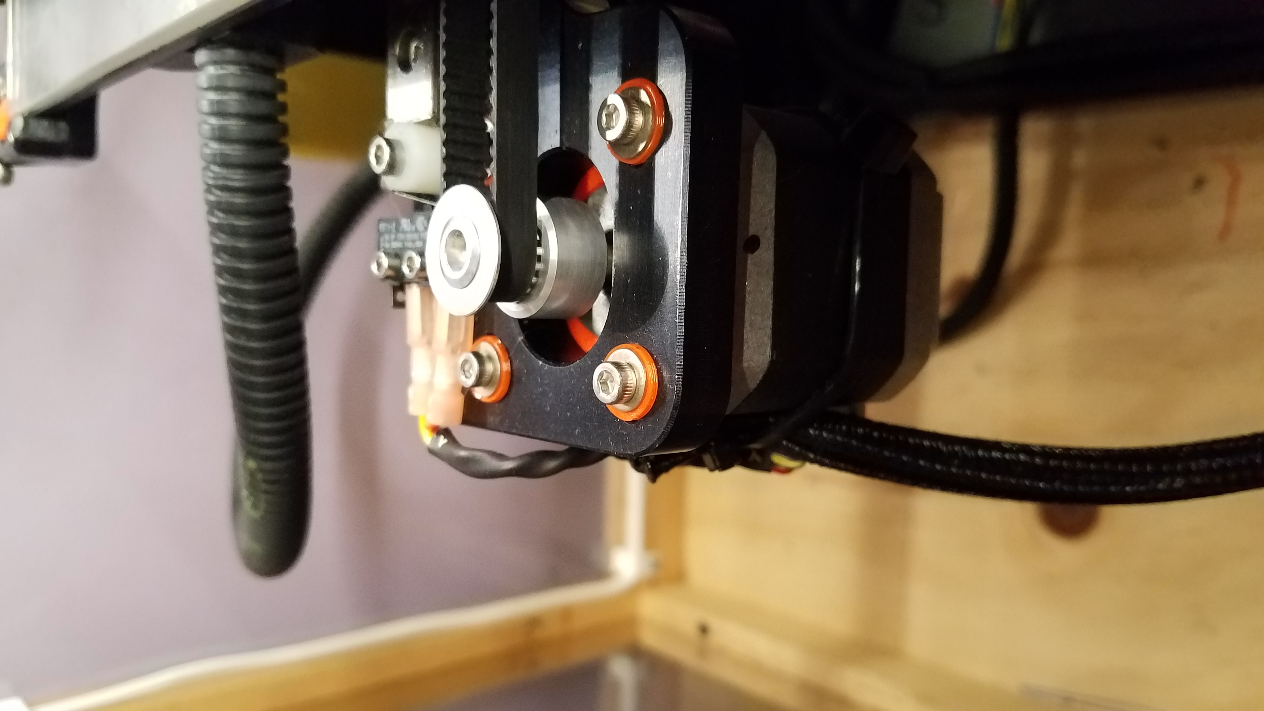

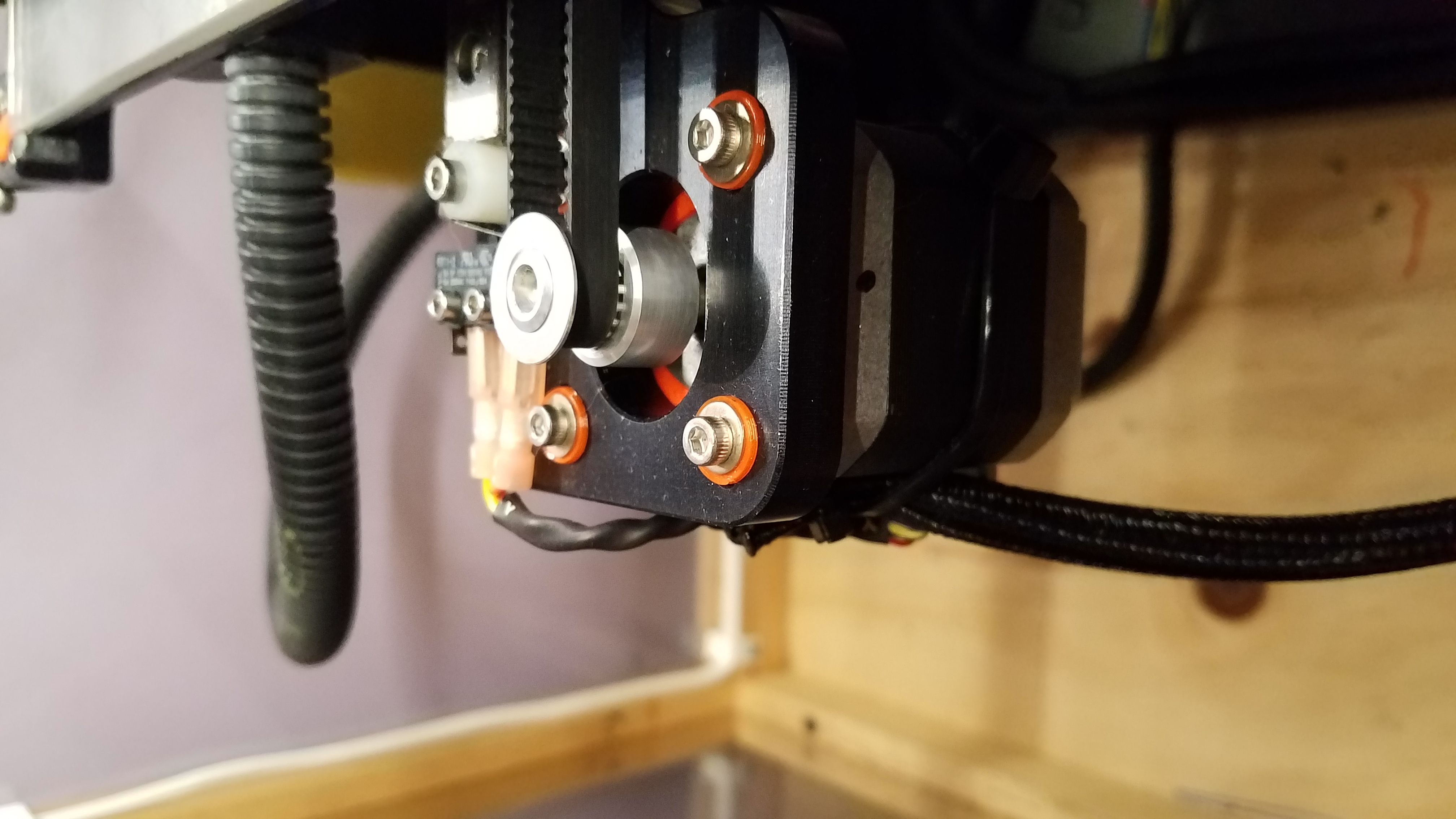

If you are talking about the rubber damper sandwiched in metal, that attach to the motor with 2 screws and the frame with 2 screws, I would not suggest it. The motor will cock to one side even with shims. I made Ninjaflex dampers and screw head isolation washers that quiet the machine just as much and the shaft is still perpendicular. You will need longer motor mount screws and with either type you have to adjust the pulley height so make sure you have a 1mm Allen wrench. My experience is with the M2 but I believe the motors and mounts are the same.
Attached are he damper and washer STL
I would highly suggest you find a good model that is used to show ghosting and print it before you install the mounts. I believe ghosting is worse with the dampers but I did not do an A-B test. I do know I see it some part but would rather have the quiet operation as I am not doing production work.
