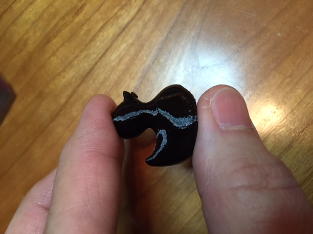

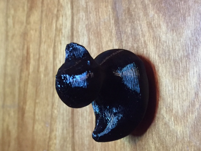

Post by scampa123 » Tue Mar 01, 2016 11:30 pm
Okay I printed the ducks in the black PETG...I'm not sure why I keep printing ducks as a calibration test but I do!
This one is a bit smaller since I couldn't remember how I resized the original for the others!
Checkout the layers...do they need to be squashed more? If so, what settings affect that? Extrusion multiplier??
Thanks!!
