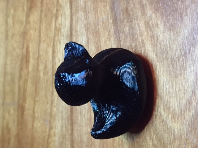

Okay I printed the ducks in the black PETG...I'm not sure why I keep printing ducks as a calibration test but I do!
This one is a bit smaller since I couldn't remember how I resized the original for the others!
Checkout the layers...do they need to be squashed more? If so, what settings affect that? Extrusion multiplier??

So this must be obvious, but I have to ask. Is your actual nozzle diameter 0.35, or is it 0.4 and your setting it to 0.35?Jules wrote: Overview:
Nozzle Diameter: 0.35 mm
Extrusion Multiplier: Calibration result - 0.01; (0.81-0.01=0.80) for my printer
Extrusion Width: 0.45 mm Manual
The actual inside diameter of the nozzle is 0.35 mm.
