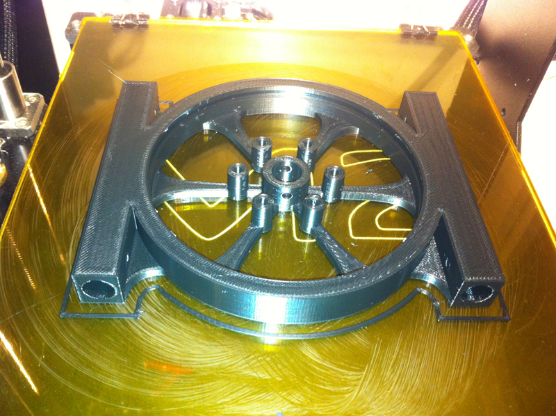

I'd say that's a pretty good system you have there with the thicker film and the lower bed temp. Lowering the bed temp seems to be the key to getting the part off, and has the benefit of shorter warm up and cool down times too. I printed the part below on a virgin sheet with the bed set at 70c and was able to get it off without too much trouble. It didn't pop off on it's own like gluestick does, but I could knock it off the plate without having to pry at it. This is a part that warps when using hairspray, so it's a good warp test.

This setup is definitely the way to go. I've done many prints now and still on my first sheet of 2 mil film with no damage to it yet and no prints getting stuck. Running the bed at 70 is the key to getting the parts off. I reapply a fresh coat of ABS juice for every print rather than trying to play guessing games with if there's enough left over from the previous print to hold the next print. It only takes a small amount and applying it is so much faster and easier than hair spray and glue stick that it only takes a few seconds.
