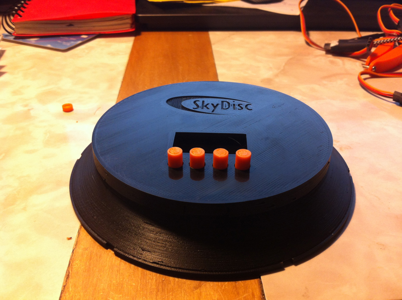

I finally did manage to put a small ding in my 5 mil kapton today. I was trying to get a worst-case part off the bed by prying it with the 2.5mm hex driver that comes with the M2, which I thought would be safe since it has a rounded tip. The two piece electronics enclosure for my flying saucer project seen below has a 135mm diameter bottom half with a 100% contact area, which makes it a real pain to get off the bed. Luckily it has some tiny notches around the bottom where wires pass through, giving it a hook point for prying it of the bed. You just have to use the right tool to keep from damaging the kapton, and the hex driver turns out to not be the right tool. Once you get an edge pried up it comes off pretty easy, but it's getting that first edge started that is the trick on such a large diameter, round footprint like that. I've never had problems with any other parts, only this one.
